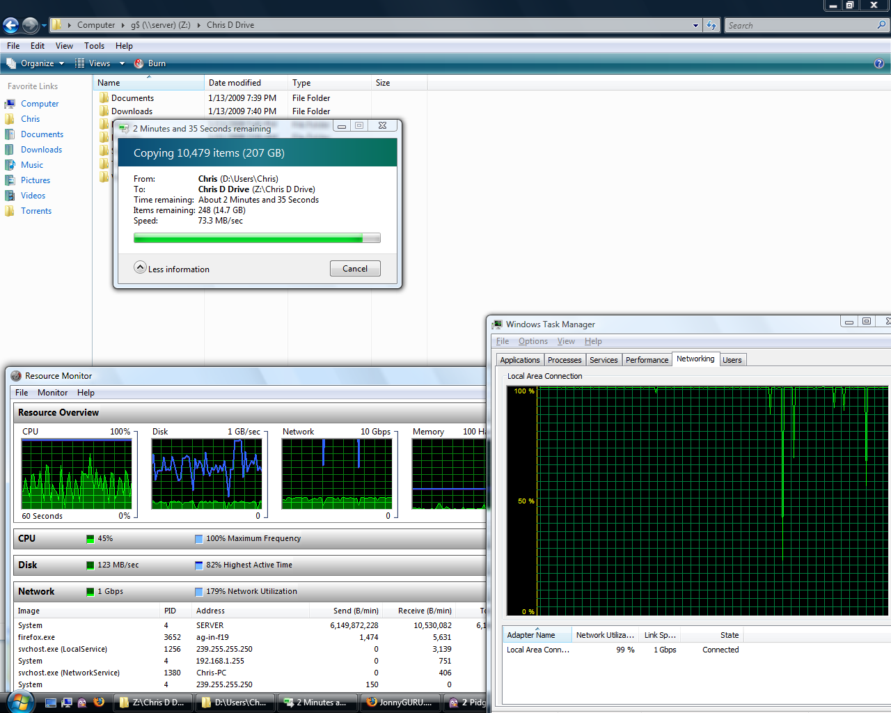

100% on a 1Gbps?
Not happening
by the time you hit 80%. That switch (regardless if it is a home gig-e switch or enterprise level gig-e switch) will be huffing and puffing.
Nonsense. Of course you can't hit 100%, but you can get close enough even with consumer gear to call it essentially "wire speed".
F:\tools\bench\iperf>iperf -c 192.168.0.105 -l 64k -t 15 -i 3 -r
Server listening on TCP port 5001
TCP window size: 8.00 KByte (default)
Client connecting to 192.168.0.105, TCP port 5001
[796] local 192.168.0.147 port 27083 connected with 192.168.0.105 port 5001
[ ID] Interval Transfer Bandwidth
[796] 0.0- 3.0 sec 348 MBytes 972 Mbits/sec
[796] 3.0- 6.0 sec 346 MBytes 967 Mbits/sec
[796] 6.0- 9.0 sec 345 MBytes 964 Mbits/sec
[796] 9.0-12.0 sec 347 MBytes 970 Mbits/sec
[796] 12.0-15.0 sec 347 MBytes 970 Mbits/sec
[796] 0.0-15.0 sec 1.69 GBytes 968 Mbits/sec
[840] local 192.168.0.147 port 5001 connected with 192.168.0.105 port 1679
[840] 0.0- 3.0 sec 354 MBytes 991 Mbits/sec
[840] 3.0- 6.0 sec 353 MBytes 987 Mbits/sec
[840] 6.0- 9.0 sec 353 MBytes 987 Mbits/sec
[840] 9.0-12.0 sec 353 MBytes 987 Mbits/sec
[840] 0.0-15.0 sec 1.72 GBytes 987 Mbits/sec
