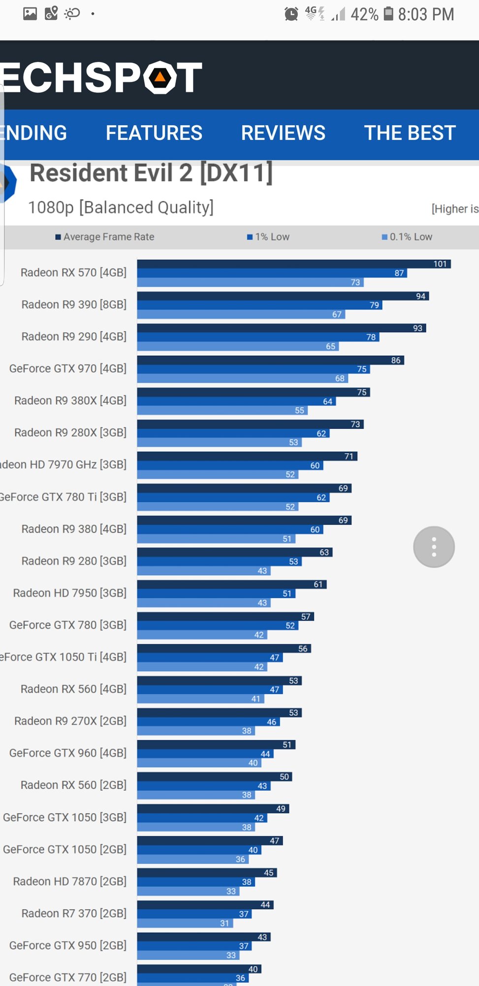

Hardware Unboxed just did a test of Metro: Exodus, which is one of the most demanding titles to date, ignoring a bunch of gay texture modded games.
The Fury X did not take a vram performance hit, even at 4k ultra, despite it only having the gpu power to play 1080p ultra.
Even the 3 GB GTX 1060 did not get affected until 1440p ultra. It only managed 43 fps at 1080p ultra, so a higher setting/resolution is pointless anyhow.
Going further back and using 1080p Medium, the GTX 780 3 GB only managed 41 fps while the 2 GB GTX 1050 managed to get 43 fps with good minimums. So, you can be almost certain that the RTX 2060 will be fine 7-8 years from now with 6 GB as you will most likely need to play at medium settings anyhow.
So it is a good bet that if a game needs more than 8 GB years from now, it will be fine with 4 GB with balanced settings.
