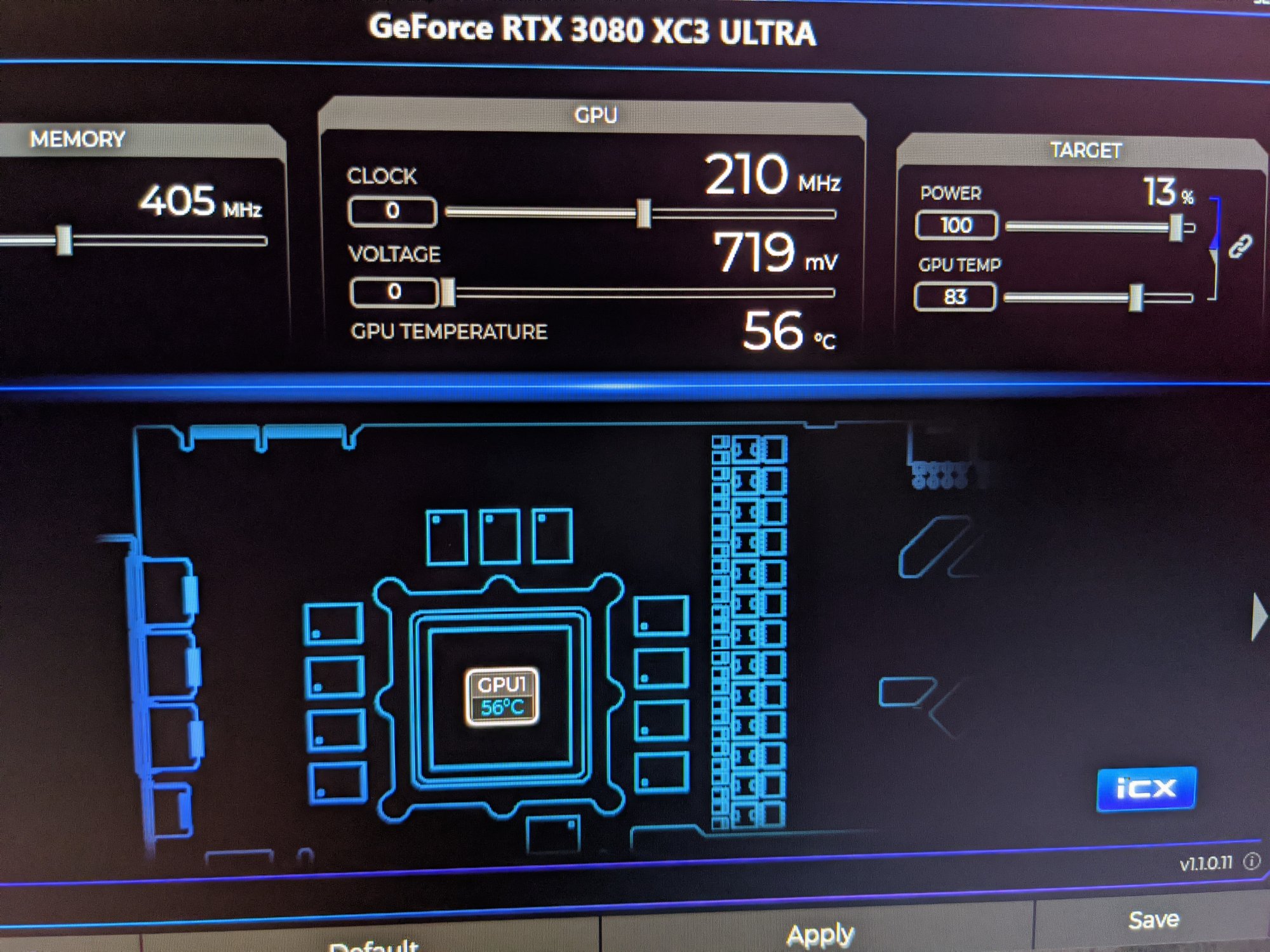

I just installed the eVga Precision X1 program.
It immediately did a firmware update. Here's pic just in idle in desktop mode;
Seems normal, now just run a game in the background and switch to the temps.

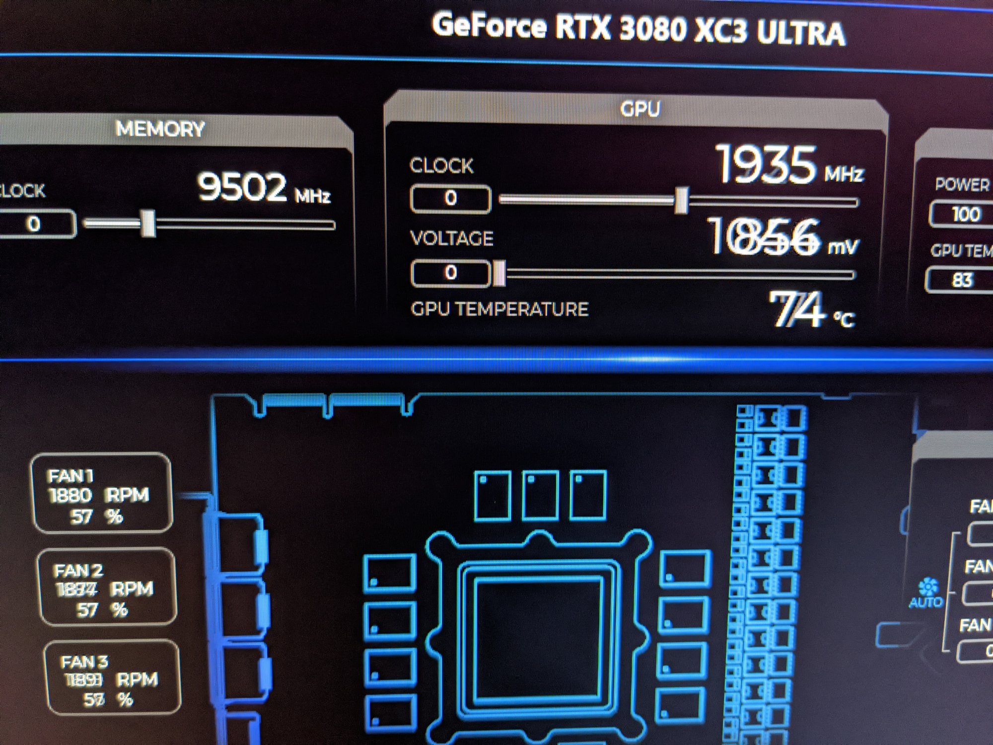

Here's me playing WoW and temps now;

Ok, sorry to tell you that those numbers are just fine. The card is dumping the heat into your case and in the process heating up your side panel. Even if you swap cases those numbers will stay similar but you may possibly have a cooler side panel, most likely not. These cards all will do what you are seeing at least some worse but still all within Nvidia's expectations.

Those temps are totally fine and your fan speeds pictured are not even hitting 50%. Wow is probably not a great game for a worst case scenario since it is probably not pushing your card to hard, but you have a lot of left over temp and fan speed room to play with. Don't worry too much about your idle temps because these cards are made to turn their fans off when idle or low temp. If you don't like the idle temps you can setup a custom fan curve to keep a lower threshold.

That temp looks fine. Driver limit before throttle is 82C in X1 so under that is good. I was being anal when I was trying to keep it under 75C.
