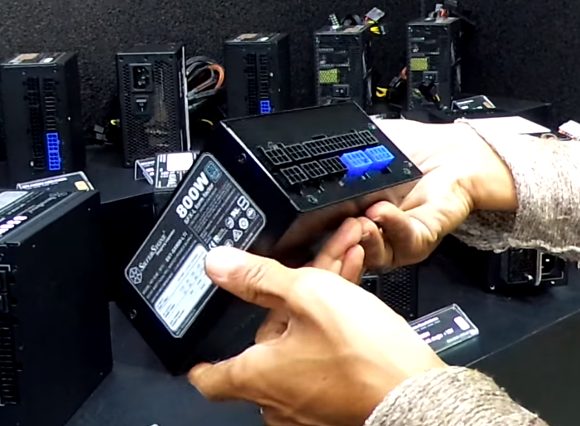

Still waiting for the SX700-LPT? Guess what...
In theory it's gonna be released in Q4 2016... Yeah right...
SFX-L, 120mm fan, 800W and titanium efficiency...
What do you think guys?
