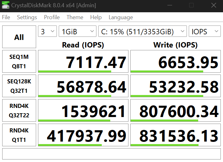

Hey guys. I bought a 4 TB 990 pro from microcenter for 279$ (now 249$ getting a refund for the difference tomorrow). I got it home and installed the latest version of win 11. Everything is updated. Bios, Win 11 updates, mobo drivers, samsung magician software, latest ssd firmware. The system is tight. The Samsung magician software is in full performance mode and also I am running it in 4x4 gen4 speeds and verified it. The m2 slot I am using is capable of gen5 speeds. I am running a 7900x and a asus x670-p wifi board.
The Q32T22 random and seq looks to be half. I even upped the cpu threads from 16 to 22 to get better results.
I ran crystaldiskmark for the ssd benchmark. I ran the test in peak performance and NVME mode. Now I do have my os on here when testing but I am getting less than half the random write IOPS as advertised. Random reads seem ok. Is this normal? Thinking a firmware update might be in order from samsung. I know the 990pro was having issues. Wondering if samsung still needs to work on their firmware. The following numbers are from samsungs page for the specs of the 990 pro. I have attached my pic of crystaldiskmark. It looks like the write speed on my 4tb drive is half what is should be. Looking at the benchmark from here:

Yeah for some reason, the random writes q32t22 are half what they should be right now on my drive. The random reads are ok though. Maybe a firmware update will fix it.

Did you remember to enable NVME mode in Crystal Disk Mark?
Yup. Also ran cdm at default and peak performance settings. I even increased the cpu thread count to 22 on my 7900x to get more oomph in the test. For some reason random writes are half what is should be. Everything else looks fine though.
Is there any other processes using disk activity in the background?
WinDefender and bitlocker (if enabled) will slow things down. I recommend leaving them off (getting rid of defender permanently!) and turning off system restore as well.
Seems like we need a better nvme driver for 11.
No nothing. I disabled ms defender and also bitlocker is not on. I have disabled system restore. Still the random write iops won't get above 900k. Last test was 875k..nowhere near the 1,550,000 rated. My random reads are good though.

As far as random writes have you tried other programs such as AS-SSD and Anvil?

Yeah i have tried samsung magician benchmark and cdm but no others. CDM is valid and is pretty trustworthy. I just think this is a firmware thing on my drive OR it being the fact that my windows install is on it is slowing the random writes. Maybe if it were my D drive I could get the correct write speed. Dude 4tb T700 is 500$....that is way to rich for my blood. I will enjoy this drive for now and when I hit the lottery I'll get the T700.
