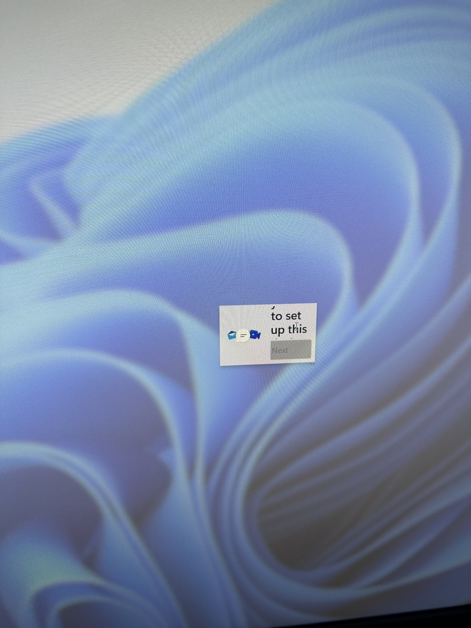

Man having horrible issues installing windows. Stuck at the damn connect to network screen and it doesn’t show anything. Neither Ethernet which I have connected or wireless. I hit shift f10 to do the bypass and after that point my keyboard won’t work anymore when the dos pop up comes up. My wireless mouse doesn’t work either. Idk what’s up with these USB ports on the board. After I replaced the brand new blown power supply it boots fine updated to latest bios with flash back. At this point about to warp it up and send everything back over the next 30 days.
Funny I can use my keyboard all the way through. Ethernet has green light. Nothing wireless seems to work on the. keyboard and mouse side. Weird enough bios does see all the usb devices connected. Flash drive with os, says I have one mouse connected and one keyboard.
Had to use my wired keyboard to even get in the bios.
Update. So my laptop wireless mouse works lmao. Seems like Logitech lightning receivers have issues.
But still no network during windows 11 install and can’t bypass it cuz my computer. Keyboard stops working here. When I try to bypass it.
You could look for legacy usb settings in the bios.
Maybe try Windows 10 and install all the drivers, then update to windows 11.

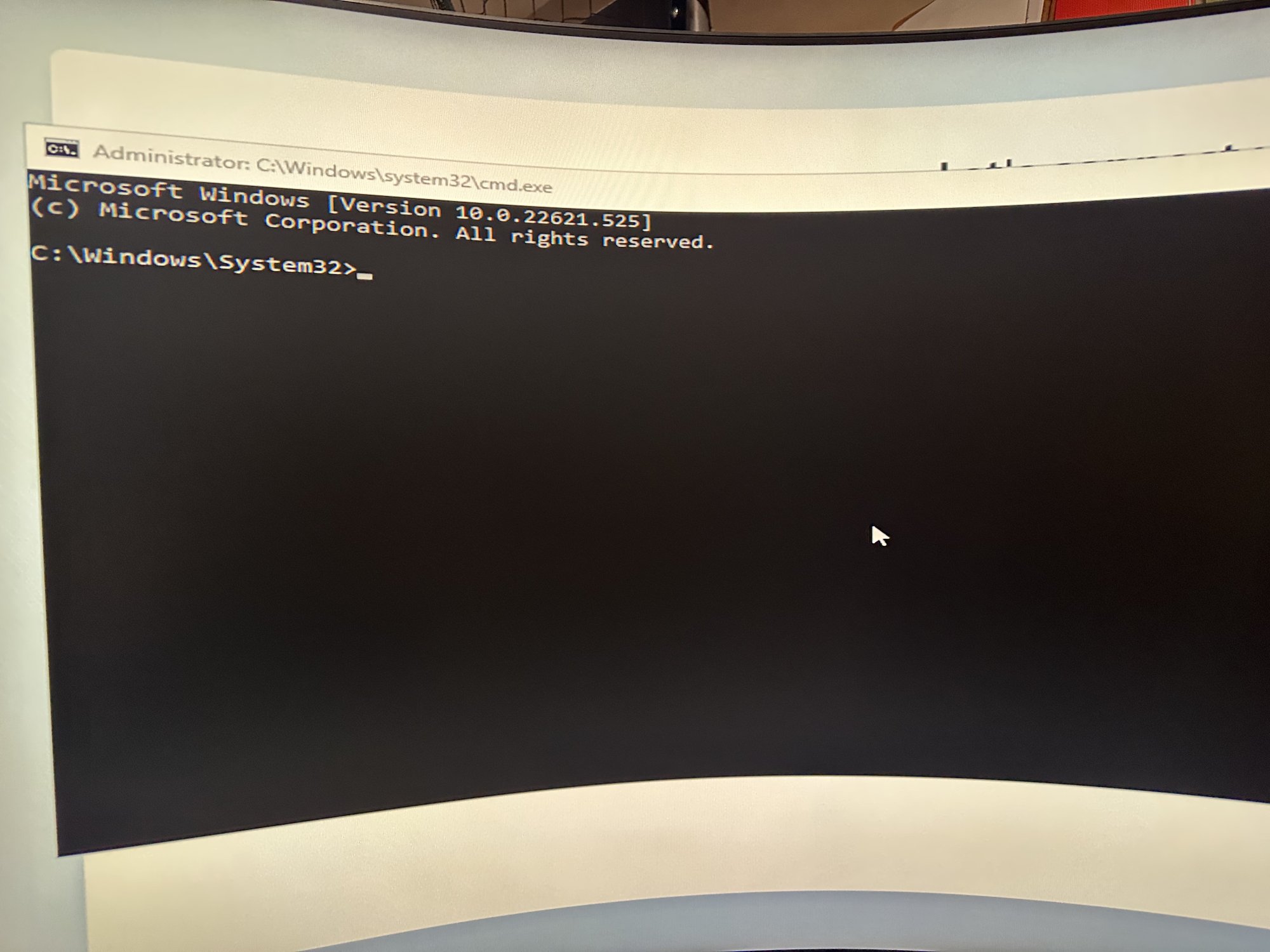

Lmao I got through. It might have been my Ethernet connection. What’s stupid is the damn resolution on windows 11. it’s doing some weird dpi upscale. Look at this setup. Lmao how am I suppose to select. 🤣🤣🤣 how would you like to setup your OC. Big ass letters. 🤣🤣 I am gonna redo the install on another Monitor. I have ark55 I think it was tripping on scaling. Going to connect it to my 27 inch I have spare and redo the install. 🤣
Oh and found out to bypass my dumb ass had to click inside of the dos window to type. Forgot about that lol.
