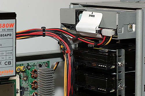

The PSU is a 680W Thermaltake

Ub312g0d654 said:That is one of the cleanest power cabling jobs I've ever seen. Kind of odd when you consider how many drives are in the beast to. Great job on the power bus. like wow.
