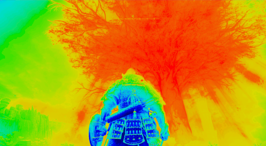

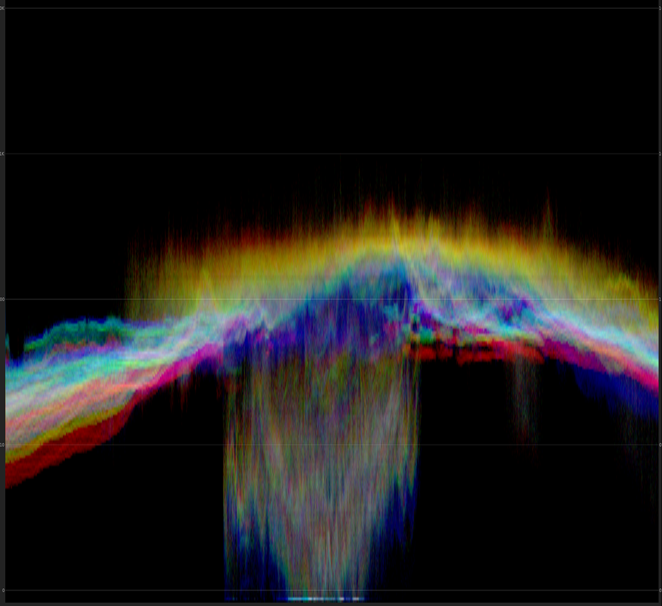

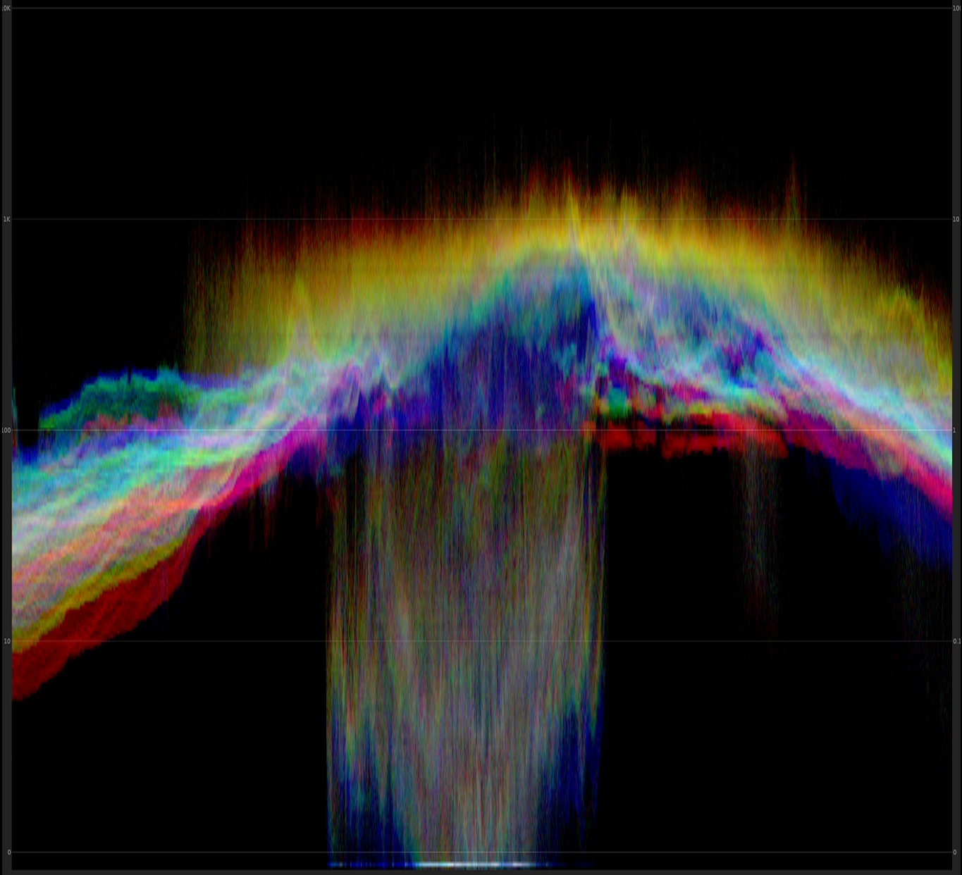

You don't even know how contrast work in the very first place. Of course I'm going to raise the contrast between 80nits to 160nits of your "mid-tone". How dim these mid-tone looks like in an open area.
You pick point A and point B in the Elden Ring image. I can show you exactly how many nits that point has. Then the brightness difference between A and B is always higher after mapping algorithm. This is how contrast work.
Go pick them. I cannot wait for you to tell me the contrast is lower.
Also, the black is blacker under 10nits. They have even larger contrast. Your definition of 10+nits higher "blackness" is very funny.
Your 80nits-160nits "mid-tone" needs to be changed to look more natural and impressive. I know you want to keep it so your OLED can see it without so much ABL. I won't grade Elden Ring for OLED. I grade what looks better.

Funny it's you who hallucinates all the time. I do the metaethical mapping
I tell you to check the RGB waveforms or pick any points to compare the contrast. You cannot even dare to do this.
Higher contrast is simply higher contrast. Don't deny it. 10nits and below is even lowered. It has even more contrast lol.
Your claim of "reference" mids, or 10+nits "darkness" maybe works for OLED. It doesn't look better on HDR 1400 monitors. I make it look better. The mids of HDR1400 are 500-700nits or above, especially in a daylight scene. That's where the mids are supposed to be.

Lift is a lift. You turned the whole orange, yellow and red heatmapped erdtree into ~1000nit and lifted the whole green area on the right from a more meaningful depth. Those areas are not as dark in absolute value nor in comparison to whatever peak brightness areas are displayed anymore. Simple as that. I think it would look better with the "darker" mids maintained and the peak 25% of the screen raised alongside of them. It's fine if you prefer it the way you did it. There are a lot of ways you can change they way HDR games and screens look.
kramnelis
Jun 30, 2022
298
Lift is a lift. You turned the whole orange, yellow and red heatmapped erdtree into ~1000nit and lifted the whole green area on the right from a more meaningful depth. Those areas are not as dark in comparison to whatever peak brightness areas are displayed anymore. Simple as that. I think it would look better with the "darker" mids maintained and the peak 25% of the screen raised alongside of them. It's fine if you prefer it the way you did it. There are a lot of ways you can change they way HDR games and screens look.
LoL. Your attempt is hilarious. So you are actually comparing the pixel A /pixel A+ lol. instead of B/A vs B+/A+. Is that how contrast work for you?

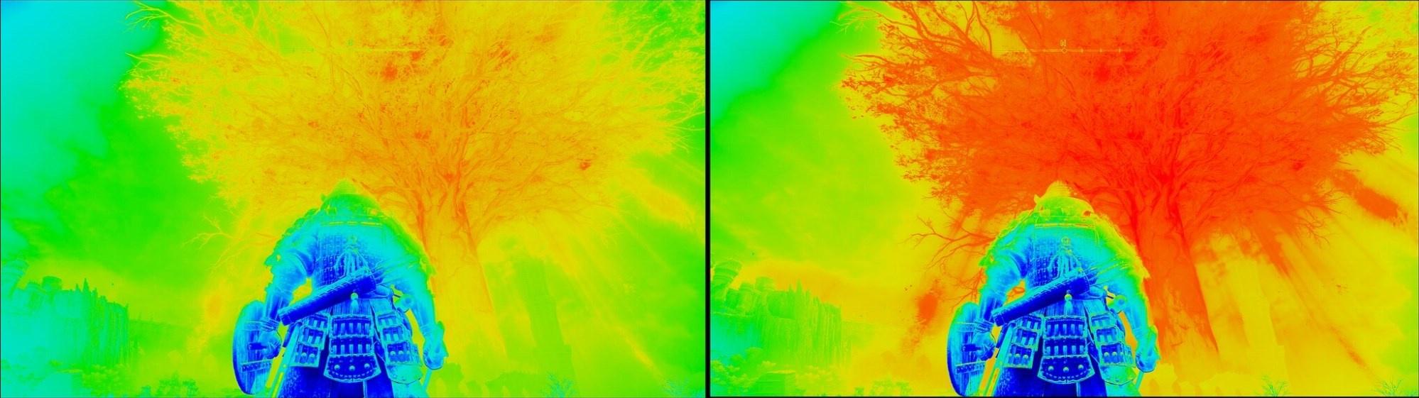

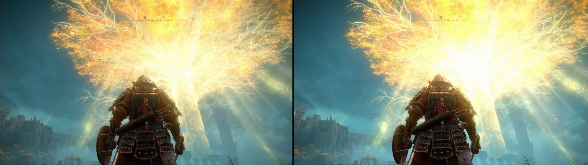

kramnelis
Jun 30, 2022
298
I cannot wait for people to say the images look way more detailed on the left. The left looks so much more in depths. The left must have way more contrast than contrast lol.

elvn
May 5, 2006
4,668
That one is better for sure.(y) There are a lot of ways to adjust HDR games and screens to your liking so things can vary quite a bit.
This was the first one that normalized and flattened the tree and blew out the darker tower area in the backround under the right side of the tree boughs. The bumps and detail on his helmet etc all got lifted and absorbed too, etc. :
This is your latest one that preserves a lot more of the darker details:

kramnelis
Jun 30, 2022
298

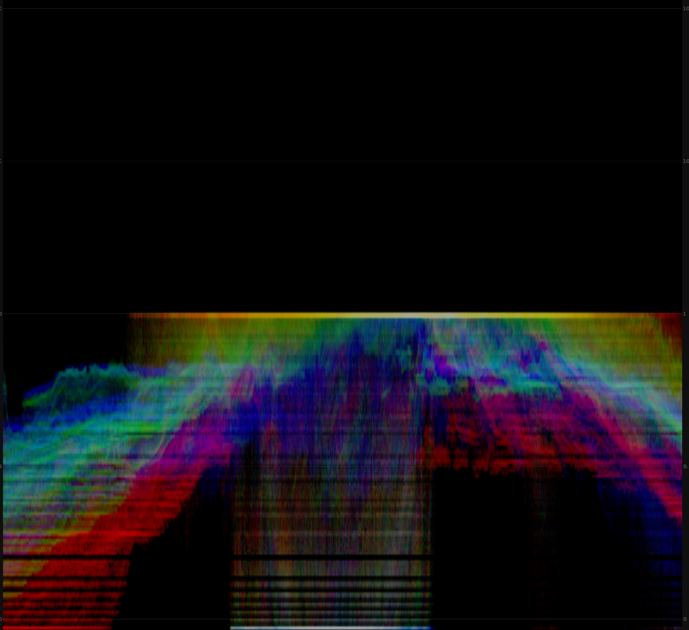

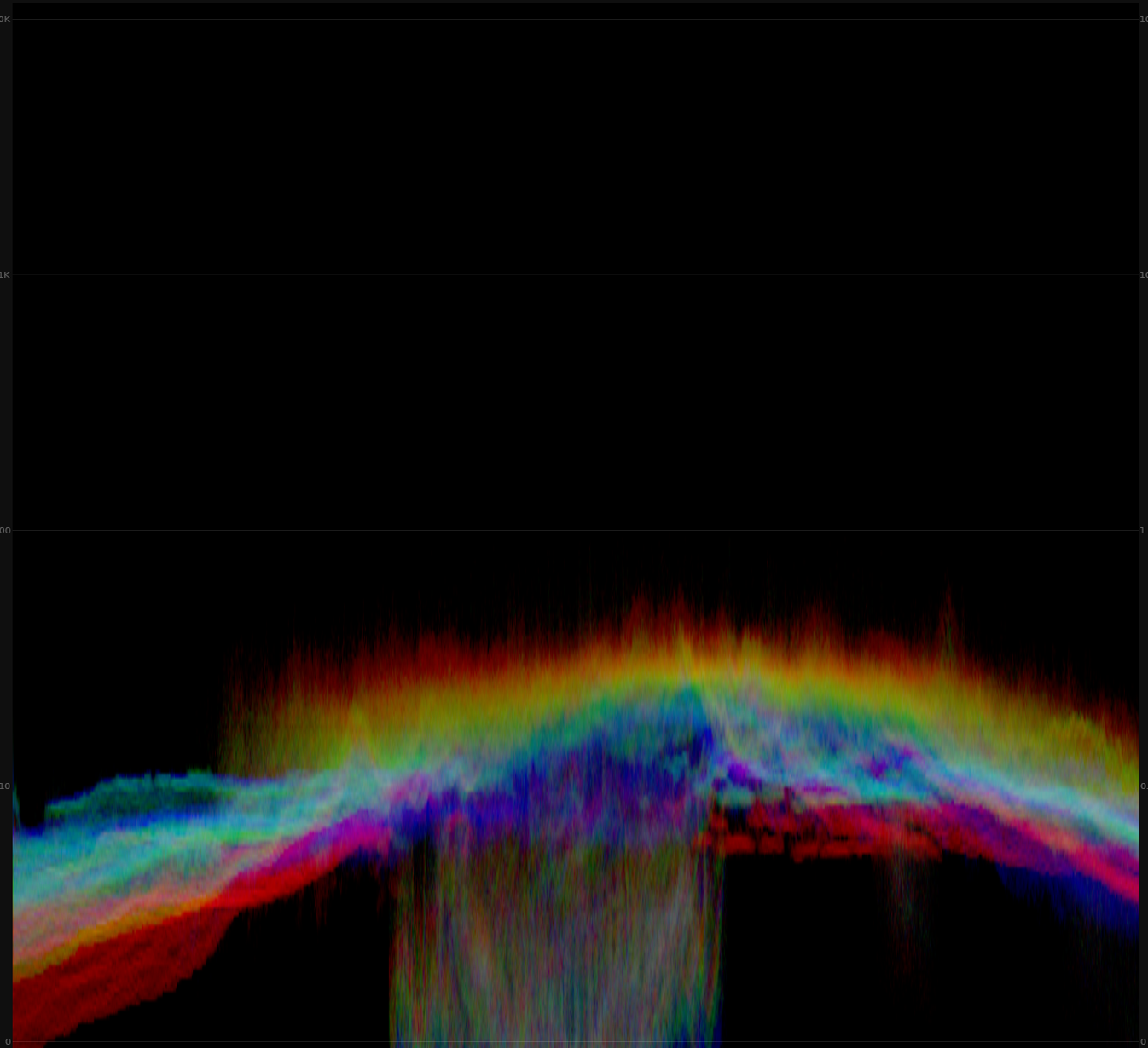

Funny you still compare SDR pictures instead of using heatmaps and such. It only looks better on SDR. The contrast is higher in HDR with even more depth. HDR looks a lot better than the left. There is a lot way to adjust HDR. I care about which one looks better lol.
As I always said OLED shills can only see SDR. But whatever their SDR images don't even look good when tone mapped down or don't do proper tone mapping at all. It's very manipulative of you to do that while my SDR pictures generate along side with HDR images with proper tone mapping.
It's too obvious anyone with actual HDR 1000 monitors and above knows which is better.
Let's see what's more you can do.

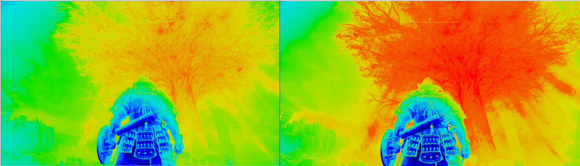

elvn
May 5, 2006
4,668
Don't misunderstand. I'm not saying the left version is better. I was saying the new version (of the right side image) is better looking, in both the heat map and the regular pic, than the original right side image you posted earlier in the thread. It's a much better result than the first time imo. (y)
First version from earlier in the thread (focusing on the right side panel):
2nd version (focusing on the right side panel).

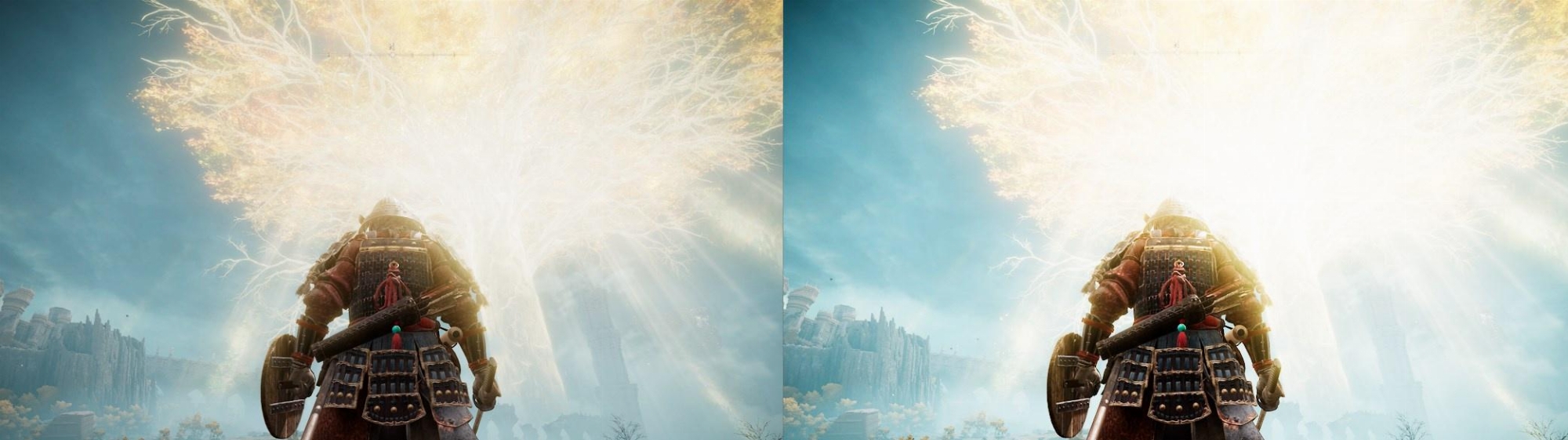

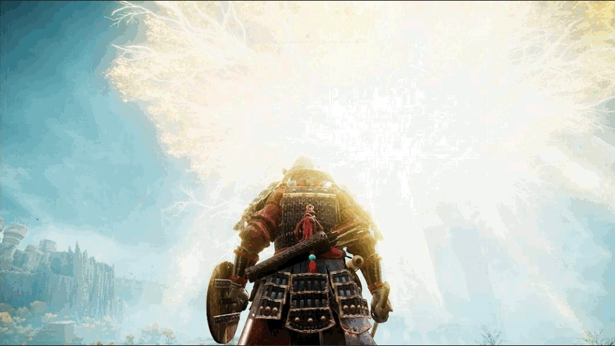

elvn
May 5, 2006
4,668
Perhaps something got lost in translation somehow between the actual screenshotted images. 🤔 The brightness (of the screenshot image itself) is different between the first set of pics and the 2nd set of pics. The 2nd set (the screenshot image itself) is darker than the 1st set overall.
Both layers in the gifs below are the "after shots". There are no left panel "before" shots in any of the images below in this reply.
bright/exposed one is the 1st version. Some major artifacting/loss/banding from conversion to gif format obviously. . making them look extremely blocky and uglier than originally, more blown out than in the original screenshots - but still gives an idea the difference between the brightness of the actual image of the 1st "after" and 2nd "after" screen shots. Can always refer back to the original non-gif version in the prev. posts.
The first posted "after" pic of the heat maps is the layer below that looks flatter, that is without the isolated darker (actual heat map representative color gradient wise, not darker in the actual scene) hard red lines of detail in the tree, as well as without things like the darker ribbed detail on the pillar on the right (which shows up if you look closely in the 2nd pic).
If the screenshots were exactly the same, there would be no change in the gif between the two layers. Maybe the exposure was bad in the first set of screenshots or something. I find the second versions look a lot better and more like what I'd like to see in game. More ("darker") mids are preserved, even if alongside brighter highs.

elvn
May 5, 2006
4,668
Funny you still compare the 1st SDR picture you generated. Do you want to derail the topic even further about how website handles larger pictures and how you generate the SDR pictures you made yourself instead of mine?
Those are for reference. You can refer to the originals like I said, the first of which were a 24mb download I believe, and the 2nd set in one of your more recent replies.
The differences between the two sets of "after" screen shots, even in your original posts, is there for whatever reason. If it looks more like the 2nd pics and maps in actual gameplay, that would look better to me. There are a lot of ways to modify how hdr looks in games and screens after the fact though anyway.
kramnelis
Jun 30, 2022
298
Funny the images of your super overexposure SDR from whatever tone mapping method you use is more authentic than mine. And you want to pick holes in them to fulfill your narratives without understanding it's meaningless to compare contrast on SDR images .
My SDR generates directly from the actual original raw data the same time HDR is generated lol.

In terms of the capability of an HDR monitor, it's always better when the monitor is able to display a higher range with both higher contrast and higher color volume.
From the RGB waveform, it's obvious the see the higher dynamic range from how stretched the wave is.
1.Higher contrast, high color volume
2.lower contrast, lower color volume
But most monitors cannot even display the second image accurately. Sometimes certain displays like OLED just look like the 3rd image or the 4th image.
3. even lower contrast, lower color volume.
4.hard clip, over blown.
