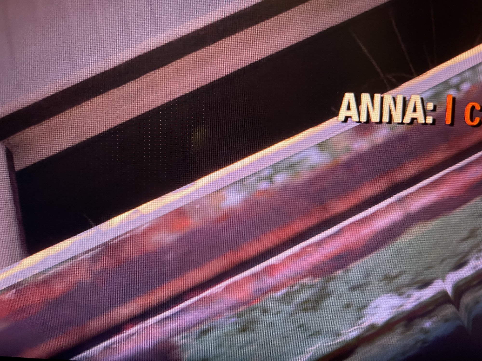

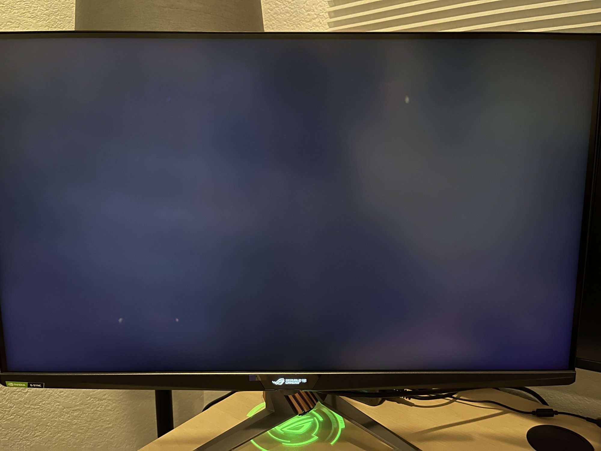

Like Waywardcitizen on page 12, my unit is beyond trashed.
Yellow backlighting defect where the light shows through brighter, surrounded my a faint red matrix type pattern. Most visible in HDR but also visible under SDR like in Metro Exodus below.
Over exposed to show the effect, but 3 separate instances over the panel along with a stuck blue sub pixel amongst the lower left blotch
No quality control what so ever. I mean why even bother fitting the panel to the monitor shell if it’s this bad and inconveniencing the customer.
I’m only so mad because of how good this monitor is otherwise.

Man.. really sorry to see your panel has the same issues that mine does. How frustrating to say the least. Mine is going back to micro center next week. I ordered another one from Amazon that should be here by Wednesday. If the 2nd one is defective not sure which route I’ll go. I’m assuming yours is going back to Newegg?
Thanks I appreciate it. Sorry yours didn't work out either but at least your replacement should be quick. Just a heads up I have heard people unboxing monitors to test (after paying) at MC so that could be an option if you ever find yourself in that situation again.
Newegg are out of stock so my only option is probably a refund. I ordered one from Amazon also but wont be here until later in the month / early next month.
