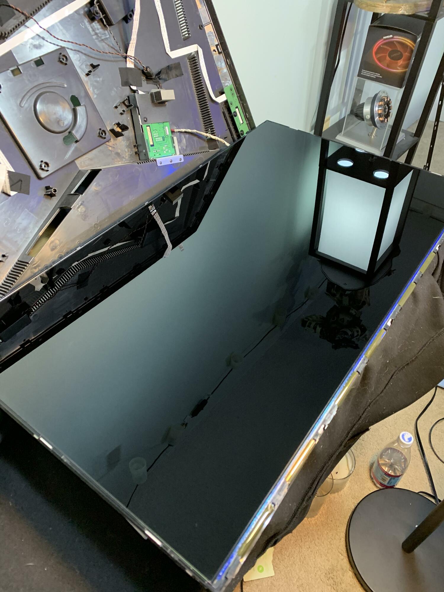

This is the current state of the monitor. So I scratched the screen and have always wanted to do this so gave me an excuse lol. For people who have done this on other monitors, the very top layer is just AG coating correct? I am worried about pulling off the polarized filter. Going to soak it for 5 hours with very wet but not soaked paper towels. Also worried about the edge of the monitor and exposure to wet paper towels. Any other tips? :)

Yeah I took it apart last night but it was almost 1AM when I took those pics haha. Yeah I am really hoping it turns out. I love glossy monitors so if this goes smoothly I will want to keep this monitor for a very long time since I have never seen a glossy 165hz 2k monitor lol. I will either do it tonight or Wednesday. Ill post pictures on how it comes out. I want to get the AG coating as wet as I can I am just worried about water seeping in the blue area and other areas. Any tips to keep the water on just the AG panel?

So it came out amazing! After soaking it for 8 hours the worry about it feeling impossible to come off instantly went away. NOTE if you plan on doing this to yours that bottom layer is not the polariser! I almost started peeling mine off till I noticed it! So start picking from the very top till the AG layer starts to separate. Tip number 2 do not stop moving. Every time I stopped it made a streak that I had to wipe away after. The monitor looks insane and came out so good. Super happy and thanks for everyone that helped! I wanted the new ROG 4k 144hz but I am so happy with how this came out ill be keeping my PG279 for a long time! :)

I did the same procedure to my ASUS ROG Swift PG279Q ..... It's phenomenal. I'm going to upload some photos.
I followed this guide, https://www.overclock.net/forum/44-...og-swift-pg278q-qr-removal-matte-coating.html. It is for the PG278, but the process of disassembling it is exactly identical to the PG279.
You have to have a lot of patience for this procedure. I let it stay for 8 hours with the wet paper on top of the AG. Then with my nail in one of the upper corners, I forced and began to lift the AG. At first it seemed like he was not going to get up, but we have to do some strength to get him up. Then I took it all in one go, without stopping.
Now the picture quality is outstanding. I know the screen now has no protection, but I'm thinking of buying this transparent screen protector. https://www.protectionfilms24.com/a...2068.647870750.1561855239-66521938.1561674125
