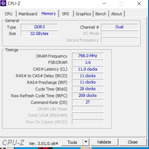

Just installed the 6380ES chips in my H8QGi-F tonight. Haven't really played with them much. Just set OCNG to the same settings for memory that i had with the 6328s. Temps stabilize at around 43C with psmax -1 set, with Cinebench R20. The 6328s would top out at around 27C. Ram bandwidth with RightMark Multi thread ram benchmark is down to 32 GB/s from 37 GB/s with the 6328s, but i've not upped the ref clock yet.

Perhaps i should not be amazed by this, but to properly overclock this, i am having to *reduce* voltages. refclock of 210 would not work when running rightmark multi thread benchmark saturating all memory cores. The memory was not the problem, but i noticed when i reduced the CPU-NB voltage adjustment to +0.0 (in turionpowercontrol) that stability improved. Thinking it was the temps, i then reduced the voltage on p-state pb1 - it is the all core turbo that runs when RMMT is working the memory controllers over. This reduced the temps. It seems that once temps hit 33.8C it would give up the ghost. Things stabilized again when i reduced voltage from 1.1500v to 1.0750v which reduced temps by about 1.5C. i wonder how much extra voltage the factory added for the stock p-states over what was necessary.
