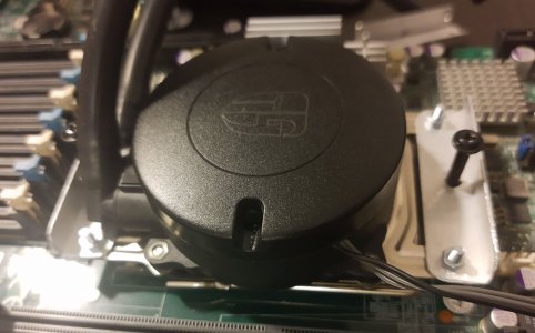

I am using at this time in my side ridiculous cheap cooling system yet, like 3 euro Arctic 64 AM4 aluminium coolers adapted for G34, just to do the job, because I did not decided yet what cooling coolers and method to use. I am not satisifed at all with what I found on the market these days, wherever expensive or not, and I am working to implement a custom water cooling method for all 4 CPU based DeepCool Maelstrom water. I already got 4 of it, latest on market here, for older model ( see down below picture) as these will cover an G34 Opteron processor size, and for which I have made an adapter to G34 to keep on place. These are cooling indeed very very good in my tests in comparison with an aircooler( I have a Noctua air cooler too and use to test on different AMD processors) , but I want to implement a custom solution with a much bigger liquid recipient and cooler connected in series. I am still working on that, but all my tests show that indeed watercooling with such custom solution provide a higher level and stability for cooling. You may use such alternative for testing purpose if you have it around. If you are proficient, you can use any other liquid based radiator to check if overheating is indeed the problem.
What I got for overheating on this Supermicro motherboard is that when one of the CPU's reach 65 C, motherboard will beep long and stop working with no display, but fans still rotate. You have to hard restart it to work again. To get better signal for iminent overheat, you may activate Early Alert in BIOS for overheat and motherboard will give short beeps before overheat limitation is reached, while that will be early indeed and useful if heating is done not so fast. But then you will know that it is from overheating and not something with CPU chip itself.
By this way, it may be indeed the AMD CPU's based generations. Slight off topic, I used recently to have fun with an old AMD Athlon II X4 620e on an Asus motherboard that I have it. This is based clock 2,7 Ghz, but with OC it goes just easy to 3,4 Ghz with full stability. Checking in a game, performance was indeed increased. So nice almost 25% performance increased just like that from old times AMD chips. A Phenom X6 1100T will reboot at a frequency set above 3,9 Ghz in a stress test. At least that is what I've got on it. As I can't overclock with default Supermicro BIOS an 6386 SE, I can state the fact, but perhaps someone who already did it may have said it already. Yet one of my question previous if anyone identified the limits for OC for this top list Opterons back then.
Thanks so much for running that. Perhaps one of the thermal measurement devices on one/both of my chips is bad. Tear had mentioned that they had run across this before. i will be replacing these 6328s with others in about two weeks. i am running NH-U9DO A3 coolers. Heat was indeed a problem with my 61xx (K10 based) Opteron ES samples. i could run all of them at 3.0 GHz day in and day out. With IBT, things would hit about 55C or so. Wattage at the wall was about 1000 or so - so getting close to the 60C limit. Voltage at 3.0 GHz for complete stability was 1.2v. The 6328s run extremely cool in comparison. i think the max i've seen yet in HwInfo has been about 27C. i will try activating the motherboard overheat warnings.
That is a very interesting cooling solution you've got there though. You have got me thinking what i might do to mount those in my SC748 case. Since i'm currently only running 2 of the Opterons, perhaps one solution would be to mount the fans above the bottom two sockets. Was it easy to make an adapter to mount them to the G34 mounting nuts?
As far as your OT comment. i myself like this older machinery for some reason. i've been thinking of replacing it with a SuperMicro Dual EPYC mobo, but i think i will just tinker with it for now. The K10 cores in my Opteron 61xx i was able to run up to about 3.8 GHz (on some cores only). Others could only run 3.6 GHz. i would run 3 of the cores on each of the 6 core dies at the higher speed and the other 3 at 1.4 GHz to spread the heat out. i would then use WSMR to assign the applications to only those fast cores. In the coming weeks i'll be reporting more here as far as how high i can get the 63xx chips running.

From my side I see just not efficient enough air and water coolers for this in what was top G34 Opterons CPU's, as it looks it reach closed to limit temperature very fast, like in seconds or just minutes, in any case of coolers that I tested, for a considerable processing load as demanded by specific applications. I do not see acceptable to run a desktop CPU closed to it's top limits temperature as normal. I have an Intel I7 gen3 CPU o an HP notebook and it runs in games at 90C. But I may find that acceptable for a notebook while it is difficult to use a different cooling method anyway. Yet I do not plan to use in my side full power of Opterons, and hence even if this is custom BIOS for OC discussion, I am closed to give up eitirely for that, as I was not able to find real advangages in such case of OC, but also I do not want to worry all the time about cooling of the CPU's. The Noctua NH-U9DO A3 are not to be found anymore nor on Ebay. Yet I tested an AM3+ Noctua coller adapted to G34 and it was easy reach 55C while looks abovios that Opterons are just heating very much and very fast. This is no wonder that servers fans are running at 16 000 rpms to cool down such CPU's.
Was easy for me to adapt to G34 to mounting system for cooler. I used for this an aluminium L profile on AM4 original mount bases, but due to cooler pipe plugs entire cooler needs to be shifted sideway opposite about 5 mm as screw and spring will hit the central pipe plug. See example in photos on dual mo., but I did put original screws as I have it on quad mo. Note that same screws and springs needs to be on both sides as is mandatorry and it is very very important to have same exact push force in both sides in order to keep right balance and so cooler straight on surface of the CPU, even if enough thermal paste is in place. Yet will be no problem as cooler is wide enough to cover all CPU surface. Based my tests in full load, it was no problem with that, while the liquid cooling was indeed very nice and constant. The liquid coolers connected in a series will have enough power even with only one pump running to flow the liquid, but pumps for this brand are very silent anyway as I could see. This looks indeed a real solution in place of insane fans speed and noice, but in my side I am still testing for opimal way to cool the liquid, as I want an alternative in the office for noisy and windy fans on radiators from factory solution.
BTW. Regarding specific CPU going high temperaturs, if you are not 100% sure that CPU have indeed a physical problem, I will advice to ensure that cooler is straigh enough on the CPU surface. I had one cooler 1mm up one sidedue to a missing washer and CPU was running double temperatura from the others.

My understanding is that you already run the best air coolers, as Noctua's. I am currions if higher TDP will still be handled by your coolers.
With cheap Apline 64 GT I can't run full load more than a single minute as it goes close to 65C. Yet not supposed to anyway, as these are 70W coolers while Opteron 6386 SE is 140W.
https://www.arctic.de/en/a64gt
This works for me as idle 25C and average load under 55C. This is for 400W AC power average load for all quad.
While using DeepCool Maelstrom liquid I can see temperature going 10C+ above idle in full load, to about 28-30C maximum. Then it depends by how hot liquid goes without been cooled.
For me the Noctuas worked much better than expected. Back when i was running confirming stability by running IntelBurnTest for hours and hours on end, with all 48 cores of the 61xx ES at 3.0 GHz, IIRC power draw at the wall was around just under 1000 watts. Temps stabilized at around 55-56. Just under the 60C limit. So i knew i was okay. Of course i did a few things to help the coolers work better. i updated the intake fans to the latest Noctua PWM fans (they run at 2k rpm and better flow than the ones that came). On my SC748 case, i removed the drive carrier and installed a 120mm fan. At the rear i also added a SuperMicro GPU exhaust fan to pull more air out. I also added a fan controller to run all the fans at optimum speeds (had to run the internal fans at different speeds, because i found that they affected the intake airflow to the Noctua coolers, which kept them from being consistent).
i would love to try those Maelstroms. We'll see how it goes with the 63xx ES chips.
