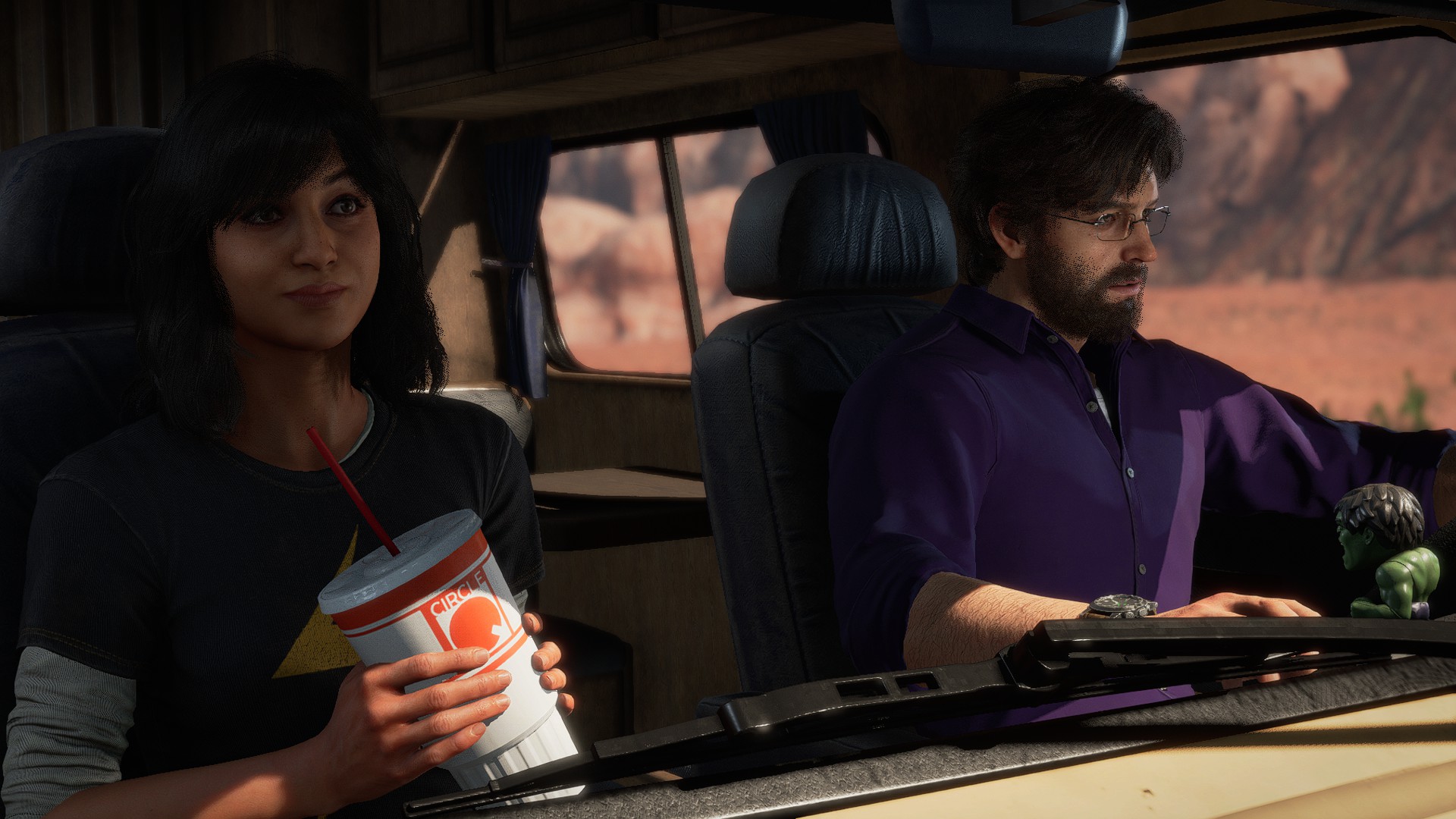

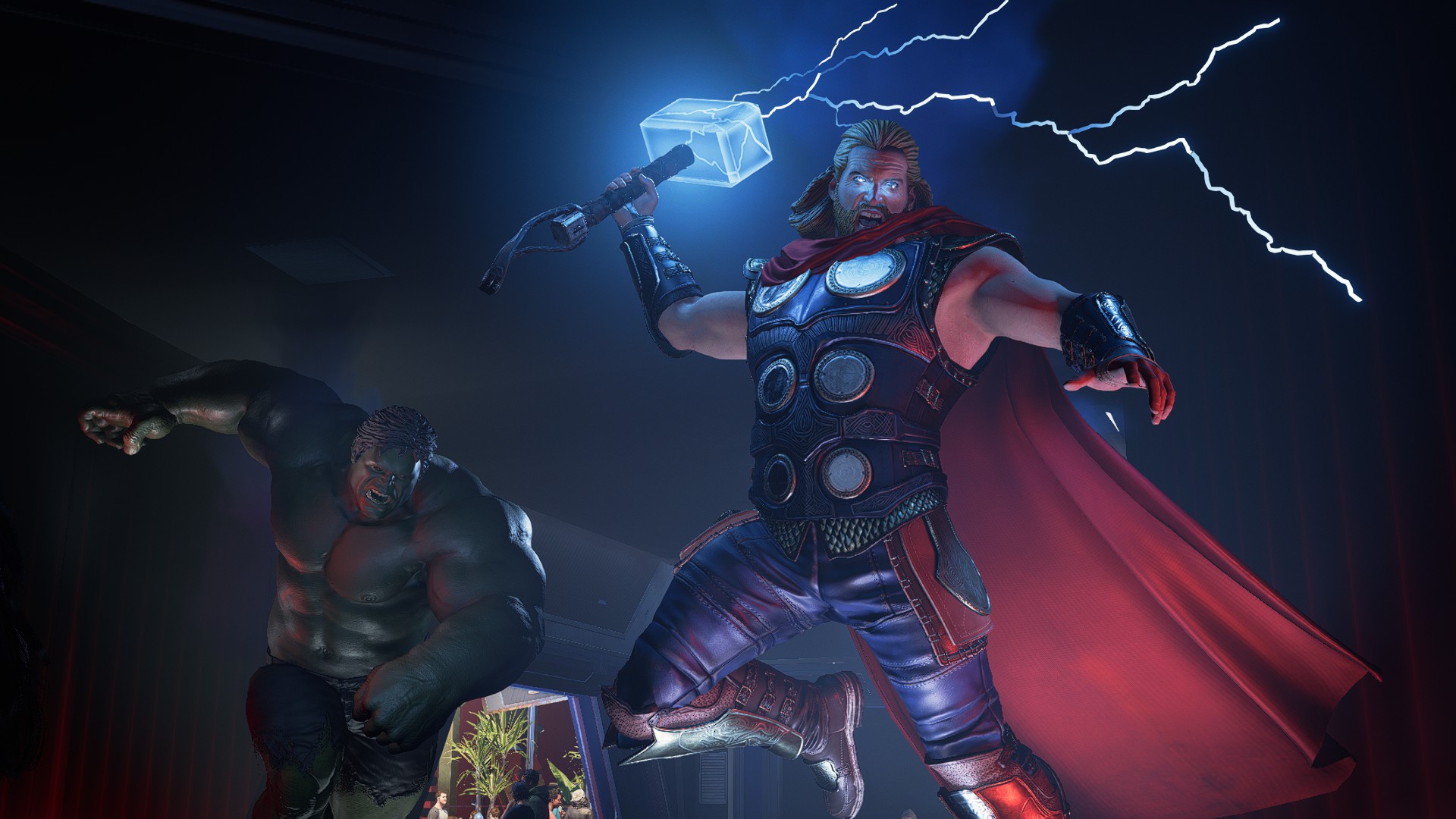

I've noticed it just on a few games - Marvel's Avengers, Modern Warfare Warzone, Red Dead Redemption 2 and Mafia 1 Definitive Edition. It's generally more perceptible on hair (beard), lines and detailed environments (high LOD). Dunno if is it a bug because of the nvidia freesync combination.
Card: GTX 1070
Monitor: AG323FWG3R3 (165hz FreeSync)
Screenshots of Marvel's Avengers (Very High preset wiht 70fps-90fps):
Ingame it doesn't look as jaggy as on these screenshots.
Just so you can see, 2 screenshots with little to no pixels (taken on the same playthrough).

Well, okay. I did a quick Google search and lots of people have the same issue "avengers pc game hair":
https://www.google.com/search?channel=fs&q=avengers+pc+game+hair
Some people said enabling TAA helps (rather than SMAA). It's the game.
Not a single video shows anything like what the OP posted. And I only see a few threads complaining about the hair and none of them have any screenshots like what the OP is showing. Feel free to post a link to something if you see it as I must be blind.

Also this from the Steam community. Not trying to be a jerk or anything, but I really think it's just the game.
You are not being a jerk. I did not even see that pic in the first link so its my fault. That said it looks nothing like that in 99% of the screenshots I see and again there is nothing like that in the gameplay videos so I dont know.
