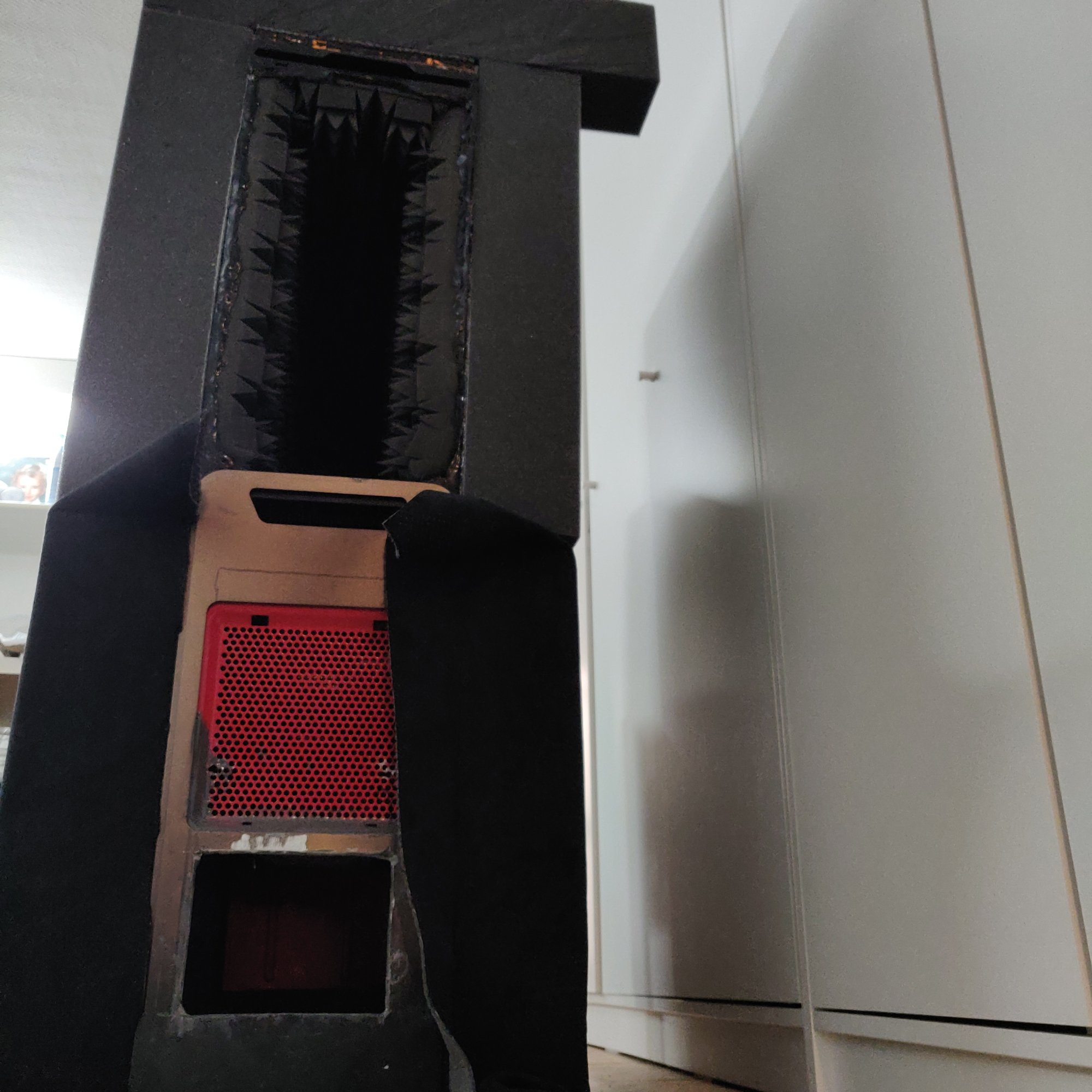

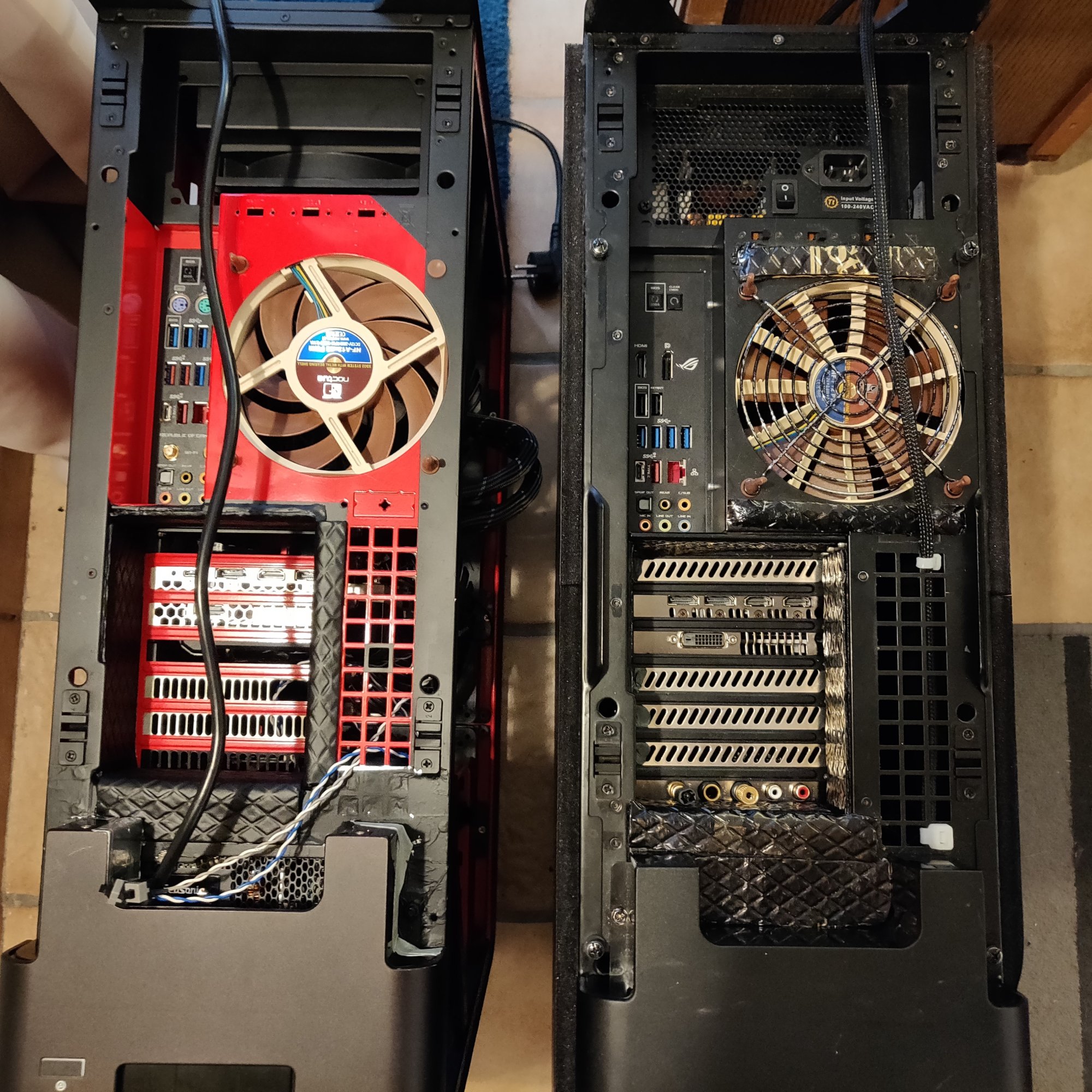

I tried to make it work for over 4000 days and the last 1000 i just had to compensate with raw 180mm fanpower.

This overheats with ALL fans on max:
I even tested two cards
By comparison this yanky setup is 8 to 10 degrees cooler with ALL fans running 80%
(everything finally below 80 degree C):

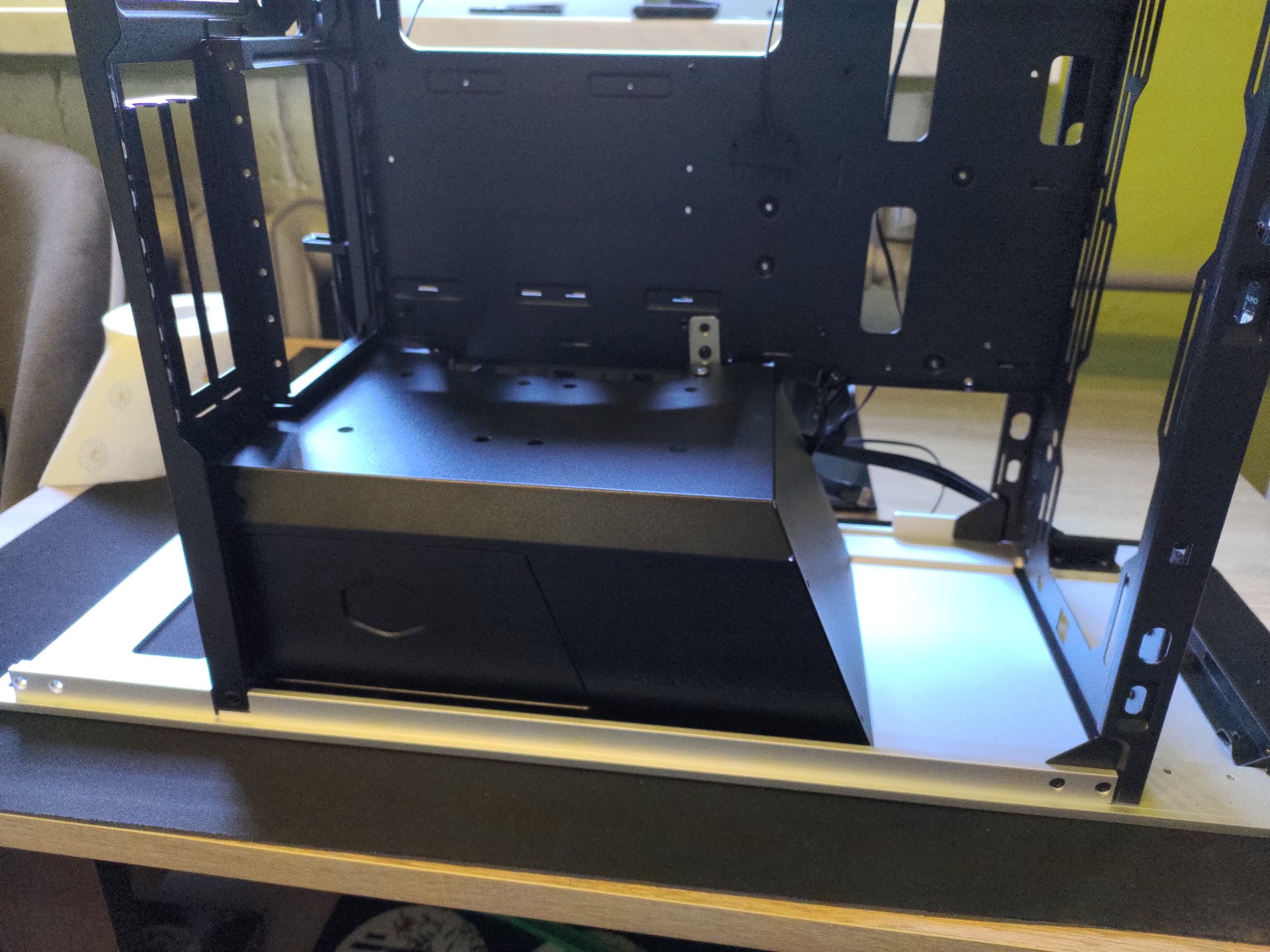

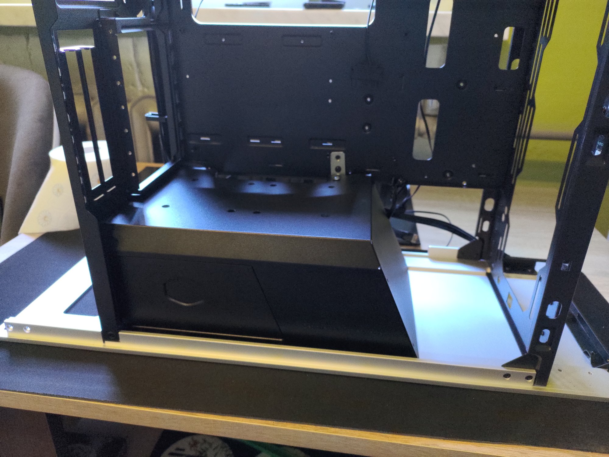

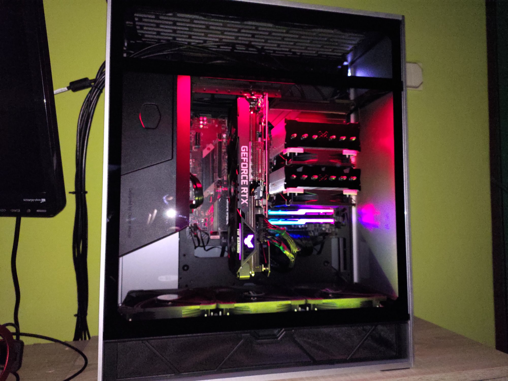

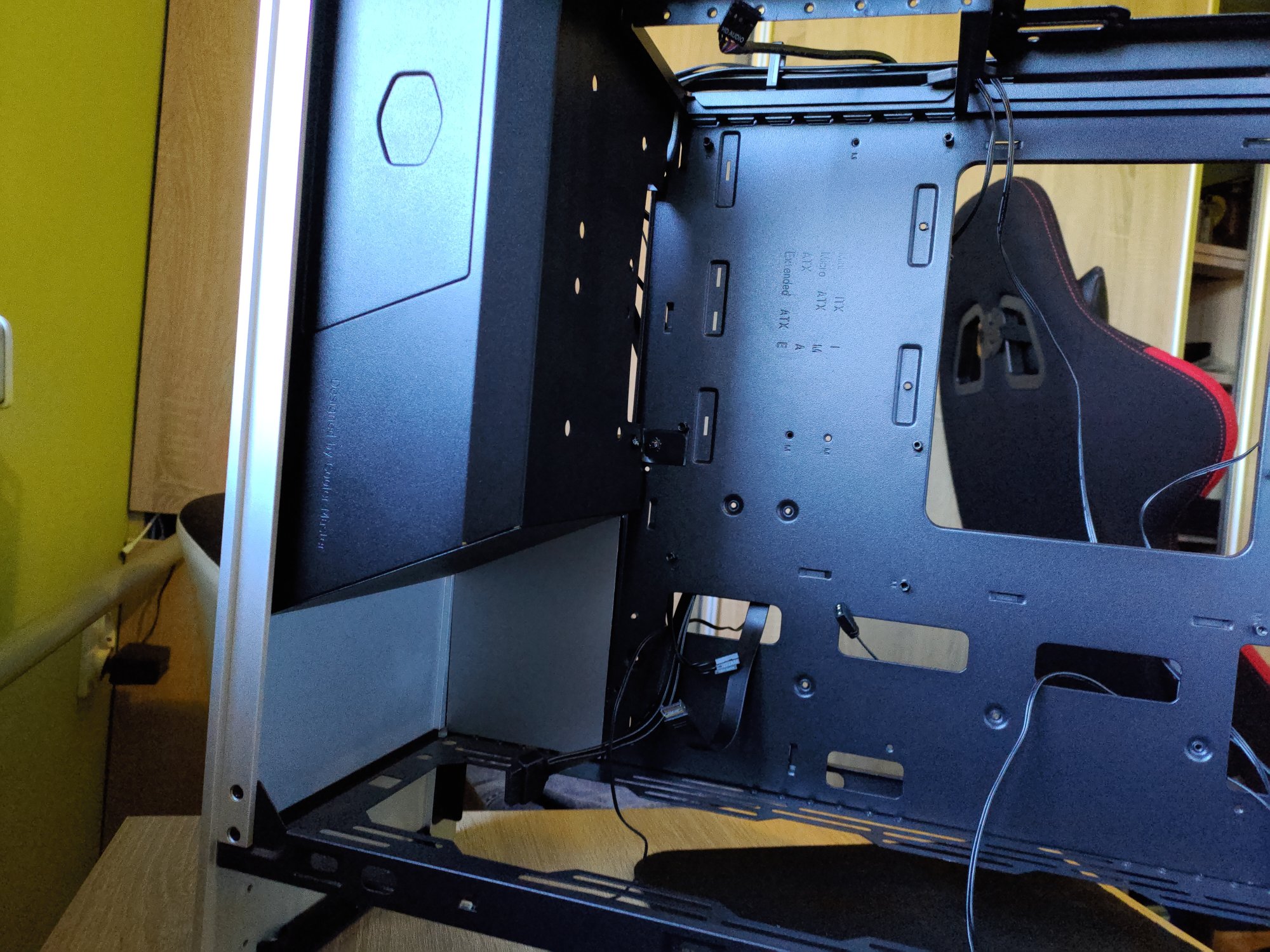

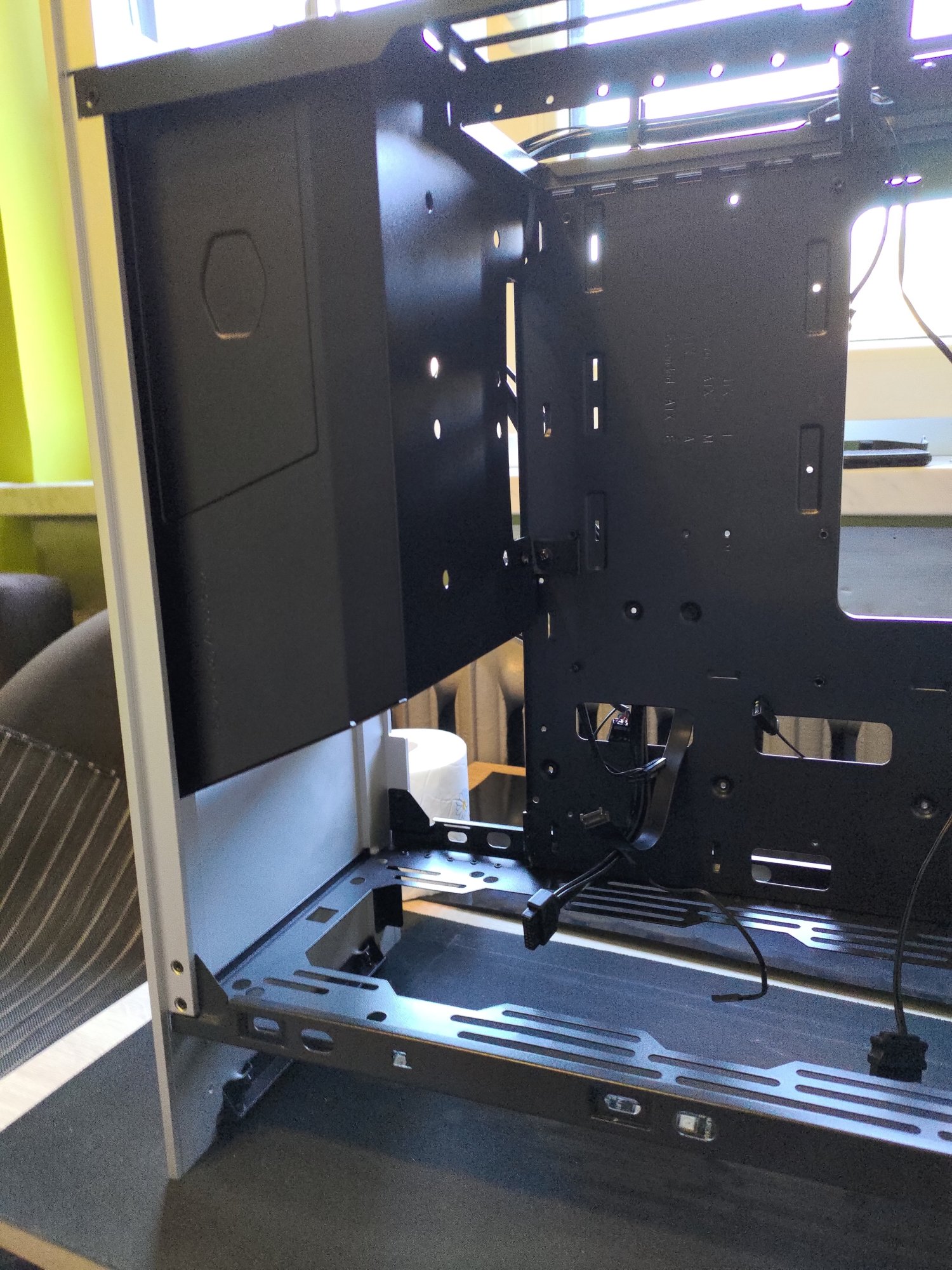

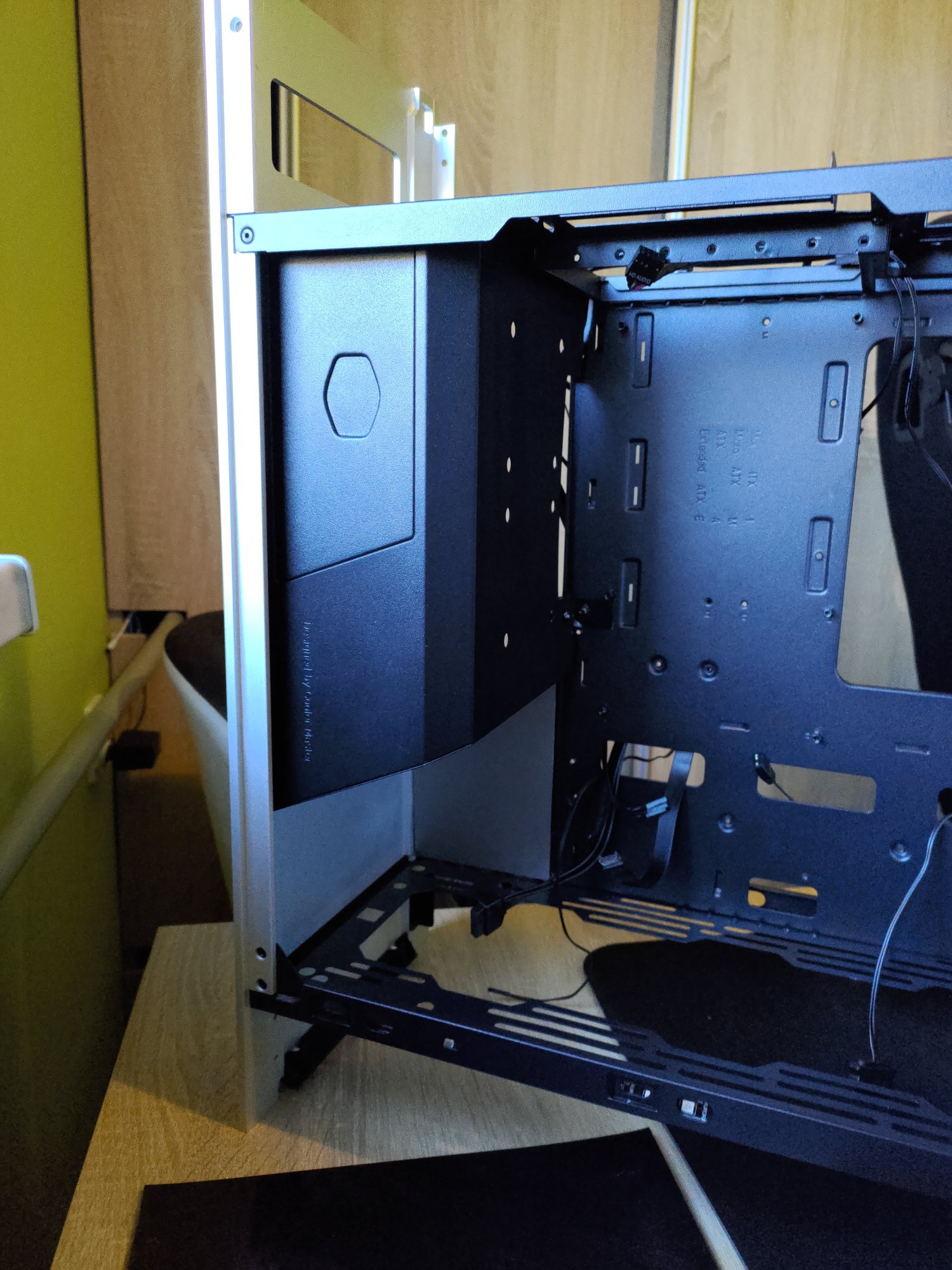

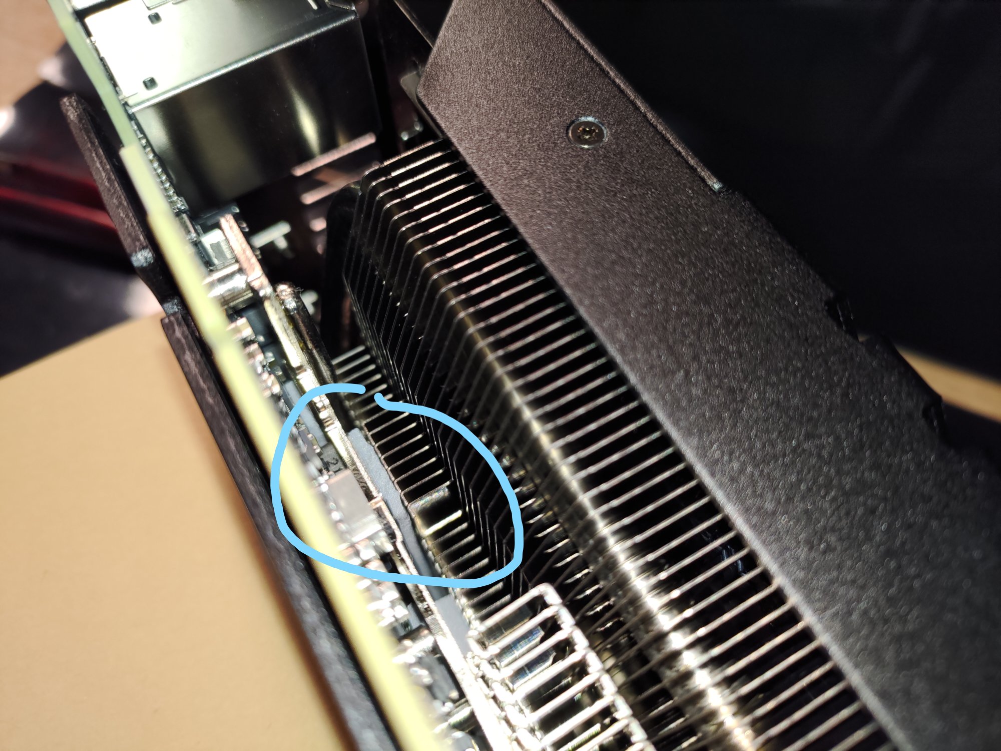

So here is update on this case from 7 months usage i can throw some salt at this case as its pretty situational.
First of all, i'll show you how case was standing till week ago.
My GPU temps have increased to 86 degrees / 103 hotspot.
Now, i'm a person, who clean room every week, so dust acumulation wasnt never an issue in filtered case - Alta F1 isnt exception - but after 6 months i took out all components and saw most of dust on CPU cooler. I use air compressor to clean dust from components (it have same pressure as canned air) and there was pretty much dust on CPU cooler - i could literally saw dense haze of dust coming off the cooler while blowing air on it. This however wasnt an issue to GPU - while it heatsink fins are vertical in this layout and i would suspect more dust on GPU, there was much fewer.
What really was interesting for me, was putting the 180 fans INSIDE the case (not under componnets chamber, but inside) to see how it would impact the GPU temps. So i bought cooler master H500 PSU shroud (shorter, with trapeze shape, moving more air on the GPU) to make a place for 180mm fans inside components chamber.
P_20220310_135052.jpgP_20220310_145518.jpgP_20220310_145449.jpgP_20220310_151417.jpgP_20220310_151424.jpgP_20220310_193759.jpg
And guess what...... 180mm fans wasnt fitting the fan holes inisde components chanber, as their frame was sticking to motherboard tray, forcing them closer to glass panel. I was so mad, drilled new holes on fans but still - there was no way of putting 4 screws on those fans as there is rail ending (for 140mm mounts) and holes for screwdrivers are placed. After placing 3 screws on both fans there were too close to side panel and panel's bottom rail wasnt getting into place - there was no way of closing case. Imagine how i was mad now.
So i putted 3 x Noctua NF-A14 PWM CH.BK.S fans on bottom, NO FANS ON TOP, as i saw 3 x 140mm fans are performing better than dual 180 here. I didnt used default case fans as these are very loud on onything above 5V, one of 3 fans is making ticking noise. Resoults were worse. I mean much worse. CPU jumped from 73 degrees to 87 degrees under prime 95 load (small FFT). GPU was 92 degrees on 3D mark - throttling has started.
Then, fully demotivated i swapped fans for layer before, those 3 fans on top, dual 180 on bottom and still have problems with GPU (at least CPU have settled back on 73 degrees). I had to increase GPU fans as only solution. Differently from games (tested before cleaning and after with RDR 2 and Cyberglitch 2077) hotspot was raising to 103 degrees, memory 106 degrees and all that withexac same fan curve as when i first setted it (35% @60 degree, 45% @70 degree, 55% @80 degree) with 70 Power target, -30 memory clock, -30 core clock. That is insane. What i have discovered on close inspection of GPU is that one thermopad is squeezed and have no contact with heatsink.
Unnecessarly i tried to form it but no luck - only on its border it have some small contact i have formed, but deeper, all along there is 0,5mm - 1mm gap. Thats very worry as i didnt squeezed card in hands before, i am very gentle with hardware. That raise the question - is that orientation of GPU is making HEATSINK sag? How to prevent it, where to put any support?
Finally we come to service area, behind motheboard tray - with my PSU, that have all sleeved cables i have to bend the glass panel to close it (we all know how bending the glass is save) - there is too few space behind motherboard . There should be at least 2cm more between glass panel and motherboard tray. When i route the cables, i never cross them with each other, so 24 pin cable isnt above or under any other fat cable from PSU. I have ordered slim cables as i dont know how much time this glass will hold up.
Thats all my experience with the case for now. Its not ideal, it have many downsides (whole case shold be much wider to accomodate dual 180 on bottom INSIDE, and all even fattest cables from PSU.
That said, this is my 2 cents about it. It definetly need revisiting and creating revision 2, necessarily without second glass panel (metal only, even spaced) and rubber grommets (specially on back - from where all the cables come from - that would increase the pressure of exhaust fans).

From what I have seen on the O11 Dynamic EVO's Upright GPU mount - cards like the Asus ones that have vapor chamber cooling problems with the vertical position, work great when the card is flipped around so the ports are facing downards, ie upside down....
So if you have a riser cable, try pointing the card upside down and see if it helps, if you can't flip the PC like that
