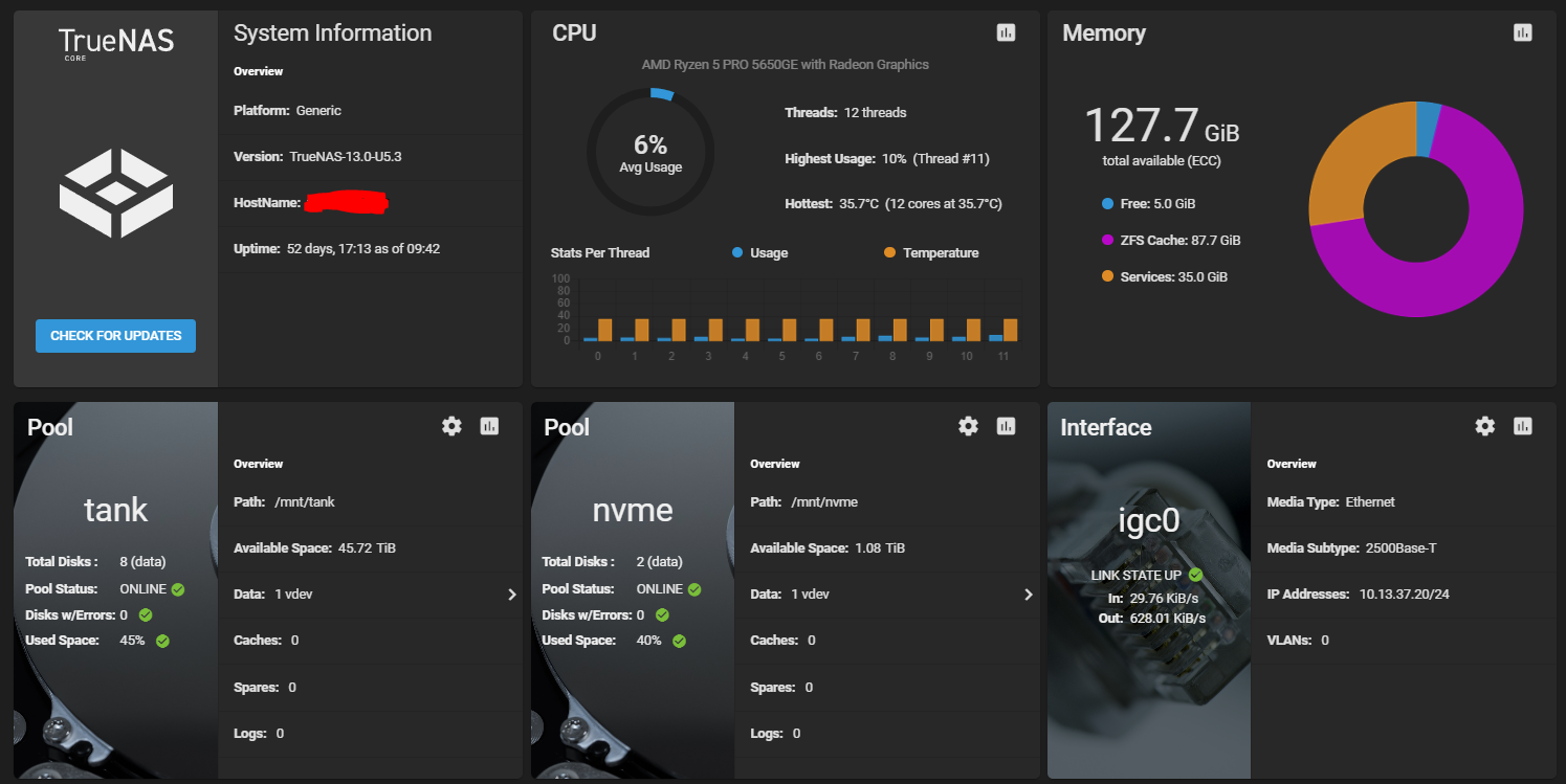

I've had two setups running TrueNAS Core (I think I started when it was called FreeNAS still...) X370 Taichi / 2700X and now X570S Aero G / Pro 5650Ge (both with 128GB Nemix Unbuffered ECC) and they've been rock solid. In the X370 Taichi system I had some hiccups that were my own fault when I initially did the build (my launch Ryzen 1700 didn't like FreeBSD, and my onboard 10 SATA ports- some from ASMedia 3rd party controller- didn't like all being populated but moving to a 2700X and LSI HBA totally solved everything)
For storage I went with the Seagate 20TB Exos models for that have been on sale for a long while at $279.99. 5 year warranty, enterprise quality, so far so good but I have plenty of redundancy and backups if the array were to fail for whatever reason. I know many people don't trust Seagate, but it's hard to beat that deal in terms of price/capacity on new drives. Not sure what your budget is, obviously you can buy whatever drives you feel comfortable with. ZFS planning is "fun", you have to consider if you want to mirror vdevs and/or run RAIDZ2/RAIDZ3 etc... You don't have to use TrueNAS Core or anything FreeBSD based, Linux based OSes have pretty good OpenZFS support nowadays so choose whatever OS fits your use case best. Optionally get a GPU if you're doing something like Plex and need extra transcoding horsepower if the CPU isn't going to keep up. I would at least encourage ECC memory but it's ultimately your choice.
To "saturate" 2.5GbE it's pretty easy, your read spead on the array will only need to be around 312 MB/s. To "saturate" 10GbE you're looking at around 1250 MB/s. I'm bottlenecked on network transfers pretty hard right now, but I've been too lazy to swap in a 10GbE NIC. I started with the onboard 2.5GbE just to get it up and running and said screw it. It works fine for what I'm doing.

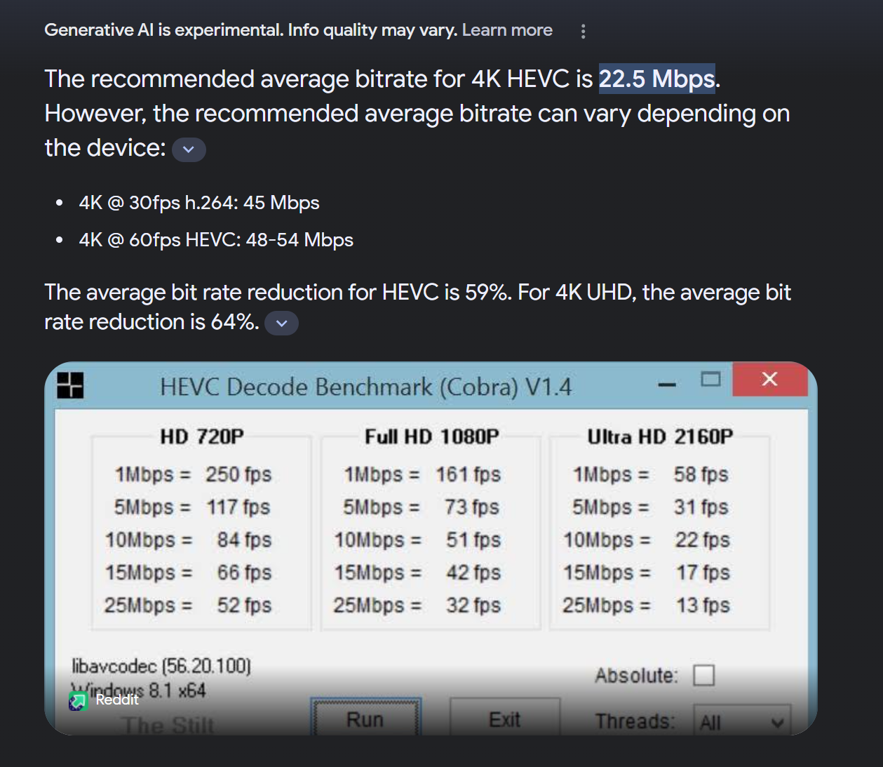

4k video does not saturate even 1 Gb/sec, though.
Uncompressed 4k video does in fact saturate a 1 Gb/sec.
The bandwidth needed for video doesn't have to do with the resolution of the video. It has to do with how high the video's bitrate is.
Right, of course. I was thinking about compressed video with bitrates of streaming or as ripped from 4k Blu Rays.

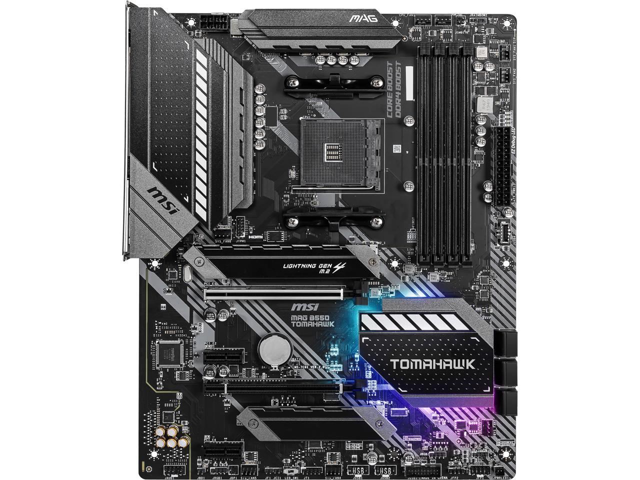

I picked up a ryzen 5 5600
Msi b550 tomahawk

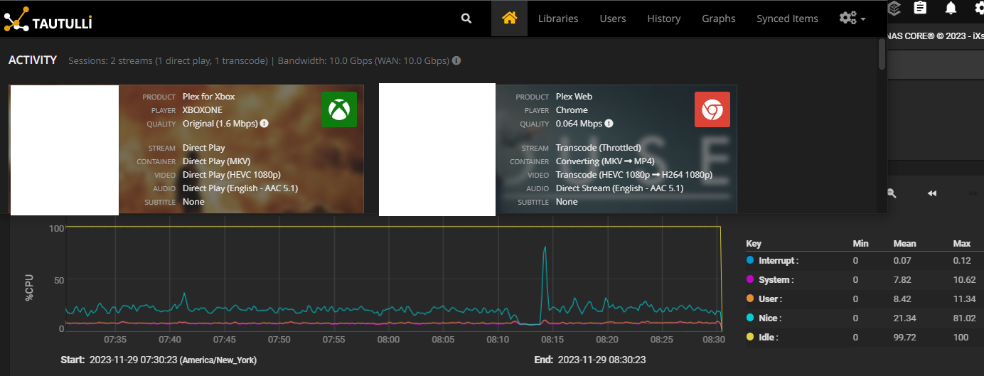

Well first you should probably decide on what OS you're going to be using before looking for a guide. But assuming you go with TrueNAS Scale (which is what I would personally wholeheartedly recommend). It should be as simple as installing the Plex plugin and in the resource reservation section settings, make sure you select the 5600XT.
Then in Plex settings enable Use hardware acceleration when available
I think it should work with a 5600XT which you mentioned you have. Most people are using Nvidia or Intel integrated graphics but maybe research it a little just to verify it will work. There are lots of good resources on the TrueNAS community forums (stick to the SCALE subforum as CORE subforum is FreeBSD based and configured a lot differently). Another thing, I don't even use hardware transcoding on my Plex and I'm using a 5650GE which is slower than a 5600. All my content is 720P/1080P HEVC so most clients direct play, but if a transcode needs to happen the CPU can easily handle 3 - 4 at that same time with a fair bit of other software running in the background (various software running "natively" in FreeBSD jails and stuff running in Linux virtual machines). If you have 4k content it will be more demanding. You might be surprised, try it without hardware (GPU) transcoding and monitor your CPU usage. Then you can just throw it the cheapest potato GPU just to have video output for when you need to physically access the server.
