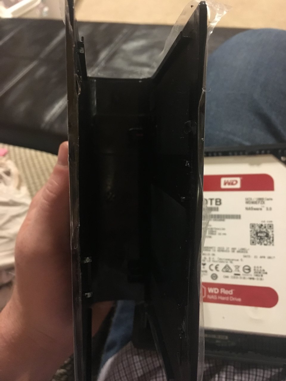

It has a WD RED NAS Hard Drive inside as expected.
Dated April 21, 2017.
Made in China.
I destroyed the crap out of my clips so there's no going back for warranty. Don't use a butter knife, or if you do, do it more gracefully than I did. Frankly I have no ideas how you could get this off without breaking them. I busted 2 of 4 and the remaining two look mangled.

Thanks for reposting this.There's the PDF linked with instructions... shoulda took a look. https://hardforum.com/threads/180-8...-wd-red-inside.1930595/page-3#post-1042985422
Maybe OP should put it in the 1st post to make it easier to find?
It took me a little patience with the first one, then once you figure it out it's simple.
You can use a credit card cut into two (or two different credit cards) and something else after to use to wedge it out. It didn't even really damage the cards at all either but I had some around that I didn't care about ruining. I then packaged everything back up in the retail box, without fully assembling, to make it easy to pop in later if needed for warranty.

Yes, this is the key. I followed Hanime's instructions about where to insert the cards and to press hard but the clips were not releasing. So I flexed one of the cards outward while pressing inwards hard until I felt it slip past the bump and bottom out. Did that for the other three clips and then followed the rest of his instructions. It was still a bitch to get open but I managed to get both drives out of their shells with no damage. For a snap-together enclosure, that thing is really well made!Thanks for reposting this.
For those that may struggle with this, you shove the CC in the spots specified, then flex them until it pops up. you don't need to cut them into guitar pick sized/shaped pieces. I used full CC/Gift Cards and it worked like a charm.
Shucked two more tonight. Piece of cake. Now time to give my wallet a rest....
