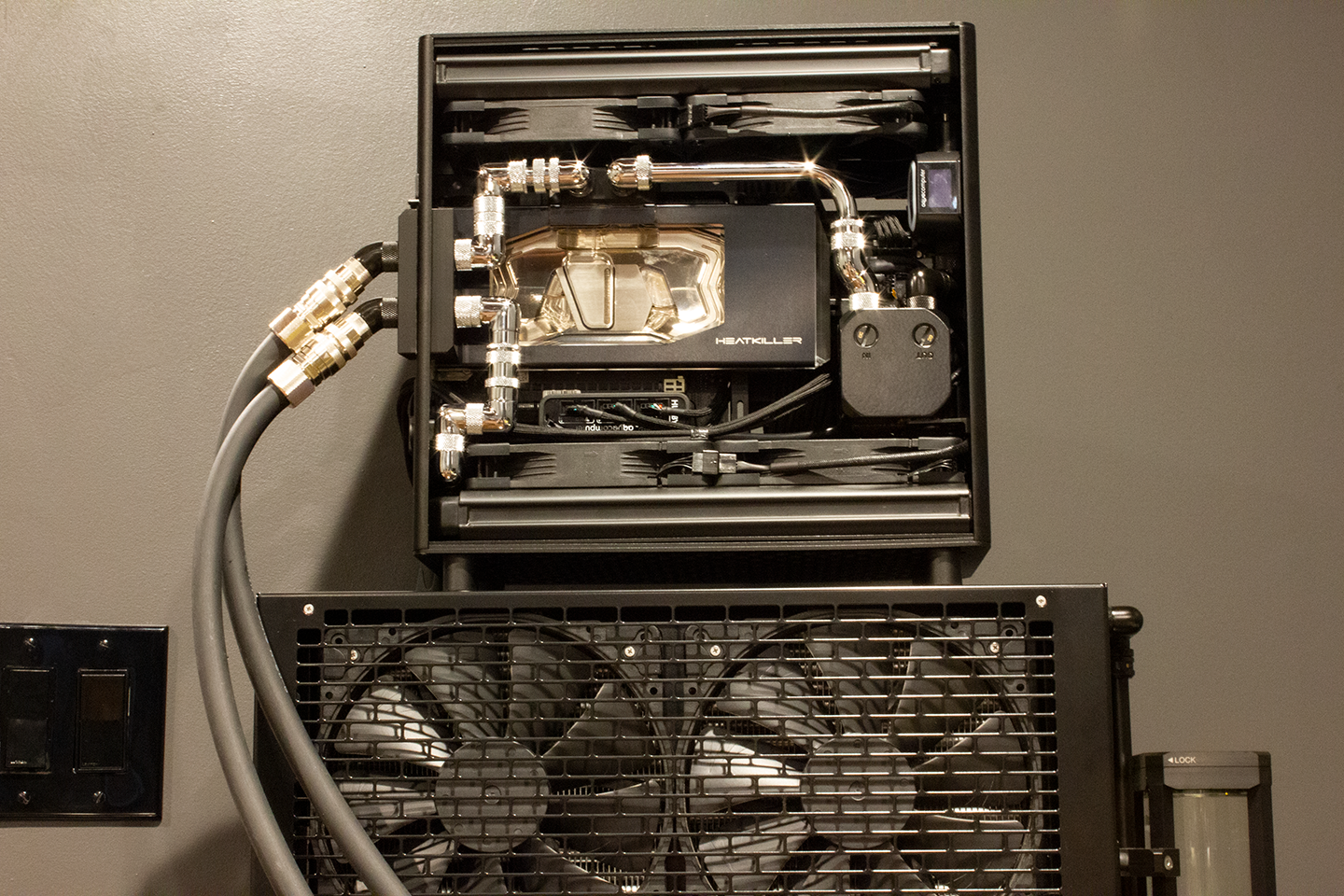

Well I decided to WC my Radeon VII DC / Mining rig to try to make it less noisy and run cooler. Ended up ordering everything from Ali Express which was a bit of a risk but worked out. I would have bought from a US company but there was nowhere I could find the waterblocks for my GPU's except China. Everything was in pretty good shape except they didn't include any thermal pads and one of my radiators has a bit of a dent on one end but its not a problem.
Got everything put together and it all powered up but my temps were absolutely terrible and it was throttling... Figured out I wasn't supposed to put the plaster washers on both side of the PCB and because I did it wasn't getting good pressure or spreading out my TIM at all. I fixed that on one of the cards and did a test mount and it's looking way way better so I think that was the problem.
Last time i did "custom" water it was a swifttech h20 220 kit and it was CPU only so this is my first foray into GPU cooling.
