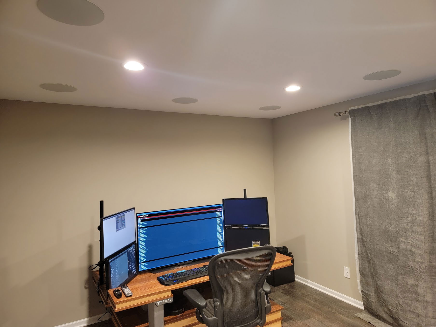

This is what I have now. 5 of the Yamaha NSIC800WH and the cheapest yamaha 5.1 receiver

Also, nice setup, I've got a CX 48 also.
1. What wattage do you have for those Yamahas? The Z906 satellite speakers are 67 watts so I'm wondering if using one of those for the center with the 140 watt Yamahas will sound odd.
2. An recommendations for a decent $300-$500 5.1 receiver?
3. What are the side monitors you're using?
4. What desk is that?
Oh last question - does it sound odd in games with the sound coming from above you or does it feel pretty natural as if the speakers are at your head level?

1. The Yamahas are 140 watts each. It might sound a little weird, but you can try it out and I think you can adjust the volume for the center separately on the Z906, and you can using a receiver. You also don't need to use a center channel, you can set windows to use just fronts and rears.
2. I use a Yamaha RX-V679BL, but they have newer models now, you could use their cheapest 5.1 system (RX-V385) and be fine.
3. They're just older monitors that I've kept as I've upgraded. On the left I have the first GSYNC monitor that had the DIY GSYNC kit, then the first 2560x1440 144hz gsync monitor. On the right I have one of the first 120hz 1080p LCDs, and another older viewsonic monitor. I used to use 8 monitors until I got the CX 48.
4. It's a custom made desk, the front and back can move independently.
It sounds a little different, you can tell the sound is coming from above and not just straight at you, but you get used to it pretty quick.
