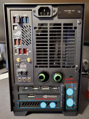

My idea is to use a Pass Through Slot/Bracket to lead the water out of the Ncase to an addition external radiator.
I am not sure if this will fit with the bottom radiator installed, in case it might be to tight, the pass through connectors could be moved to the right side - see example (draft / idea) image:
(this image is not from my build, i just took this as an example, on my build - the icemen is positioned at the rear-exhaust-default position)
What did you think?
So the point is to keep the Iceman and the ddc pump on his position.
It also would be perfect to even keep the bottom radiator installed. But in the end it might be bearable to remove the bottom radiator from the case.

Hard to say until you try. I have a feeling you'll have to remove that lower radiator to make it work.
What are your ambient temps like in the summer?

The easiest fix would go with a bigger case.
However, I had a setup for a couple of years where I had radiators in a seperate box that hung off the back of the stand I kept the PC on. It worked great, as it kept the radiators low near the floor, and you could run fans with higher RPMs and not notice the noise.
You could even remove the radiator in your case, and have your rads exterior.
The pass-through connector were not available when I built mine, and instead used bulkhead quick disconnects.
I would highly recommend using quick disconnects at whichever pass-through you end up using. This allows you to move the case around with having to drain the system everytime.
If I had to do the same thing again I would just go with something like the Alphacool nexXxos XT45 1080. It is not too expensive, and should allow more than enough cooling for your system.
https://www.aquatuning.de/wasserkue...BdUEItv7LjxEjvcQ33upcd8gMveGbRGxoCTegQAvD_BwE
Maybe we will be lucky this year and have mild summer.
Edit: And 48c is just too warm for your coolant, and the ultra thin rads you are using are probably just not adequate this will get much worse when summer temperatures come.
