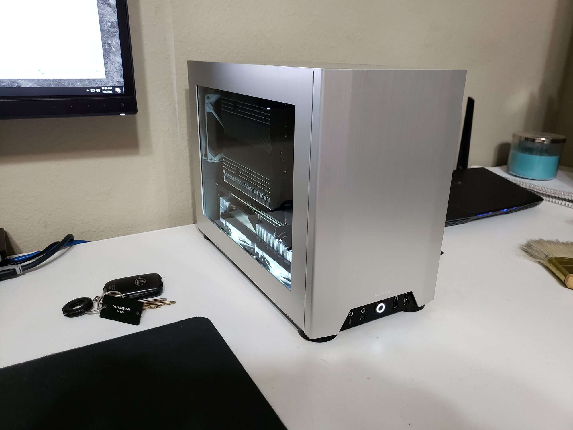

Almost done with this. I tried making cables myself but gave up so I ordered some from cablemod. I ordered some thin 2x6 inch pieces of black aluminum to mount on the side of the psu and next to the CPU fan, basically creating a small wall to hide cables. Not elegant at the moment. I need to do some adjusting with it but I like the idea so far. Looks really good either way since the only cables you can see are the premium 8 and 6 pin PCIE cables with aluminum combs. The only thing I need now is a 140mm fan grill so that way I can mount the thin usb 3.0 header connector. It still rubs against the fan.

There's a lot to like in your build!
  • X299 with direct CPU die cooling!
  • the black plates do a great job of tidying up the appearance of the power supply area
  • using the M1 case badge on your set of keys
  • the SLI cap with the EVGA branding
  • the subtle colours of the components and fans
  • the 25 mm thick rear fan behind the NF-C14S (I can only fit a slim fan behind the original NF-C14 on my motherboard.)
Really great build!
Can you share more info about what you used to hide the psu?
Very nice build.
C14s plus accelero 3 looks flawless

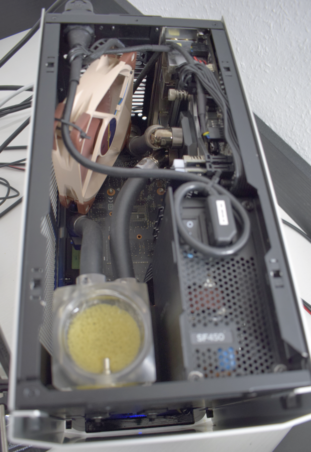

Small build update, changed a Noctua NF-S12A (~ 530 rpm fixed) to cool RAM, because high RAM OC with watercooled fanless Ncase M1 won't work so well. I also moved the external radiator 3m away from my desk, I fixed the fans also to 530 rpm.
8600k @ 5 Ghz All Core / 4.7 Ghz Cache
GTX 1070 @ 2100 Mhz / 4500 Mhz
G.Skill DDR4-3200 CL14 @ 4133 CL17
Water temp maximum 6 K delta-T to ambient temp, plenty of room for future hardware upgrades.

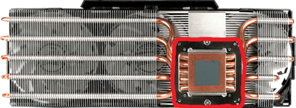

The accellero would need you to physically glue on small heatsinks exactly where the water block was requiring thermal pads (it comes with thermal glue). You can use reference cards or aib. Doesn't matter. The accellero gets physically attached to the actual GPU chip and nowhere else, so as long as the accellero cold plate makes contact with the GPU chip you will be fine.
So glue those things on the front and back? Think i'd prefer the tape somebody mentioned

You would need to attach the heat sinks where they are in that image with the thermal glue provided. You also have to put down some thermal tape before you do it, otherwise you risk shorting out certain parts due to metal on metal.
