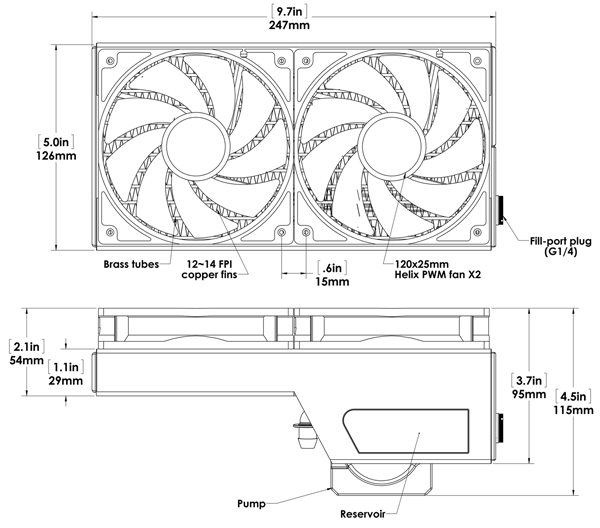

So I was looking at the dimensions of the H220-X and I couldn't fully understand why it wouldn't fit in the case. The reservoir is only 95mm with the pump extending a little bit into 115mm. The IO ports wouldn't be affected by the pump because theres a little bit of spacing and the unit itself is a bit shorter. The only thing I could see being a problem is that the pump has to be oriented to the motherboard side so it might touch the block. So is that the reason why it wouldn't be able to fit? Because of the 15mm spacing?
The reservoir would come up right to the motherboard I/O shield, so the pump extends about 20mm into the motherboard area. That only leaves about 23mm of height for motherboard components and (maybe) the waterblock. You'd need a board with no tall components in the area below the pump, and the CPU socket over next to the PCIe slot to maximize the possibility of it working. Then you still have the tubing to worry about. I don't know 100% that you couldn't make it fit with exactly the right components, but I think it's a longshot at best.
