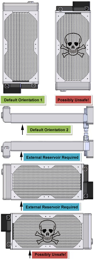

I’m trying to figure out how watercooling works with this case. It looks like many people are going to use the H220, possibly adding a GPU loop. This seems like a good idea with the M1, the GPU is the largest heat source by far in the case, and the loop should make exhausting all that heat more efficient (and thus quieter).
My concern is the reservoir orientation of the H220 and its location in reference to the pump integrated into the CPU waterblock.
Since the reservoir is integrated into the radiator in the H220, I would think the orientation of the assembly would matter. The radiator should drain into the loop, correct? Does the connection between the reservoir and the radiator enable this flow when it’s mounted horizontally in the M1?
To visualize, look at this image from the Swiftech site (this is for a different product, but I think it still should help illustrate my concern): http://www.swiftech.com/images/product_pages/MCR-Drive-r2/rev2-orientationsx354x929.jpg
When mounted in the horizontal location it indicates that either the setup needs an external reservoir (presumably because the internal one won’t drain properly into the loop in that orientation) or that it’s potentially unsafe (presumably because in that orientation the pump is higher than the radiator).
I think depending on the H220 design, we may have the former problem, and we also have the latter problem, since the pump is integrated into the CPU waterblock, and thus ends up being mounted fairly high in the case relative to the reservoir.
My gut feeling is that the H220 isn’t ideal at all. But since I’m a total n00b with all of this, I assume I’m missing something with my logic. :) So could someone help me clear up what I’ve got wrong here?
I installed the pump with the inlet facing up, so at least part of the radiator sits above the pump. I think it may only be a concern if you don't have the inlet facing up, or if the socket location is high on the board. But even then, it may work fine once the loop is properly filled and bled (which you could place the case on its side for, and thus guarantee the rad being above the pump).
There is a "slight" difference. Lets include the image:
This image refers to the fact that a line of Swiftech products have not only the reservoir as part of their rad but, ALSO, their pump. So, its not recommended to run the pumps on such position UNLESS you know how to feed them water when you are filling up your loop.
The problem is that the pumps used on a computer watercooling setup do not suck, they only push, which means that you need to have water on them all the time if you want to make such thing work. So, because the pump in such position has no change to get water when filling up (unless you turn upside down your computer, that is) its not recommended to do so because you could burn the pump.
I hope I clarified.
PS: the h220 has the pump on the cpu block, not on the rad. So, its different. Rad position doesn't really matter.
