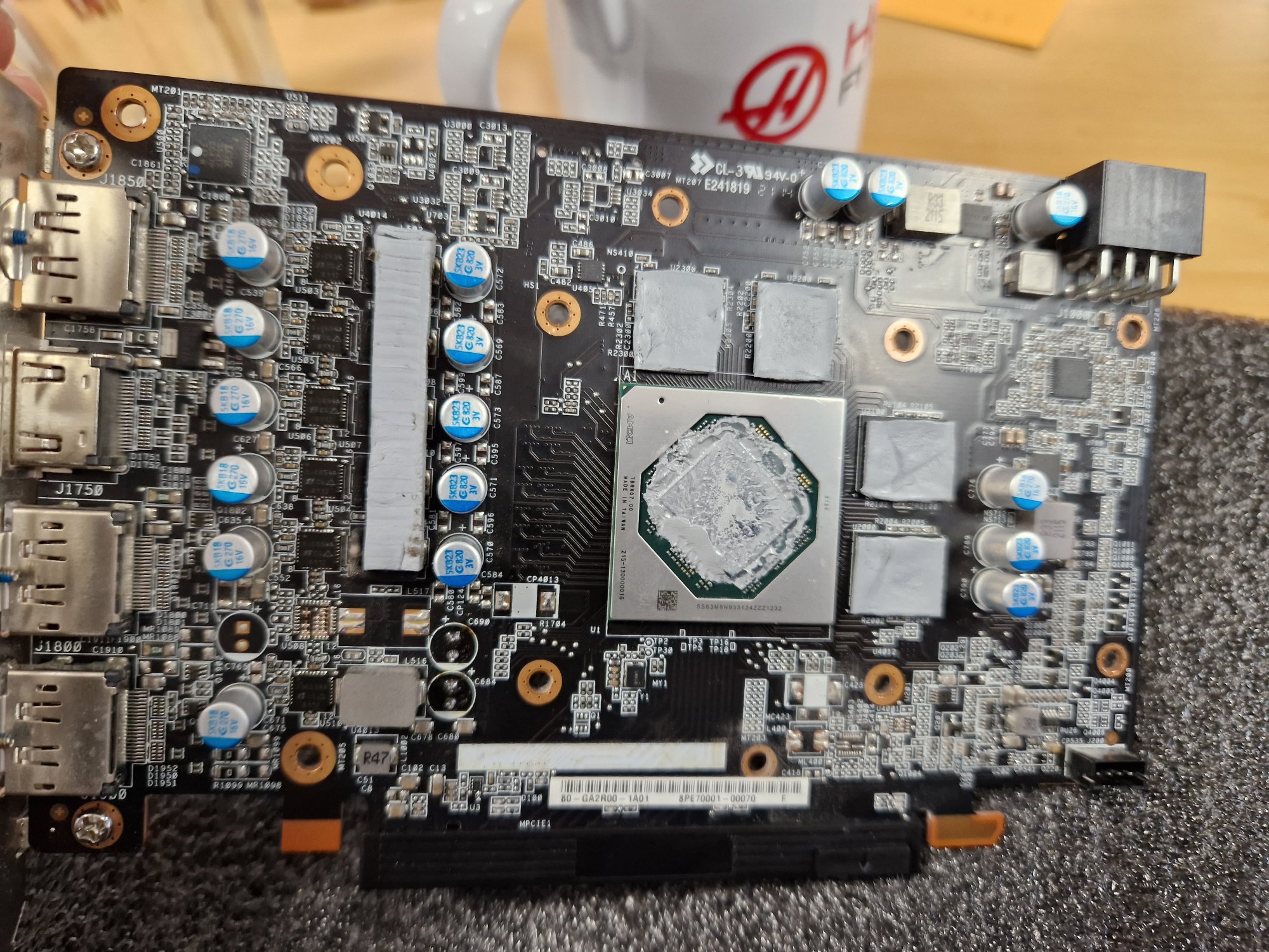

The bykski gpu block does not fit, I took a chance on it but luckily I can return it. I bought the Rx 6600 XT itx block since the Rx 6600 XT itx and the Rx 6600 PCB look similar on the pictures online, but one condensator is in the way so it does not fit :(
So back to using my old setup, but that will require som fidling around :)

Looking at the PCB, the following two capacitors are in the way:
Could I simply desolder them and mount them using wires, so they are placed in a different spot?
You think you can just take a drill to the block and "mill" it out where those caps go? Is that a solid part of the block?

Sadly there is a flow channel and o-ring groove right where the capacitors are.
However I could desolder and mount the capacitor on the other side of the PCB and just mill/drill a hole in the backplate? The capacitors are through hole.
one way to find out...
theoretically it should work and will definitely earn you your [H]ard badge

First trial fit after the mod of the capacitors:
Disassembly of the old water loop:
Fittings for the GPU block:
A couple of hours later after getting air out and checking for leaks ----> First trial mount and everything looks good.
Everyting back in place and ready for some testing:
No RGB since it runs 5V and my board runs 12V, but the water block do look nice :)
10 minutes of max stress testing in OCCT, so full load on GPU+CPU and temps are round 62C on CPU and GPU hot spot is 64C and fan is running around 80%.
