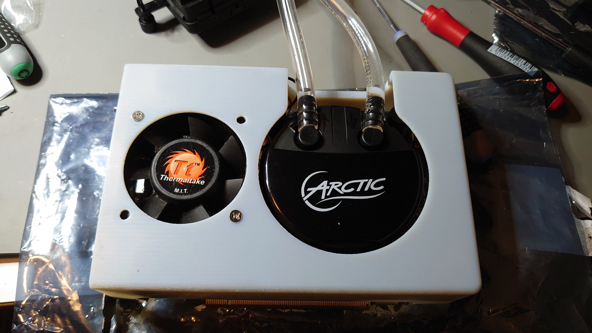

Also tested the Arctic cooler on the GPU and did a stress test. The GPU hot spot temp did not go above 46°C and fan was only running at 45%

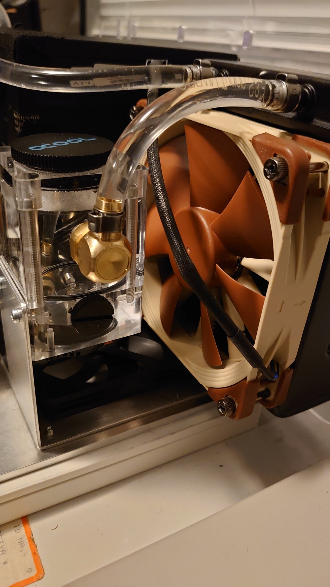

First the radiator would not clear the noctua fan so changed that to a low 12mm fan from scytche. But still missing 1mm clearance so need to drill the mounting holes a bit bigger.
Moved on and installed the GPU cooler

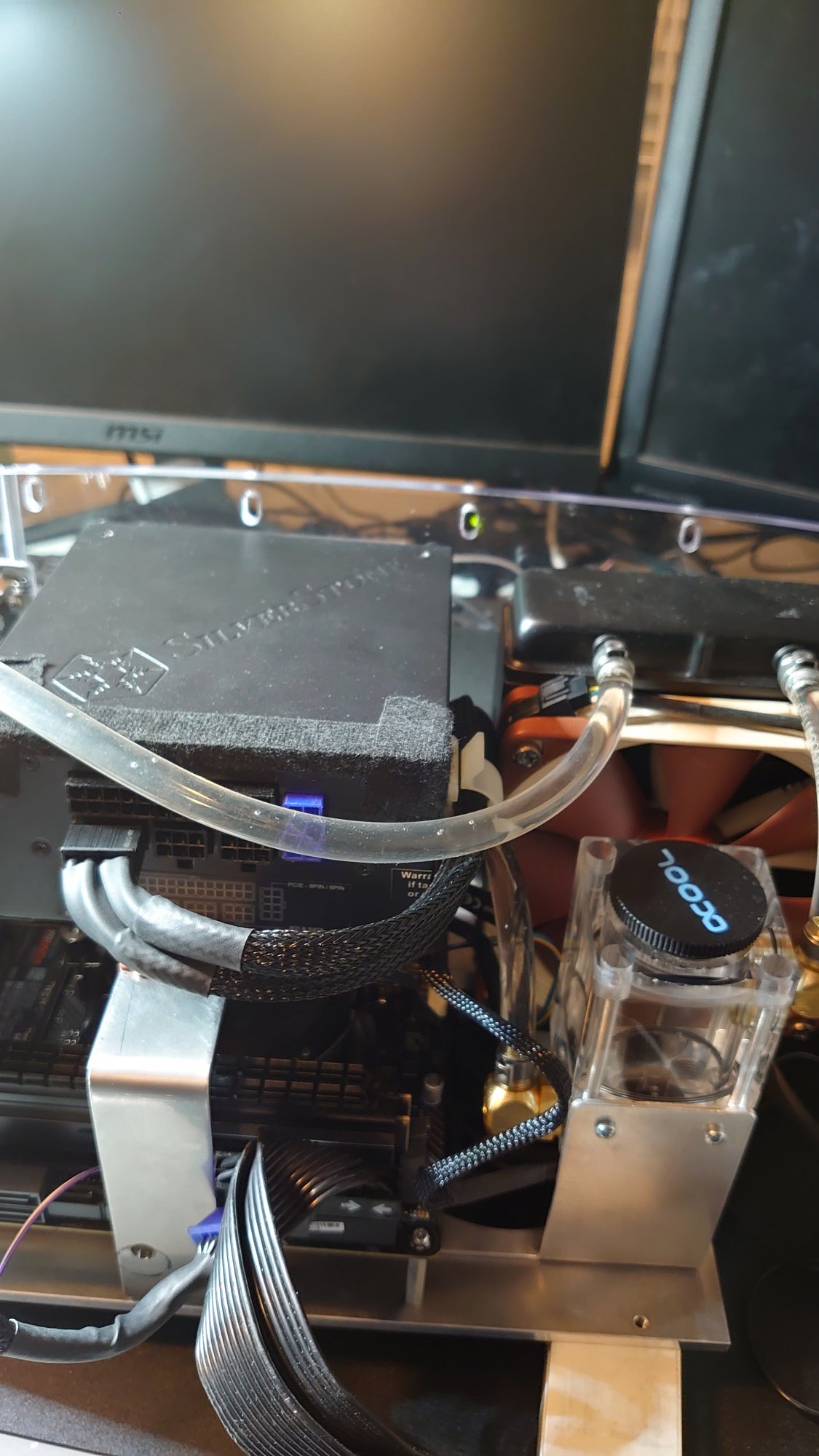

Due to the big size of the new radiator and the fact that I needed a bracket for the res+pump i decided to make a bracket that will hold the pump and fit a 92mm intake fan. This away I dont have to modify the PMMA backplate.

Got my pump bracket / fan adapter:
So playing CSGO for a couple of hours with this setup I see around 62°C on CPU and around 50°C on GPU. So it is working really well.

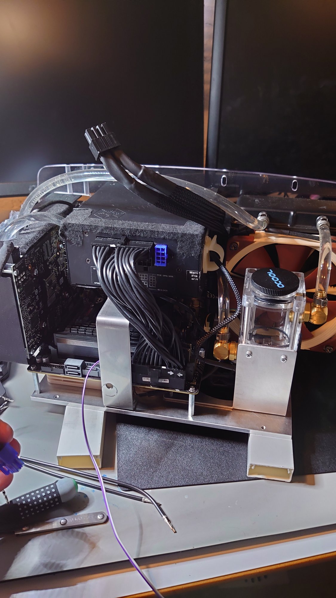

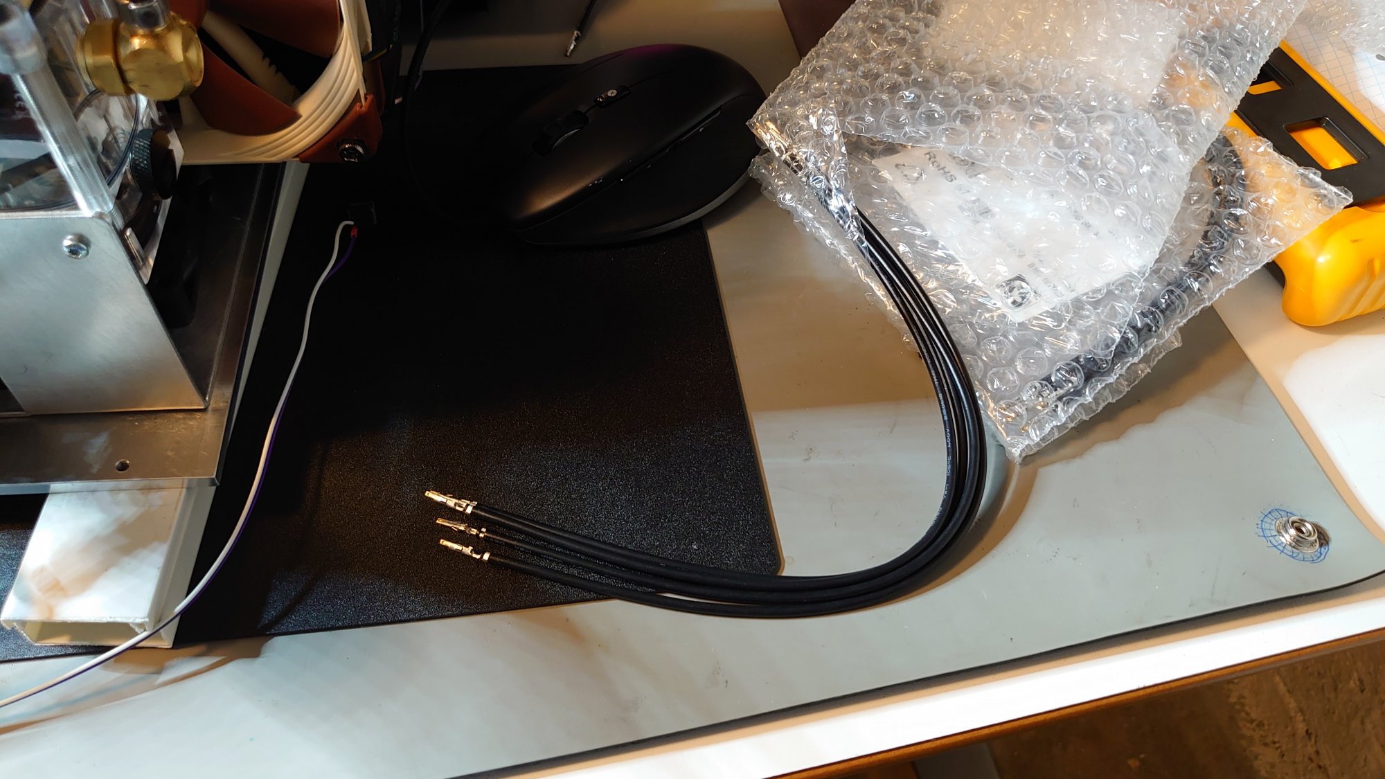

So finally got some wires from RS components:

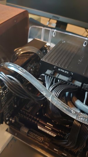

So I redid the CPU 8 pin cable and added a small cable holder to keep it nice and tidy:
Next up will be the 24 pin at cable.
Then I'm ready to reassemble into the case.
