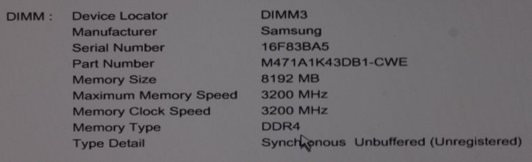

Default HP memory 8GB 3200MHz

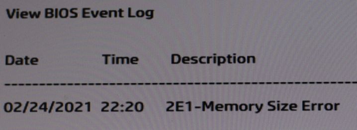

HP BIOS diagnostic shows error:
U4NDBX-000AHP-GXPQ2K-400103
Event log shows 2E1-Memory Size Error:

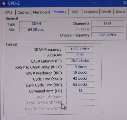

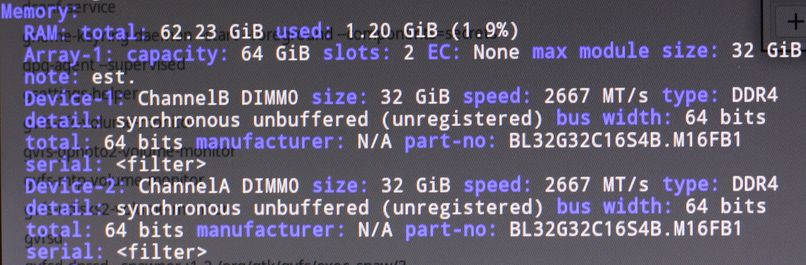

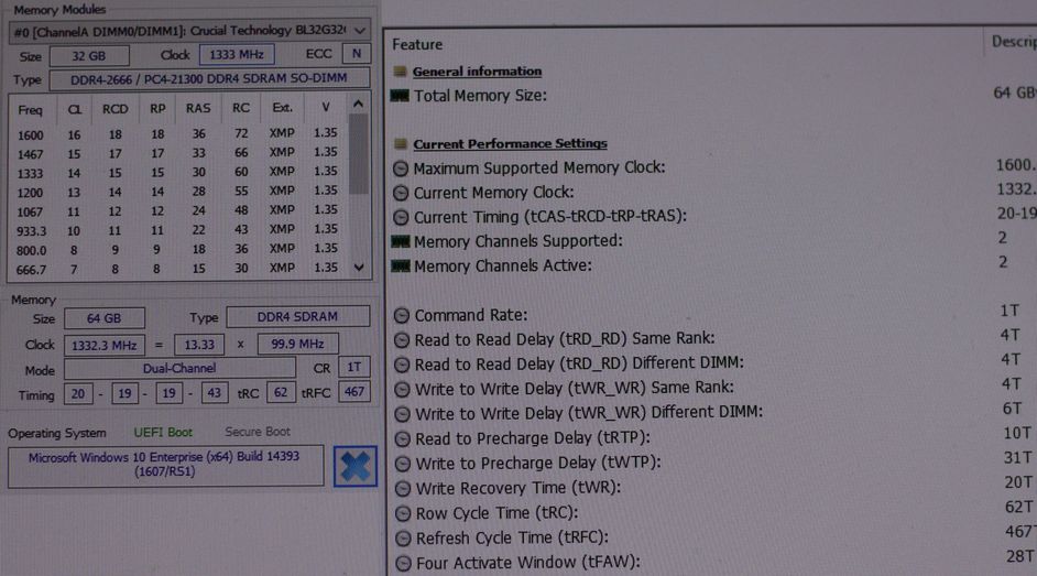

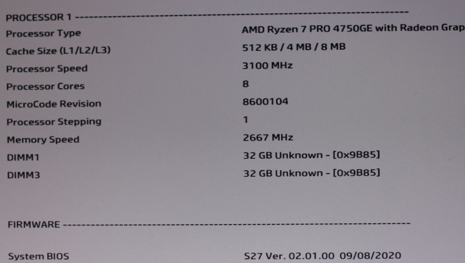

But the memory is detected in BIOS at 2667MHz (vendor advertised speed 3200MHz) with Unknown - [0x9B85] code:
I can boot live Linux and Windows distribution (loading it into memory) and it works:
HWInfo64 shows:

Yes, absolutely flash it with the latest BIOS. Use the original RAM of course for that process. But, as Pendragon1 points out, there is a note specifically warning against using third party RAM. The RAM you purchased is using XMP. XMP is an Intel platform standard but adoption into the AMD ecosystem has been improving. Looking at the screenshots there are a few things that would concern me. The RAM should be running with a CL16 and it appears to be running at CL20. Normally a slower CAS rate wouldn't be an issue, but it does make me think that the BIOS isn't able to read the XMP profile properly. HP is able to control their products so it may very well be that you're stuck purchasing from them or from a qualified RAM list.

When i combined Crucial Ballistix 32GB module that pass the memtest + factory 8GB Samsung module, then the BIOS memory diagnostics PASS and memtest too.

Stock 8GB memory is 22-22-22-52 1.2V 3200MHz but Ballistix is 266xMHz only.. (reported by BIOS and Linux, unsure if true)
