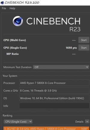

EDIT: Nov 28 2020 testing 5175Mhz
https://flic.kr/p/2kbmThw
Cinebench R23 - 1698
50657536457_79fbd71d69_b.jpgCinebench R23 1698 by gerard fraser, on Flickr
