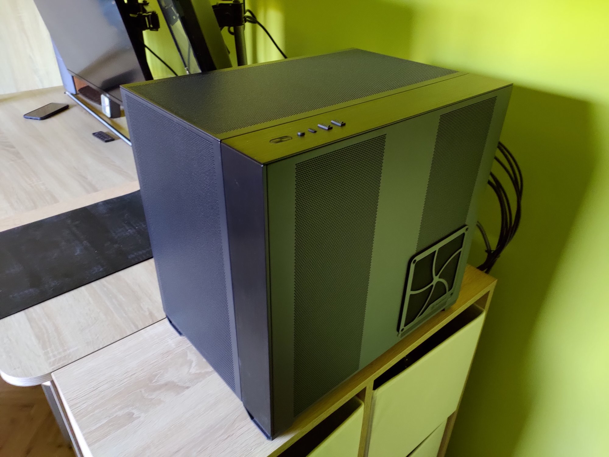

In last minute I choosed o11 air mini instead of mesh 2 performance - build is almost complete - I'm getting "milky" plexi for led strips and it will be ready in Sunday. As for fan placement I putted 2 x 140mm at bottom, 1 X 120mm on top, swapped back 120mm for noctua 120mm (default fan was making ticking noise after 20 minutes - funny that most out of box fans, that come with cases one of 3 is faulty - same was with Alta F1, Cosmos C700P and H500). Temps are amazing, RTX 3080 TUF without any limits have exac same temps as in Alta F1 with 65 power limit, -45 core clocks, -35 memory clock.
CPU temps are the same.

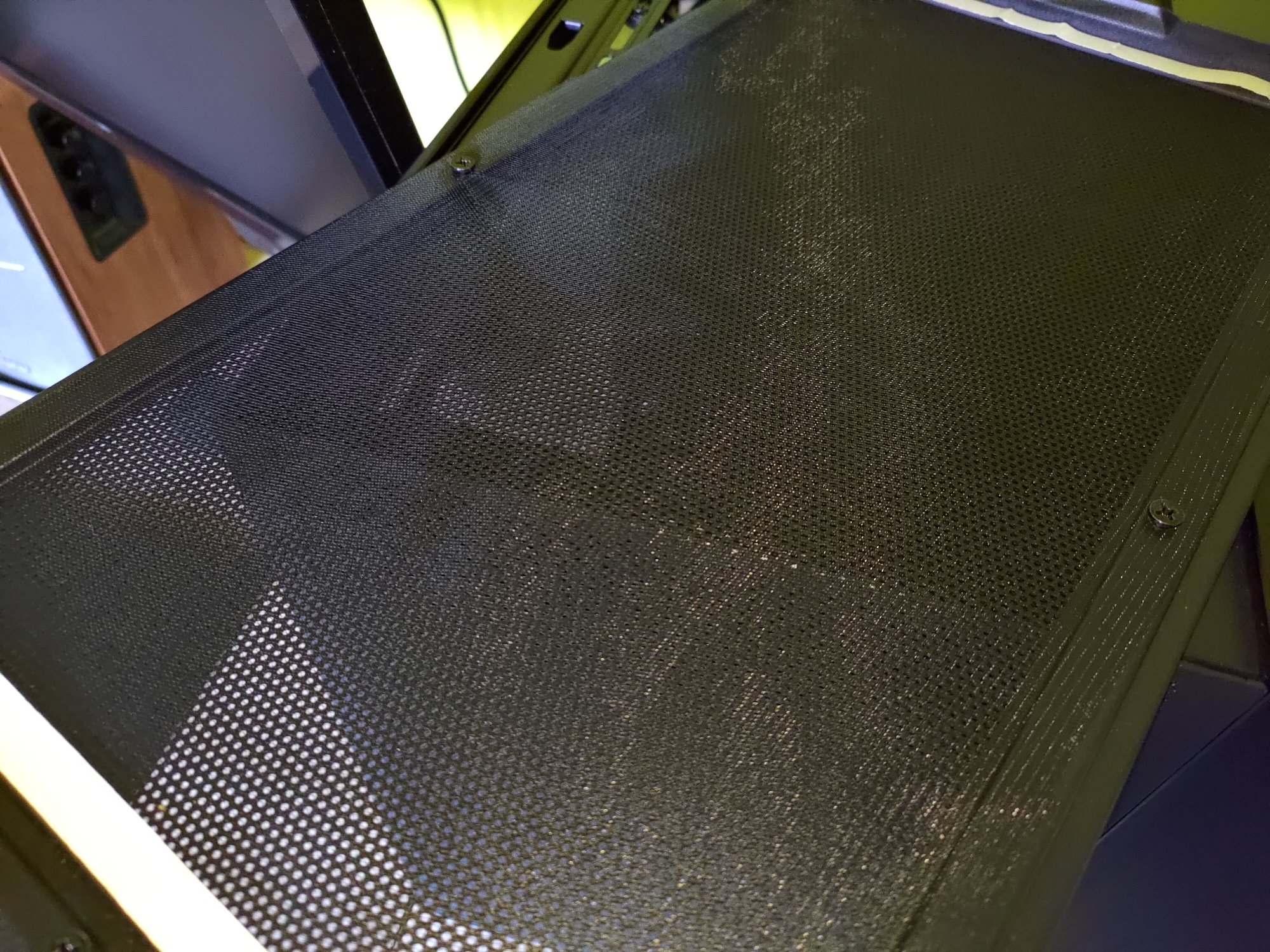

Whole case is very small, looks like microATX for first glance, however there is very much space for everything. I also made myself dust filters - I bought (sorry for not translating it) "Tiul" (made for making dresses) and "Fizeline" (for COVID masks) and for now I don't see dust inside of case. I highly recommend tiul for dust filters, and fizeline for (at least for me) covering pcie slot covers. I wanted to make sure air will come only from filtered holes.
So tomorrow i want to cut the rails for LED strips and finally place it in the right spot inside the case, for now its the only thing left to do. Maybe i conside changing dust filter for PSU for the one mounted inside, but that can be a problem, as my Dark Power Pro 11 is really big, and case panel is making contact with it all the time, so whatever i would decide to mount there would need to be very fit and strong.
Thats fleece i used for covering back of the case:
Thats tulle i made for main dust filters (that white stripes are magnetic tape - didnt needed to use glue, so i leaved transport tape on it):
Whole thing looks like this:
quick look for comparsion in size with Alta F1

Added additional feets, added dust filter on PSU panel (same as on rest panels - no need for magnetic filter mounted externally) and added LED rails with milky (Matt) plexi.P_20220330_135355.jpgP_20220330_135344.jpg
