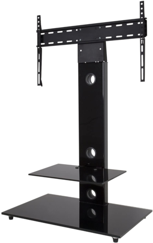

The raised stone slab in front of the fireplace caused a lot of issues. First off, using my previously acquired TV Stand, standing it on the stone slab raised the TV too high (eye level must be at center of screen when in normal of seated position). Modifying it by drilling some extra holes allowed me to lower the TV to a lower height.

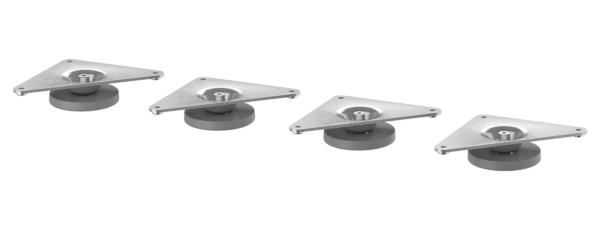

I also picked up some EKET Adjustable height feet.
So, the plan is as follows. The large felt protectors go on the center two "legs" and the adjustable height feet go on the outer two "legs".

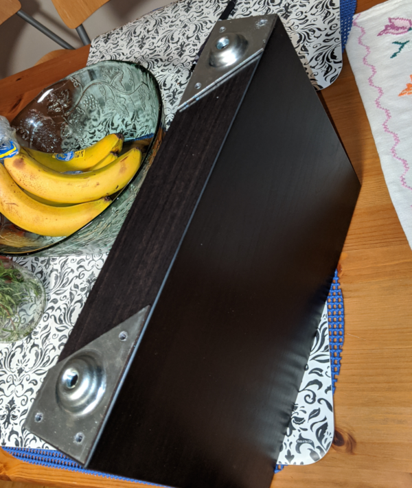

The shelves/legs are ~2" thick laminated particle board. The brackets are a ~3" x 3". Brackets are going to have to be modified.
I used my rusty old 50's to 60's era scroll saw to saw the brackets to size. Having just moved I was fresh out of cutting oil and had to improvise. I wound up using some Mobile 1 high temp silicon based car grease I had bought years earlier, and it seemed to do the job.
Now with the brackets in the correct size, they needed new holes (as I sawed off the old ones). My rusty old 80's vintage value brand benchtop drill press did the job.
Here's the result of the bracket:
Not perfect, but I am not a machinist, so I will settle for imperfect but functional.
