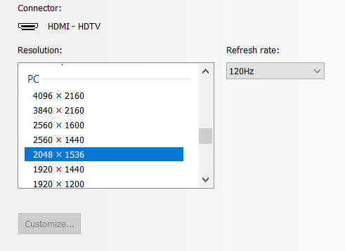

Wait. What? kasakka didn't you say in this thread that 3840x1600 @ 120hz works with the club3d adapter? This doesn't make sense. Why wouldn't 120hz work at this rez on an actual 3080 but work on the adapter with a 2080 ti?
I have absolutely no idea. All I did was just open the custom resolution box in NVCP running latest drivers, type in 3840x1600 120 Hz in its boxes and add it. No timing changes or anything. NVCP is also set to use display scaling, setting it to use GPU scaling might help as it would then create 3840x1600 on the GPU and output it scaled to 3840x2160 with black bars. Same end result pretty much.
Right I've tried all settings I can think of trying to create any custom resolution above 60hz and it just blanks out. I've tried different scaling settings in the NVIDIA control panel including having the GPU scale and the display. It definitely isn't a bandwidth issue as it should have clearly been able to handle that before the firmware update. Personal opinion is that it is a strange HDMI 2.1 to HDMI 2.1 issue between the video card and the display. If custom resolutions work with the Club 3D adapter, it's got to be DP 1.4 related.
Either way, awesome display but I am know I am in the minority where the custom resolution is a deal breaker for me if I can't get it working correctly... Shouldn't be this hard. The only other thing I can think of is when you create a custom resolution in NVCP, I think it is trying to set it in the TV mode where all the 60+hz refresh rates are under the PC list of resolutions. Not sure if there is any other way to do this.
EDIT: Ok, been trying a ton of different custom resolutions and refresh rate. I've found that regardless of ANY resolution I try, it's the custom refresh rates that make it not function correctly. Definitely not a bandwidth issue or even a resolution/aspect ratio. Here are the list of settings I have tried, all result in a black screen
  • 2560 x 1440 @ 75hz
  • 2560 x 1440 @100hz
  • 3840 x 1600 @ 75hz
  • 3840 x 1600 @ 100hz
  • 3840 x 1600 @ 120hz
  • 3840 x 2160 @ 75hz
Yet if I choose any of the precreated resolutions/settings, they are work with the scaling settings in the NVIDIA control panel such as 2560x1440 @ 100 and 120hz, 2560x1600 @ 60hz etc etc.
EDIT: Ok, been trying a ton of different custom resolutions and refresh rate. I've found that regardless of ANY resolution I try, it's the custom refresh rates that make it not function correctly. Definitely not a bandwidth issue. Here are the list of settings I have tried, all result in a black screen
As a final solution I would try reinstalling drivers with the clean install option in case there is something weird going on.
The other option to define custom resolutions is Custom Resolution Utility but it's also an easy way to end up with no image. If you have a FE card then having only one HDMI port is going to be a problem here as with two you can just toggle to the other one and run in extended mode to fix issues if one screen ends up blank. If you have another monitor you can connect then you could try CRU. I don't know which section you would use to define the custom resolutions, probably need to add a DisplayID block. In my experience CRU vs NVCP is no difference in behavior though.
Just tried this with the latest drivers, clean install and I even switched to the other HDMI port on my 3080 for kicks. No difference. ANY custom resolution, even 3840x2160 at a rate higher than 60hz, results in a black screen.
Did you try to reset the TV? I can't get custom resolutions working either (3840 x 1600 @ 120hz), but 120hz 4K works fine.
