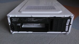

The cardboard box prominently displays that this is indeed a white case.
And it is. I expected it to be smaller. It looks quite long. Not a well laid out case this is.
Even the thumbscrews are white, that's unexpected attention to detail. The fit of the covers isn't that great though.
Delving inside we find the vertical stands and the other parts. The stands are abs plastic with rough bits were they were attached to the mold. You find nothing by removing the bottom cover. Guess it's only for access to the backplate.
The 3.5/ 5.25 drive bracket is removable by two screws. The front panel cables are long enough so they can be routed anywhere inside the case without having to go straight across the MB. That's a big plus.

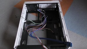

The MB could be barely squeezed in next to the PSU, and they skimped on standoffs, I had to add one from my reserve to be able to install this micro ATX board.
And this is what it looks like when you give up on cable management. I just threw in the HDD and the SSD on top of the loose cables as there is literally nothing to attach them to without the top bracket.

I removed the 5.25 bracket and tidied things up:
