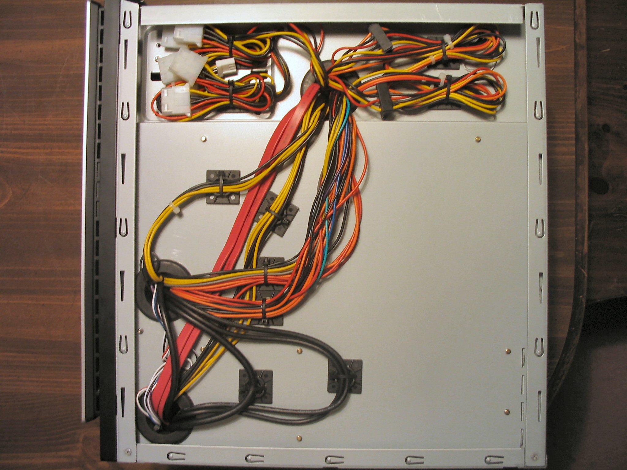

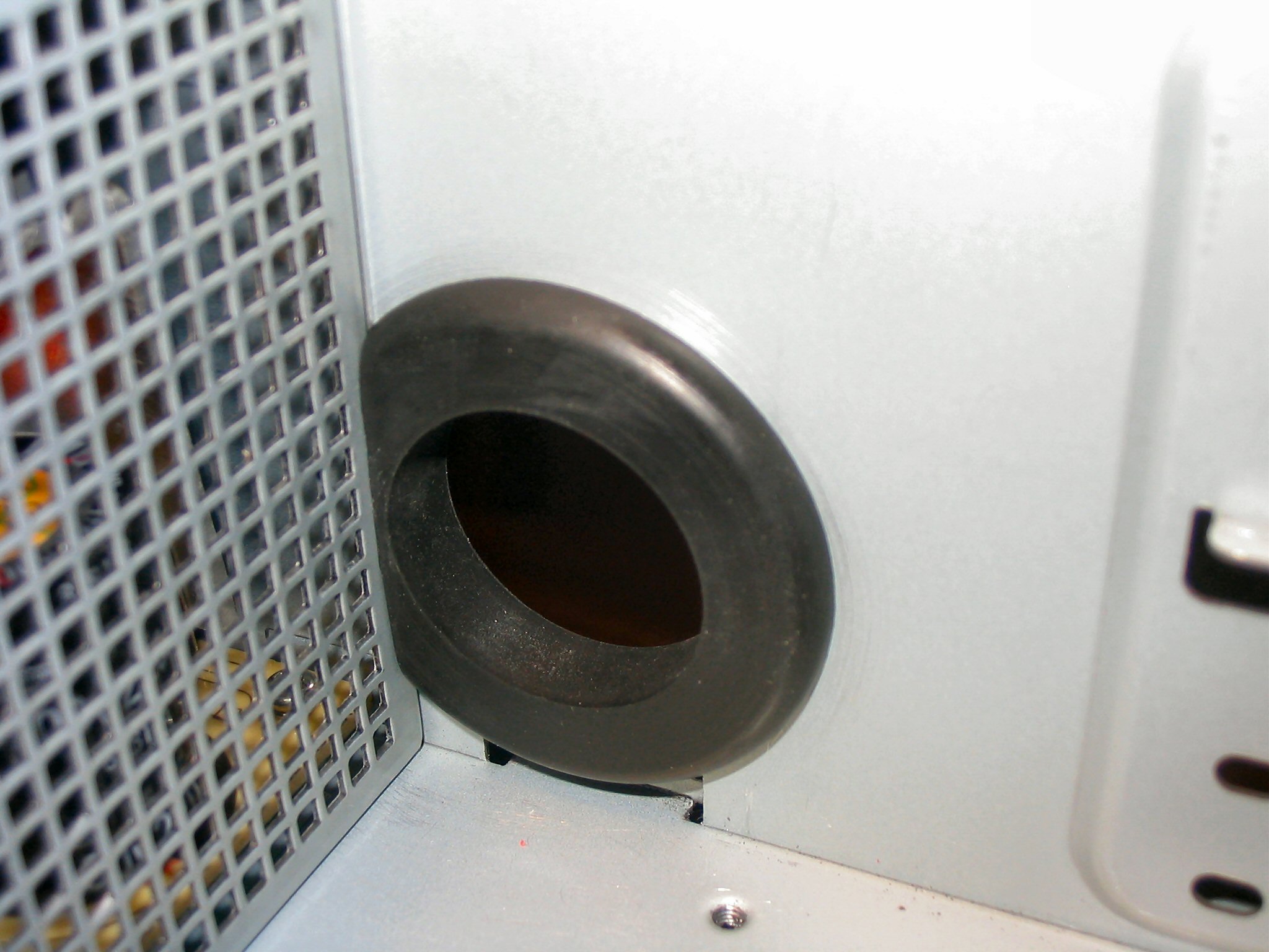

To cut the holes, I went with a method detailed in a few other mods on this site. I used a 1 1/2" bi-metal hole saw mounted in my drill and used WD-40 as "cutting oil". The biggest problem with this method is that the drill "walks" around and makes the hole larger than you originally intended. I drilled a small pilot hole first to make sure it was centered, but during the drilling process, the guide bit in the center of the drill widened the center hole and resulted in the holes being less exact than I would have liked. Someone suggested drilling a 1/4" center hole, then replacing the drill bit in the hole saw with a 1/4" rod of some sort so that it doesn't cut into the sides of the hole. Regardless, I am not really pleased with how the holes turned out and the next time, I'm going to use my trusty sheet metal nibbler to cut the holes and a dremel or file to finish them smooth. Sure, it takes a lot longer, but it's far more precise and actually a lot less messy.
After searching for trim for the holes and not really liking anything I saw, I had a flash of inspiration and decided to search for rubber grommets. The ones I found worked beautifully and my only complaint is that they're a little thicker than I would have liked. The thickness makes it a little harder to get the wires to lie flat on the back side of the tray but it still worked out well.
When I decided to use the grommets, I knew that the clearance by the power supply was very tight so I deliberately cut the hole close and planned to trim the edge of the grommet to fit. If I went farther toward the front of the case, the grommet would have intruded on the optical drive space and I would have had to hack an ugly chunk out of the edge of the grommet to make it fit. By putting the cut edge against the power supply, it's a lot cleaner.
