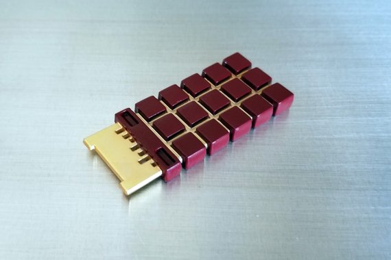

Here is what a compute stick looks like....
