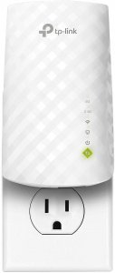

Probably stupid questions, but here goes it.
Got the Router/Modem on one far side of the house. Opposite side of the house has nothing.
Do I just plug this:
https://www.amazon.com/TP-Link-AC75...56504&sprefix=wifi+range+,aps,169&sr=8-3&th=1
into the wall somewhere near the center of the house, and that's it? No need to run cables or anything?
These things actually work or are they gimmicky?
Thanks.

WiFi extenders are mostly crap. It might be worth a shot, given the relatively low cost, but don't be surprised if they are flaky and cut into your usable WiFi bandwidth. Be sure to buy from somewhere with a decent return policy.
Is it at all possible to run an ethernet cable to the other end of the house and set up a proper access point? That would be the best solution.
Do you possibly have coax for cable TV (not satellite) near the existing router and the other end of the house? MOCA adapters could be used to extend the network to the second AP location.
Similarly, powerline ethernet adapters are another option. Some even integrate the WiFi AP.

TP Link RE450 here and working fine for about 2 months
Not sure what "cutting into your usable wifi bandwidth" means but the way this one works is that it just creates new SSIDs that you use instead of your original ones

AC1350 jobber showed up today. I think I have it all fingered out. I named the two SSID off the extender the exact same as the router. I read that's the way it should be setup. Went out to the shop and still had four bars. Kiddo's room the same. Hard to tell with the SSIDs being the same, but it looks like its connecting just fine.
