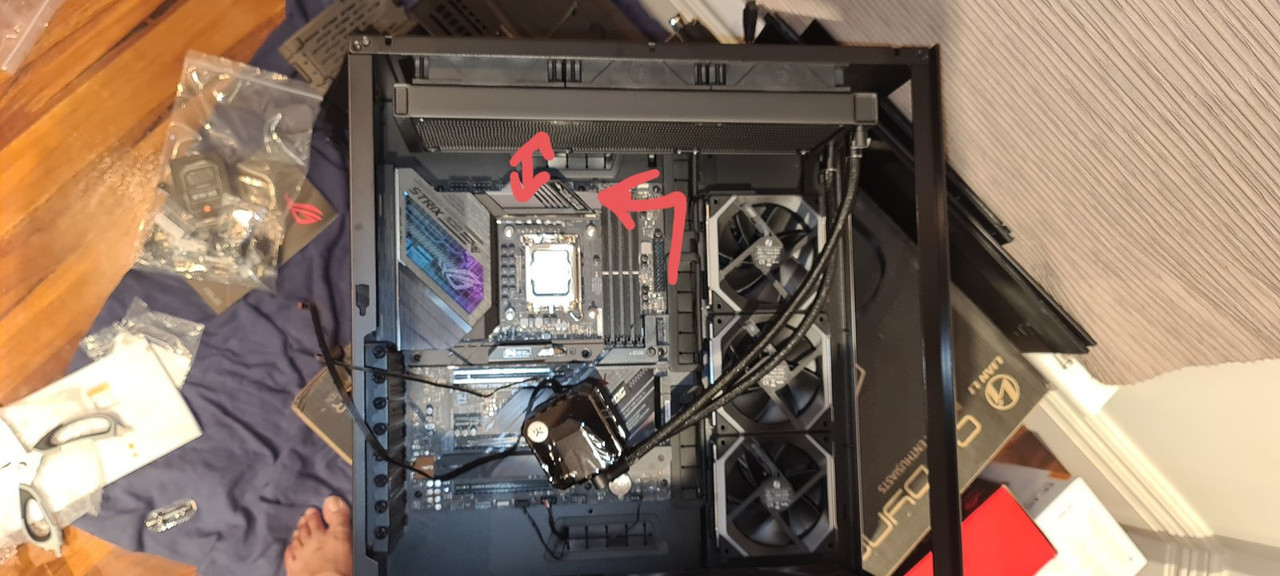

Has anyone else got this same setup?
Z690 STRIX E
Lian Li O11 XL dynamic
EK 360 ELITE AIO
Hit a road a block on my new build.
I am trying to install a EK Elite AIO 360 in a push/pull config on the rad as a top mount on the O11 XL dynamic case. But I cannot fit the LianLI UNI120 fans on the bottom of the rad, because there is not enough clearance between the Z690 STRIX-E motherboard heatsink and the EK360 rad at the top. Please check pic.
Has anyone managed to install this push/pull setup at the top with this exact same hardware, or do I have no choice but to use only 1 set of fans in a push or pull cpnfig, or move the rad to the side mounting position on the O11 XL Dynamic case if I insist on push/pull?

I don't have your setup but you don't seem to have a choice but to side mount the radiator. You at least have that option without having to get a new case.

Are there any lower profile 120mm fans that I could place uptop to obtain the clearance needed?
I only need maybe 1-2mm more clearance, it almost fits in as is.
EDIT:
OK just found slim 120mm fans, all good. Will need these. Now just gotta check out some reviews if they are anygood.

Push pull really doesn’t net much gain. There are plenty of tests showing this. Using mid matched fans on a push pull setup would almost certainly not have any advantage.
Mount it on the side if you are convinced you need push pull.
Dan_D
Extremely [H]
Feb 9, 2002
60,280
There is no need to use a push/pull setup on an AIO radiator. They just aren't thick enough to benefit from it. I've tried it many times over the years, pretty much using it exclusively until I had heard it didn't matter. Sure enough, I tested it and found no benefit to doing it.

This 1000x. Listen to this experienced man.

Ok fair enough then.
I guess i will just go with one set of the lian li uni120 (3x) exhausting the EK ELITE AIO at top mount.
