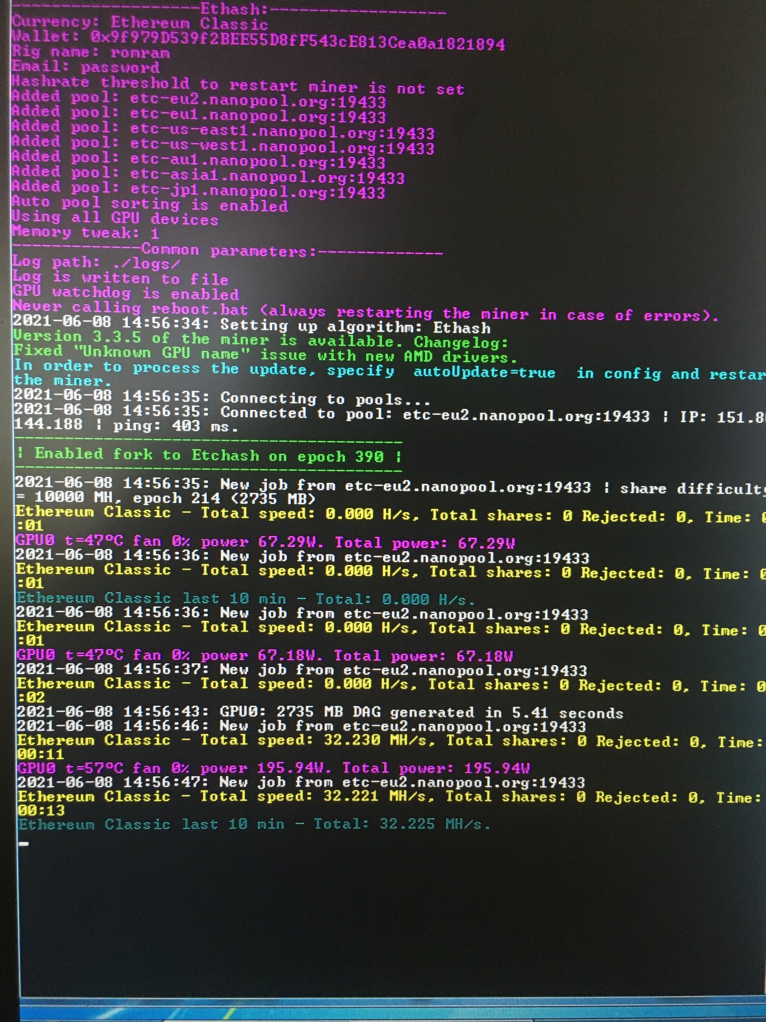

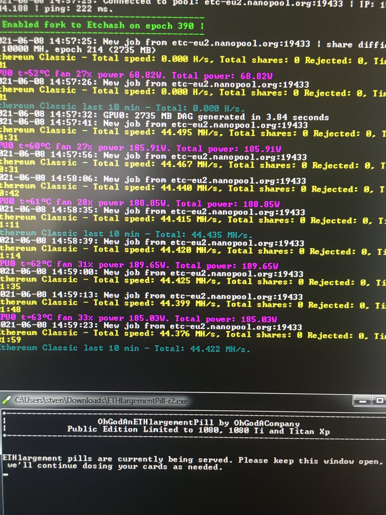

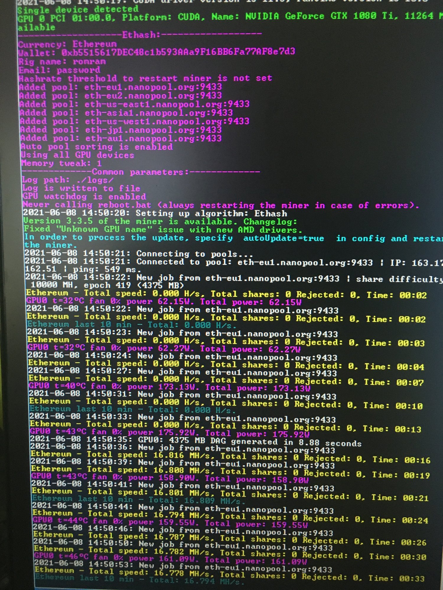

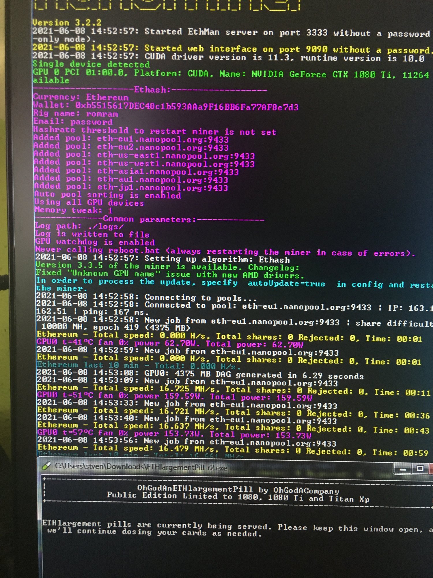

Hello. I was able to buy little overpriced asus strix gtx 1080ti 11gb. I was planing to ad it to my ETH rig but when I’m trying to mine eth Im getting like 16mh/s ?? When I go to etc I’m getting 45-50mh/s. How to make it to mine eth with normal speed ? Any idea ?

so anyone have any idea why my ETH mh/s is only 16 and other coins normally?

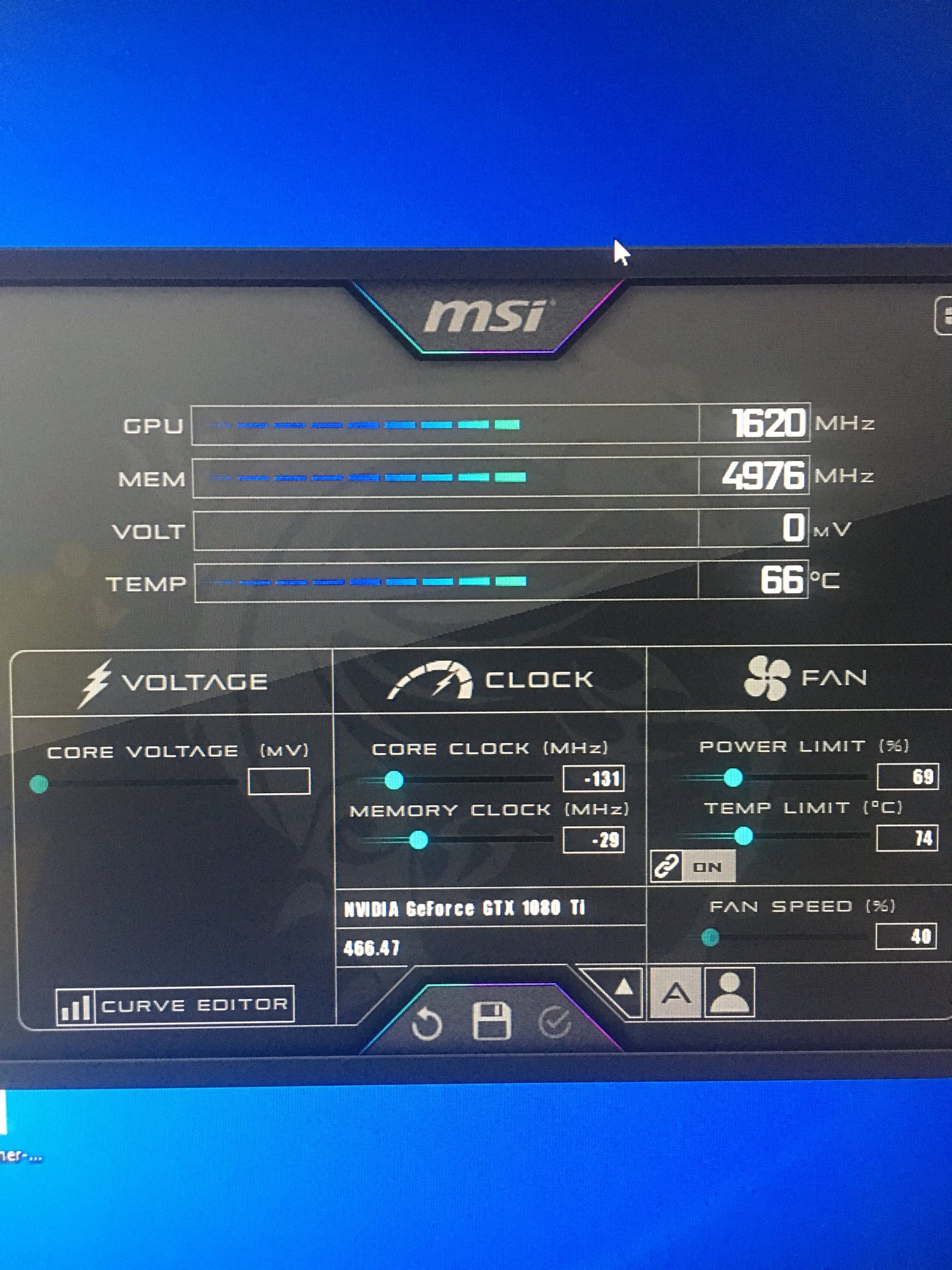

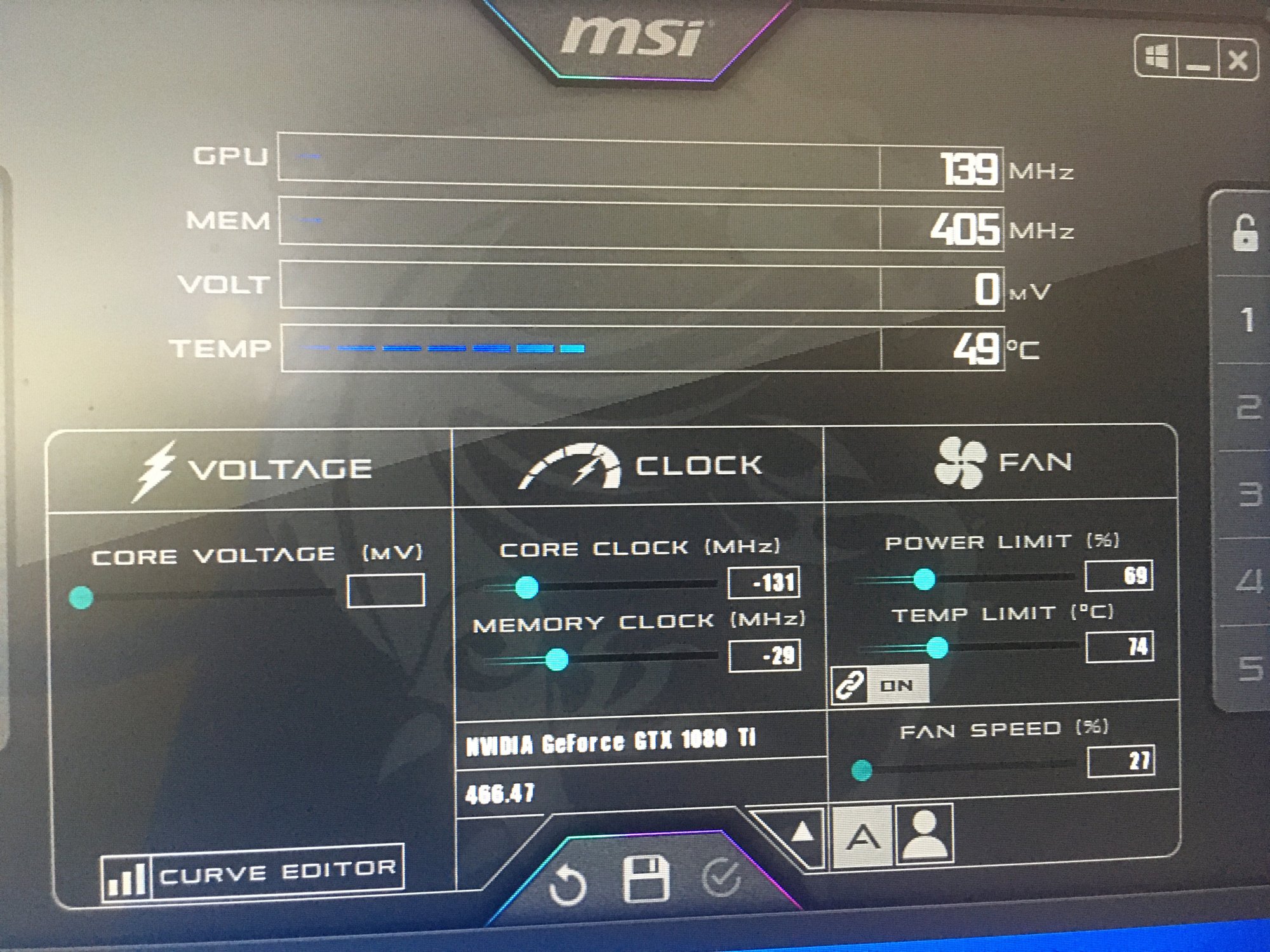

Add a screenshot of MSI while mining, that looks like you did it at idle. Also why are you running a negative offset on the core and memory?

Pic taken after mining etc 12h

I'm at a loss. I tried your settings on my card and they operate at normal levels (a tiny bit higher than my normal rate, at the expense of more power draw to offset the lower clocked memory.) Try throwing a positive overclock to the core & memory (like maybe +25 and +200,) just to see what happens. All I can think of is the negative is doing something wonky. If not that, then I am suspecting your mining software is configured in an odd way or just can't mesh with this card. Might try another software to compare against.

Changing values on settings does nothing at all. Still getting 16 mph/s on ETH:/ and I have negative clock on all my cards : 2x gtx 1070, 1x gtx 1070ti, 1x rtx 2070. I like keep my rig quiet 🤫 and under 64 degrees.
did try Phoenix miner but I have the same errors. :/
