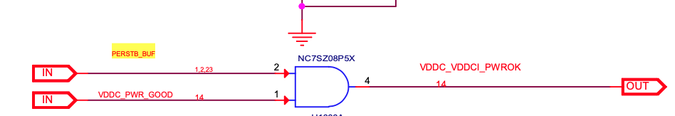

3.3Kohm , since i replaed them there still intact. I made some progress, well i hope so. I look at schematics and i found that im missing a signal at one input of an AND GATE which is supposed to send a high state (0.3V?) to the PHASE controller in order to start the graphic card. But in my case, PERSTB_BUF still low... don't know where it is supposed to come from yet.
Found this also : https://vlab.su/viewtopic.php?f=48&t=121971
The guy said by changing the U1000 (AND GATE), it did recover the PERSTB_BUF (3.3V)...
