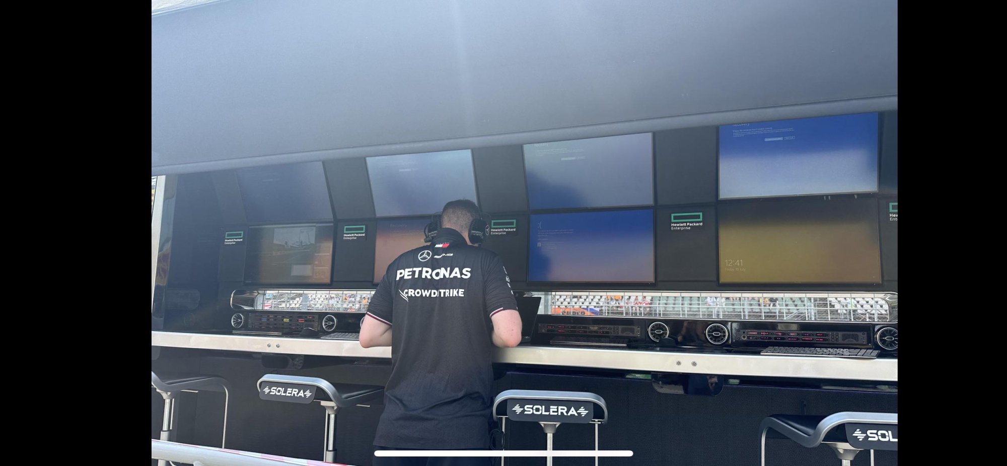

When worlds collide…poor merc team…at least crowdstrike is paying them
