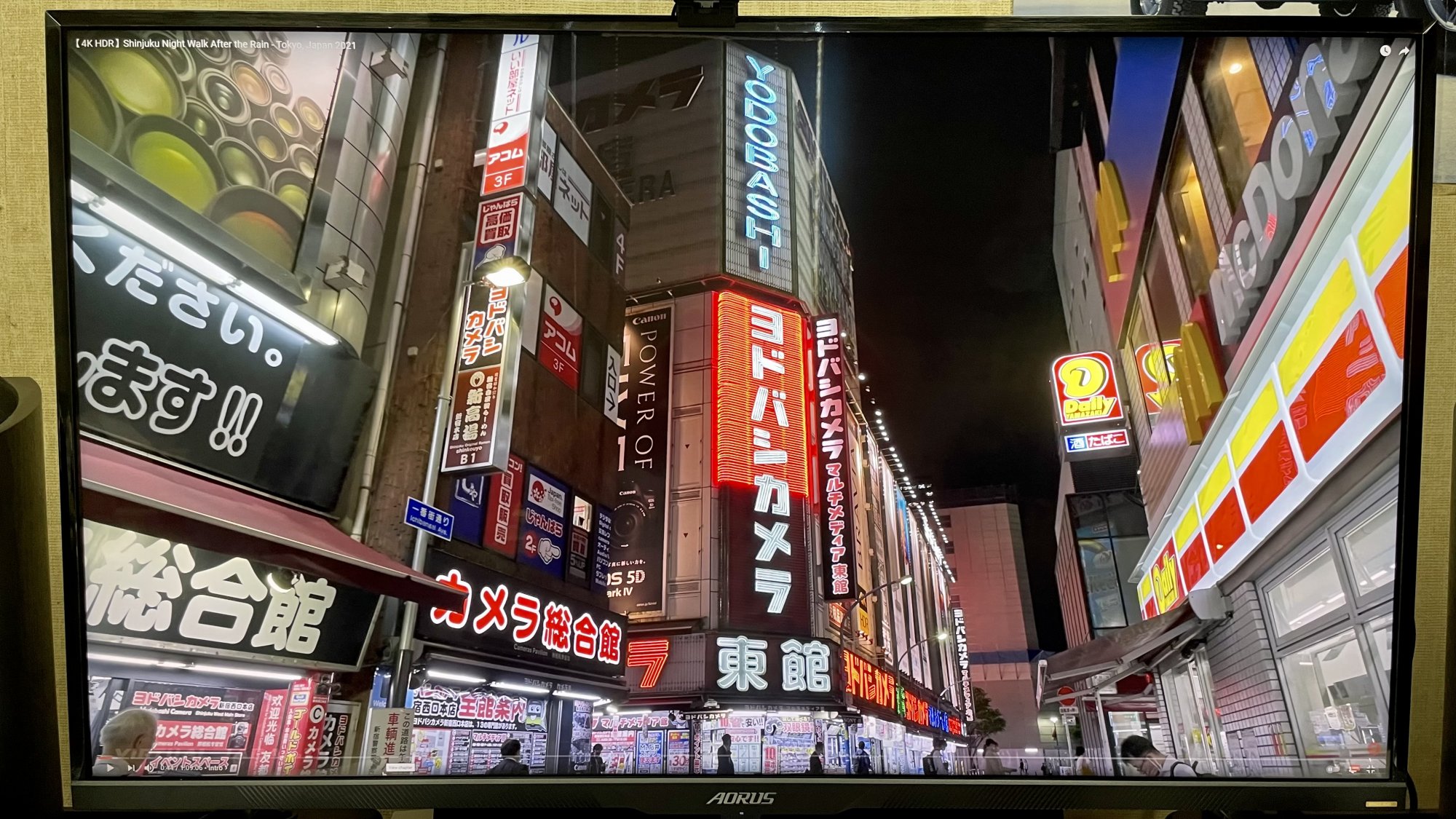

My office is fairly well lighted with light coming from a window to the side and one to the rear with overhead fluorescent lights and the color still look pretty great, better than my Acer CG437K out of the box. Mass Effect Legendary Edition running 4K@144 with HDR, Shot on a iPhone 12. Only gaming pic I have at the moment. Will try to take a few more shots when I get to the office. Anything you have in mind like a particular 4K HDR video on Youtube with a time stamp?
Wiz33
May 2, 2015
815
OK, Here's a few shot from some of the most popular 4K HDR clips on Youtube shot with my iPhone 12. Bright line around the upper center is the outline of the window directly behind me. The iPhone also muted the color a bit as the pictures were not as vibrant as the ones on screen. I did some adjustment and its now closer to what you'll see on screen but the one on screen is still a bit more vibrant

It's still a VA so that's a concern but it's actually better than my CG437K, I'm older and actually need the screen real estate when I work so I don't use font scaling at all. I sit about 30" away and I can see a bit of minor color shift about 1/2 to 3/4" on each edge and If I move back to about 36" (my viewing distance when I sit back and watch media), then it's maybe the 1/8" to 1/4"on the CG437K and I don't really notice it on the FV43U, If it's there at 30" it's much much less noticeable. I doubt you'll notice any if you normally sit further away.
P.S. The photos above are all take at my normal viewing distance of about 30"
