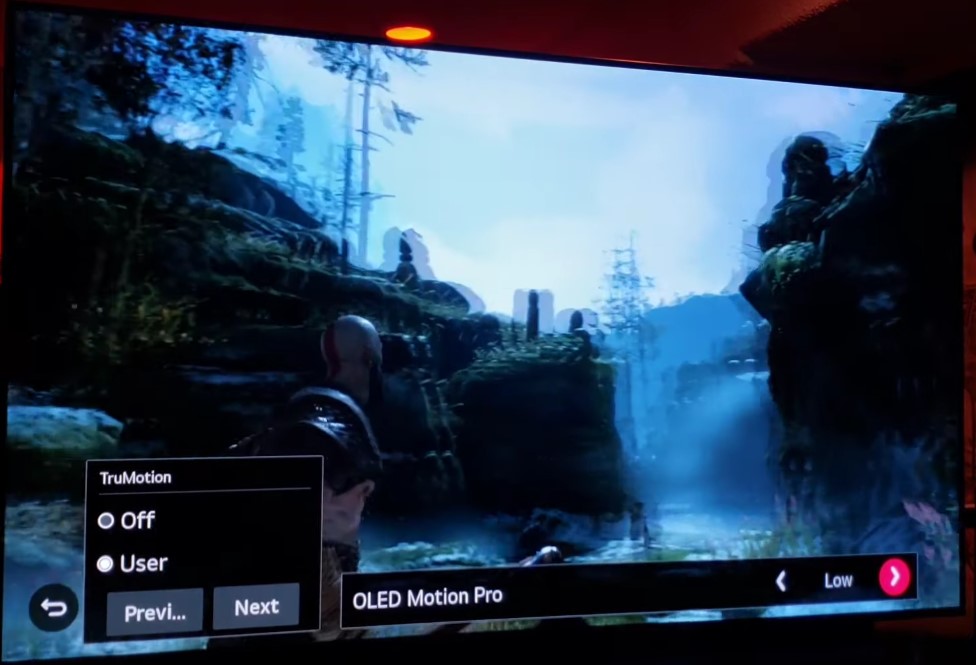

I bought an open box 42" LG C3 for $630 and I'm happy with it- much superior PQ compared to the FV43U. I did buy the 5yr Geek Squad warranty (covers burn in) for $125 just in case- so I really don't have any issues using it as my daily Win 11 driver. If it burns in they'll probably just give me a refund.
