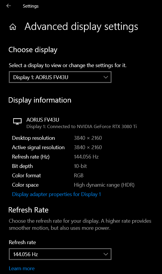

I'm still the same, I have no idea what's going on. I'm waiting for Gigabyte to answer me.
I don't know where the fault is
I must be waitting a update of Fv43u or GPU

you can just use HDMI 2.1 with your GPU, activate Gsync (it is activated in you Screenshots) and the go for Windows variable refresh rate, its way the same
With HDMI 2.1 is the same that Display port.
I must be waiting newer drivers standard from Nvidia.
Thanks

For someone who actually owns/owned the monitor. what cable got you to 144Hz at 4K? A sole HDMI 2.1 cable?
sethk
May 3, 2005
2,011
Same here re: DP cable - running this at 4k144. I also used a HDMI 2.1 connection for testing but disconnected it after a bit, since I need the HDMI output for a second display.
