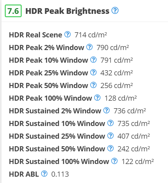

What's HDR real scene brightness?
In the picture a few posts above, only 399cd/m2 vs 714cd/m2 on the C1. Almost half as dim in HDR real scene brightness, don't think that's just "panel variance" either as that's too extreme.
Edit: Sorry if you were asking what it is, this is the description per RTings:
What it is: The maximum luminosity the monitor can obtain while playing a movie or while watching a TV show. This scene was selected to represent a more realistic movie condition. All measurements are made with the monitor set to be as bright as possible, but with a 6500k white. Measured with local dimming, max backlight and over HDR signal.
When it matters: When watching movies or watching TV shows in HDR.
Good value :> 550 cd/m²
Noticeable difference: 80 cd/m²
Yeah that's actually kinda pathetic relative to the C1. Why did Gigabyte lie about the peak brightness on the official product page?
Probably some BS snake-oil test such as a <0.1% window reading. Kind of like how the 2% window # goes up to 611cd/m2, but is unrealistic for 99% of all use cases.
