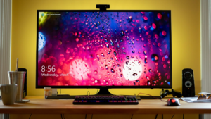

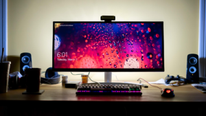

So, here's an unexpected update: in the past few months, I've been getting insane eye-strain, to the point that it's been making it hard to work home. I switched to an LG 29WK600 back in October 2018 (and I really liked it too), but I soon started to get dramatically worse discomfort. I don't think the LG uses PWM, but I can't confirm this either. Could it be that something in my eyes is too sensitive to the LG's lamp? I tried everything: lower/higher brightness, environmental light, and a long etc. but nothing made it better. Maybe IPS's limited 1000:1 contrast was messing with me after years of being used to 5000:1 VA panels?
I finally gave up today and switched back to my 40" 4K Samsung KU6290 TV and I "think" I'm already feeling better (it's been less than an hour, so who knows... the real test will be after a couple days to weeks). My eyes seem a bit more relaxed though, that's for sure. It's hard to explain but I feel less "tension" in my head/eyeballs. There's a significant change now that I've stopped using the LG, I just couldn't handle it anymore, I felt like I was going to go blind in a few years at this rate.
I'm curious to hear opinions and similar cases from [H] users, as I know many of you have had similar problems changing monitors.
Here's the LG:
And back to the Samsung:

Tension to me suggests one of two things, either the brightness is too high, even something like f.lux might help a lot with this
My other thought is you're squinting because things are too small. Good luck, at least you have a working solution in the meantime.

With the the LG you lost a significant amount of viewable area and workspace due to the smaller size and lower resolution despite the wider aspect ratio. You even lost a bit of PPI going down to the smaller monitor which is worse. Going from a large to small screen the uncomfortable feeling it engenders can only be described as claustrophobia as your eyes strain to see beyond your newly narrowed field of vision.
It can only really be remedied by the smaller screen having some qualities that the larger would not possess such as a drastically higher pixel density or greater color reproduction and contrast, but your new LG is objectively worse in the first category and arguably inferior in the last.
I don't see any great benefit to keeping your ultrawide when it is only empty space you are saving above and on either side anyway. I can attest to this having gone from a large 4K display to progressively smaller monitors that are way faster and have some better features but still feel like tiny viewports compared to the panoramic visage of a 4K TV, but if you were already used to using a large format display it will be the same.

Turn the brightness way down!
Check the refresh rate make sure it’s not doing something inexpected like 30Hz!?!
Fiddle with contrast?
Put more natural colored light sources in the room.

I've been using the monitor at %10 brightness because anything else would burn my retinas off. I'm surrounded by giant windows with natural light, I have bias lighting behind the screen, and I've even turned all the lights on. Nothing would help, even messing with contrast and other parameters. Framerate was 75hz. I've done all the things you "should" do to fix eye-strain, which is why I was so puzzled nothing was working!
The fact that things are way smaller could definitely be a factor, although I usually zoom in a LOT and make Chrome take the whole 21:9 space. But yeah, this theory might have some legs. I wanted the 75hz and freesync, but it just isn't worth it if my eyes are going to hurt most of the time.

It could be as simple as the smaller screens text is too small.
And/or you were sitting a bit further away from the larger screen making it easier on the eyes.

I too am starting to think this may have been it. It just feels incredibly obnoxious to say "Yeah, I can't use anything smaller than a 40" 4K monitor" (with a #middleclassproblems after it :D). It does make sense that after being getting used to that for 2+ years, my eyes are now saying NOPE to making the effort to look at a smaller 1080p monitor.
