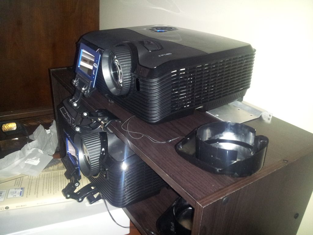

Im doing three Asus VG248QEs with stripped bezels, removed AG coating & the 2D pure motion lightboost hack. This is the best display setup that I have every owned and I have owned many
Former setups:
2 Overlord OC 1440ps
Double 1080p projectors for true 60hz 1080p 3d per eye
