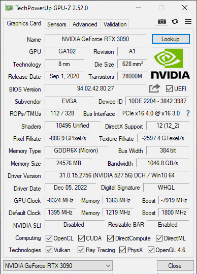

Why does GPU-z have negative/incorrect numbers for clock speed?
I'm currently running a BIOS which was not intended for this card, which is why it's reporting incorrectly. I tried BIOS from XOC, kingpin, as well as third party 3090 BIOS.
