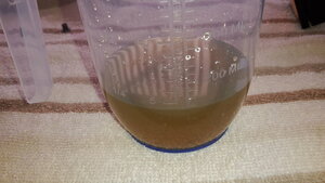

Its taken a while to get this posted but I pulled my 360 apart back in march when i was off work. The disassembly process was easy, hats off to gamers nexus for their tear down video on this.
Colour of the fluid when i drained it all:
Now according to the video there should be over 200ml of fluid in the 240mm version - I drained 150ml out of my 360 and several chunks of paint and solid matter.
