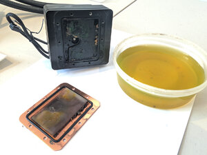

Whelp, so I did it. I did a teardown of the Liqtech TR4 that I replaced after failed cooling performance on my threadripper:
I figure I would do my best to clean it to see if it's salvageable at all. I used an old watercolor brush & alcohol on the copper fins they were so narrow:
The main housing was horribly corroded, I used a bamboo skewer to scrape off some kind of encrusted residue. Whatever the issue, it had actually eaten into the metal block. I don't have any kind of material knowledge with this stuff, if anybody has an idea what the issue might be I'd be interested to hear it. Also wondering if it's worth salvaging this unit at all. I have another Liqtech II that was failing, and a third unopened Liqtech II that I received recently. I plan on opening all of them and taking a look. Is this a coolant issue? Could replacing the fluid in an unused unit prevent build-up and corrosion?

Any jelly like substance in the cooler? If there was it would suggest a lack of a biocide to kill bacteria build up.
Not sure if anyone has swapped out the fluid - may something to try out, see if temps drop back with the new fluid and report back to everyone
