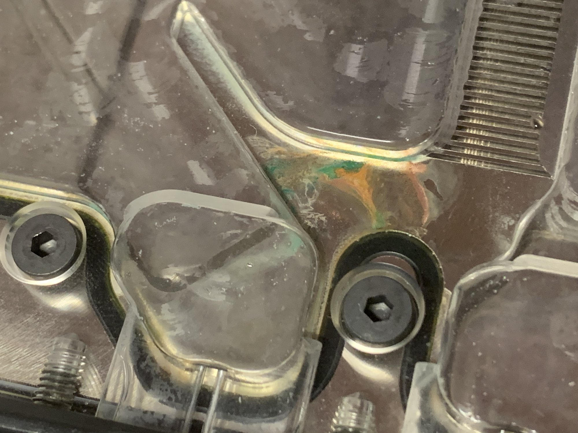

I think I’m calling it quits on EK.

I did some further inspecting and there’s a lot more corrosion. It’s literally all along the rubber gasket that goes around the perimeter of the heat exchange/water chamber (whatever that’s called). It seems like maybe the nickel plating didn’t take too well along the CNC’ed channel or something.
To EKWB’s credit, they replied to my RMA email within a few hours and offered to send me a new GPU base and expedite the shipping.

Did you mix metals? Aluminum fittings with a copper block or the other way around?

Nope, no mixed metals (other than nickel and copper). The Predator 360 has a copper radiator, the MX block is also copper, and the fittings are EKWB nickel (ZMT tubing). The system ran for a couple years flawlessly with that setup and a copper ekwb Titan X block with no corrosion or build up (using their previous Ekoolant Evo clear). I didn't have an issue until I swapped in the nickel 2080ti block. Looking at the block, it's pretty clear that it's a plating failure and not corrosion. The plating all along the perimeter of the heat chamber where the rubber gasket goes is just bare copper. I pulled the CPU block apart in case there was gunk or corrosion in the jet plate, but it looks perfect.
The previous leak from the Predator 360 was a known issue. They recalled all those units and replaced them with revision 1.1 units. The disintegrating vortex sponge was also a known issue caused by degradation from the warm, pressurized coolant.
In any case, the system is up and running with the Supremacy MX CPU copper block, Vector 2080ti nickel-copper block, XE 360 copper radiator, FLT 120 res/d5 pump combo, and Mayhems Ultra Clear tubing with quick disconnects. :)

Just glad your system is back up and running. Did EK follow through and replace parts?
Yea, they shipped me a new nickel plated base to swap in and a bottle of coolant. :)
EK’s customer service has always done right by me for the most part, it’s just the amount of issues I’ve had with new parts from them. I’ve dealt with EK’s RMA department 3 or 4 times in the last decade. The only other RMA department I’ve had to deal with in that time is Thermaltake for one of their PSUs that died in a build I did for a buddy.
First my Predator 360 leaks. Then the vortex sponge on my new Predator 360 disintegrated and clogged up my GPU and CPU jet plates. Then they sent me a pre-filled 2080ti Phoenix block with no coolant in it. Now the nickel plating on a three month old block is flaking off. I only noticed it because I just picked up an EK XE 360 rad, EK FLT 120 res/pump combo, and EK Connect 51 to replace the Predator... But now I don’t even know if I want to install them.
View attachment 234969View attachment 234970
That happened on my 1080 block also. I thought it was due to me running g sysprep in the loop. I scrubbed it off down to the cooper in some places. Was an eyesore for sure.
thesmokingman
Nov 22, 2008
6,229
Back in the day I sold a pair 580s with waterblocks. I advertised them as pre-corroded so you don't have to worry about it. 🤞
Jokes aside, the plating corrodes sooner or later, ek, koolance, or x brand. I don't buy plated blocks anymore... unless the bastages don't make a bare block which happens a lot with EK.

IMHO. I am a retired director of a characterization research center with a specialty in Analytical Chemistry. I used to do metallurgical failure analysis for some industrial clients. The problem is even with a QC certificate what metals/alloys the customer thought they had were often not the case and would fail. Just because the radiator/water loop part says Al or Cu this may not be true. Can't tell by looking, electrochemical /corrosion process are complex and not fully understood. For example steel can look ok to the naked eye but when Hydrogen embrittlement advances it will catastrophically fail. See photo below of so called QC verified Pacific Rim sourced steel. Counterfeiting and deception is not solely based to graphic cards, etc.
Electron Microscope Image
Section of collapsed tower
I dont get it, whats wrong with this image?
Soooo you're gonna buy pure metal blocks of only one specific metal type? Like a pure copper block or pure silver block?
