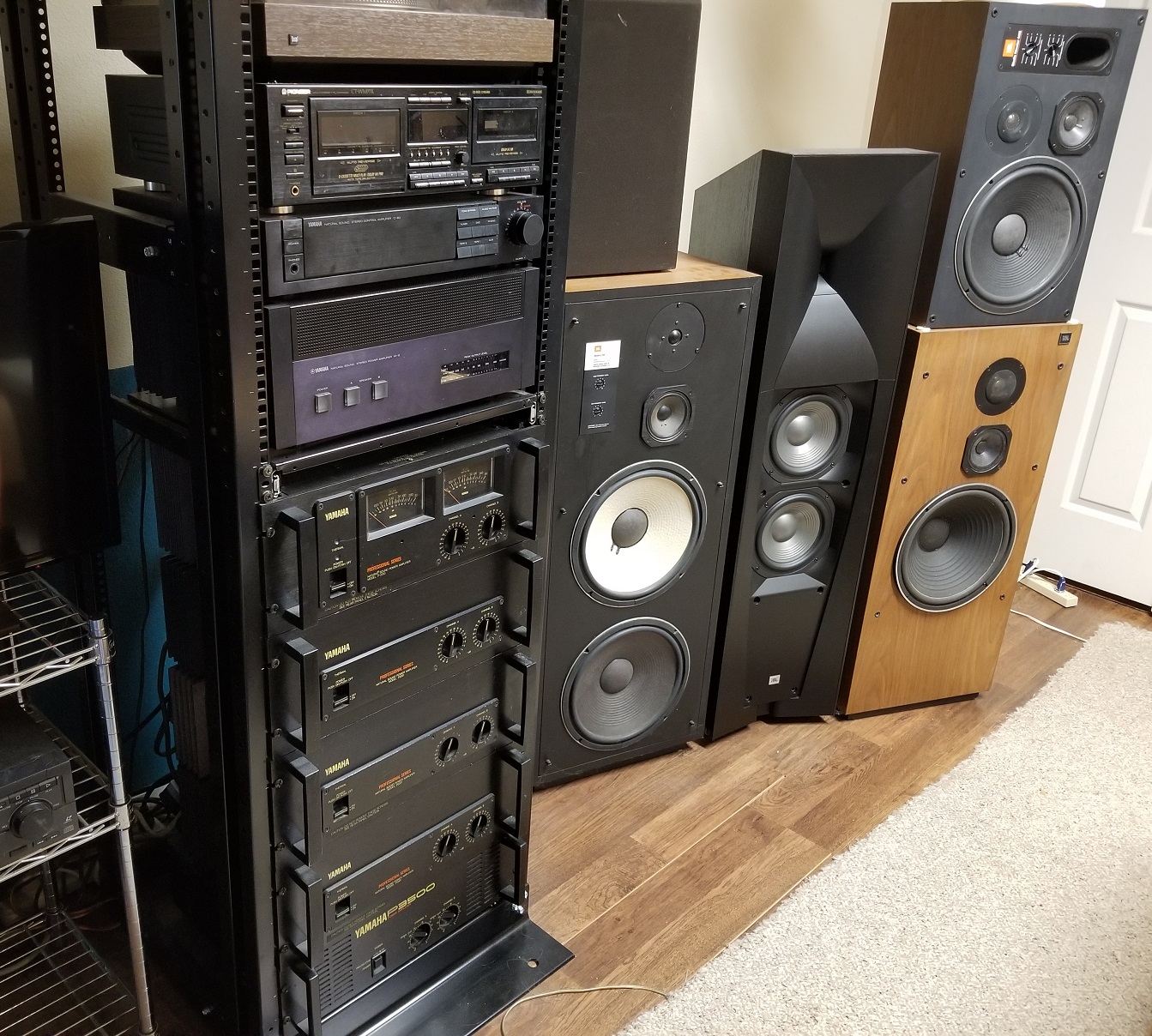

I primarily use my 20+ year old Alesis Monitors, I do have a pair of Sennheiser headphones but I hardly use them.
I still have an ACM from my old Soundblaster ZX so I could use that as a Mic as I do use the ZxR's ACM as a mic when I play games.

With speakers you probably won't have much difference at all. I think the ZxR is limited to 5.1 vs 7.1 on the AE-9, but it does apply to you since you are using stereo speakers.
Thats a pretty cool looking setup by the way!
