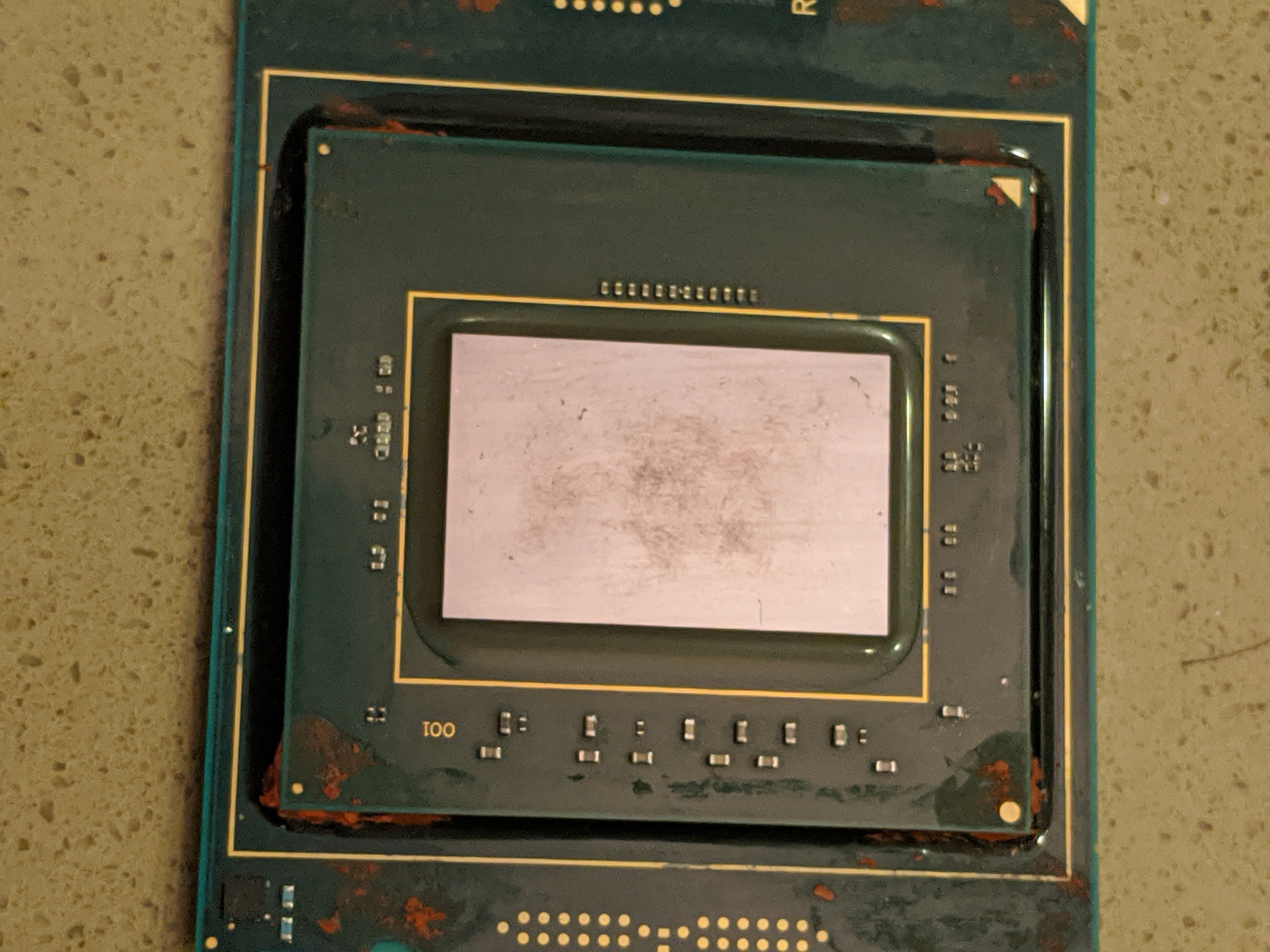

My current theory and why Im looking for a pinout is because the CPU had damage on one of the gold pads. It basically flaked off! First time anything like this ever occurred. I have visually inspected everything else and all seems to be in order except the damage mentioned above and also the "problem" listed below. Always possible I damaged something on the top side during delid as well but I checked pics and it didnt indicate damage unless its not visible.

Picture of the topside in case an eagle eyed reader can see damage I cant.

bump for pics added... feel like Im grasping at nonsense... the "damage" was worse in my mind from when I remember it. Most likely cause I have the zoomed in pic in my memory.

So judging based on the pic it looks like there is a bit of a pit in that dark area and it looks to be where it depresses the pin in the socket. IIRC the memory stuff is on the sides and not the top and bottom but im not entirely sure. So at this point id agree the issue here is the CPU. 7820x are super cheap now(250-350 on ebay) so you can easily replace the CPU and put it back in service if you wanted.
If it was a more expensive chip to replace like a 7980xe id suggest hitting up der8auer and he could fix this but with it being such a cheap chip its likely not worth his or your while to fix.

The problem pins have to be power pins that have had too much power delivered to them over a period of time and as such are working as resistors due to residue buildup. Try wiping (carefully) with isopropyl alcohol to remove the buildup.
So can I just dunk this into 99% alcohol and call it day to see if that works? I dont see any buildup on my cpu side really but could always try if that is a possibility.

I would suggest you put some iso/99% on a cotton bud (sometimes called Q-tip) and use that on the affected pads

Solder a drop of gold solder on it. Good as new.
But you'll need an HHO gas torch haha
https://www.amazon.com/Gold-Repair-Solder-Gauge-inches/dp/B07146PVRS
Or just use some PbSnAg blend and a 25 watt micro iron and a flux droplet. Do a micro droplet. It will work good. Use nail polish to protect the other pads so the flix doesnt flow the solder together between adjacent pads. Dont use flux core solder.

Oh wow I didnt know that existed to be purchased by a consumer! But good lord this seems over my head as Ive only done simple non-PC soldering. Thanks for giving that info the second options seems more feasible and now another rabbit hole to explore.
Appreciate the suggestion but I think you are mistaken that its build up vs. flaked off. In the interest of doing anything "ez" for this I followed your advice and tried cleaning again assuming maybe I just missed the fact its debris but there is no contact pad under that gray its gone and the gray is what is left over. Its not build up for sure.

sounds like it vaporised under the current...

Honestly I wish I could know for sure wtf I did, if anything, to cause this so I can avoid it ... or whether it was just dumb (bad)luck at the Intel factory.
