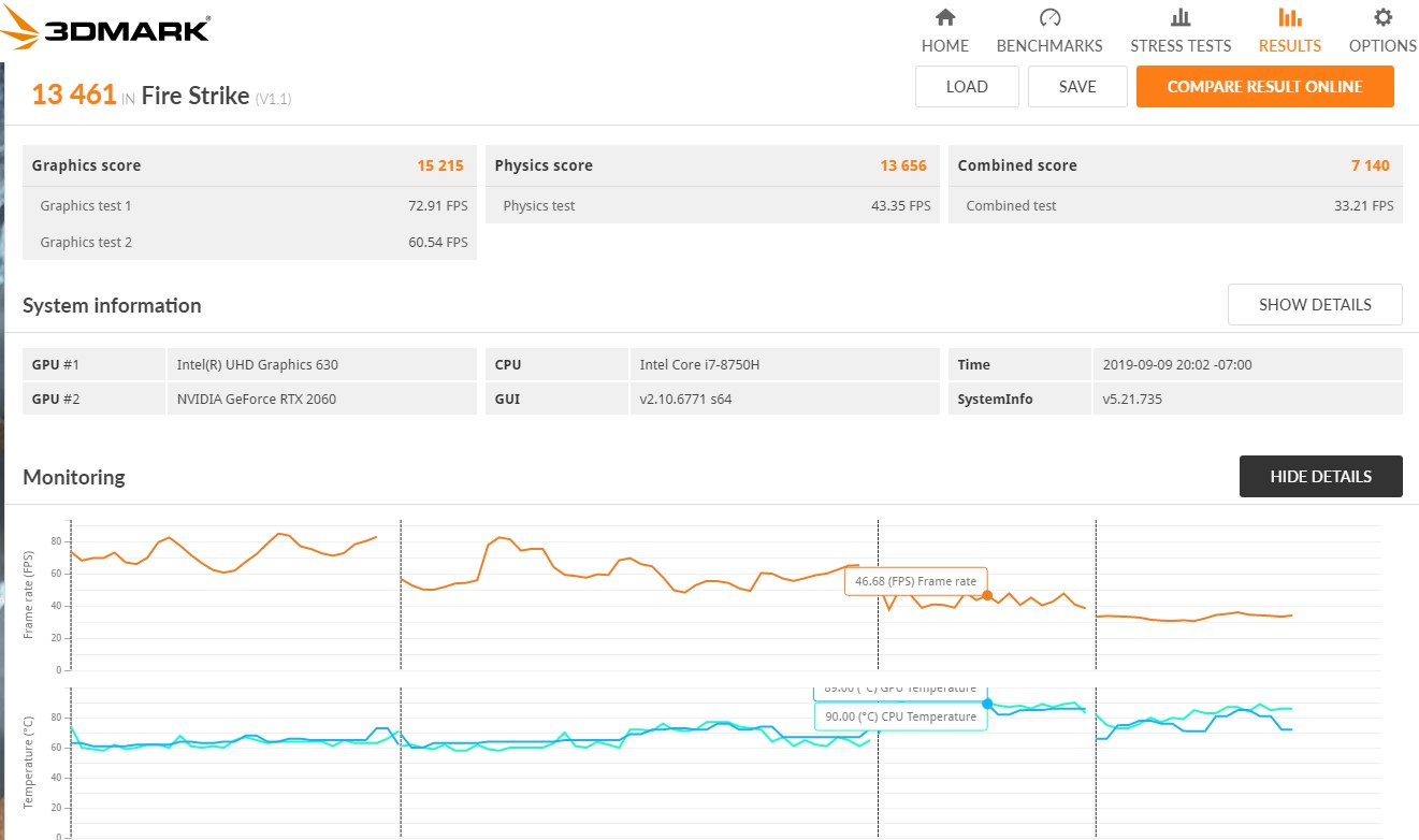

Now here is the same test run after I re-pasted:
Now pay close attention to where the CPU and GPU STARTED from. The darker blue line is the GPU. The CPU started the test right around 70c and the GPU started from around 65c I think. The highest temp that was achieved during the test was 90c and that was for 2-3 seconds and went back down. Most of the test the temps hovered around 75 or so while the other test AVERAGED around 95c. HUGE difference! Also the Firestrike score increased by 654 points from 12,807 to 13,461 without changing anything other than the thermal compound. No overclocking or anything.

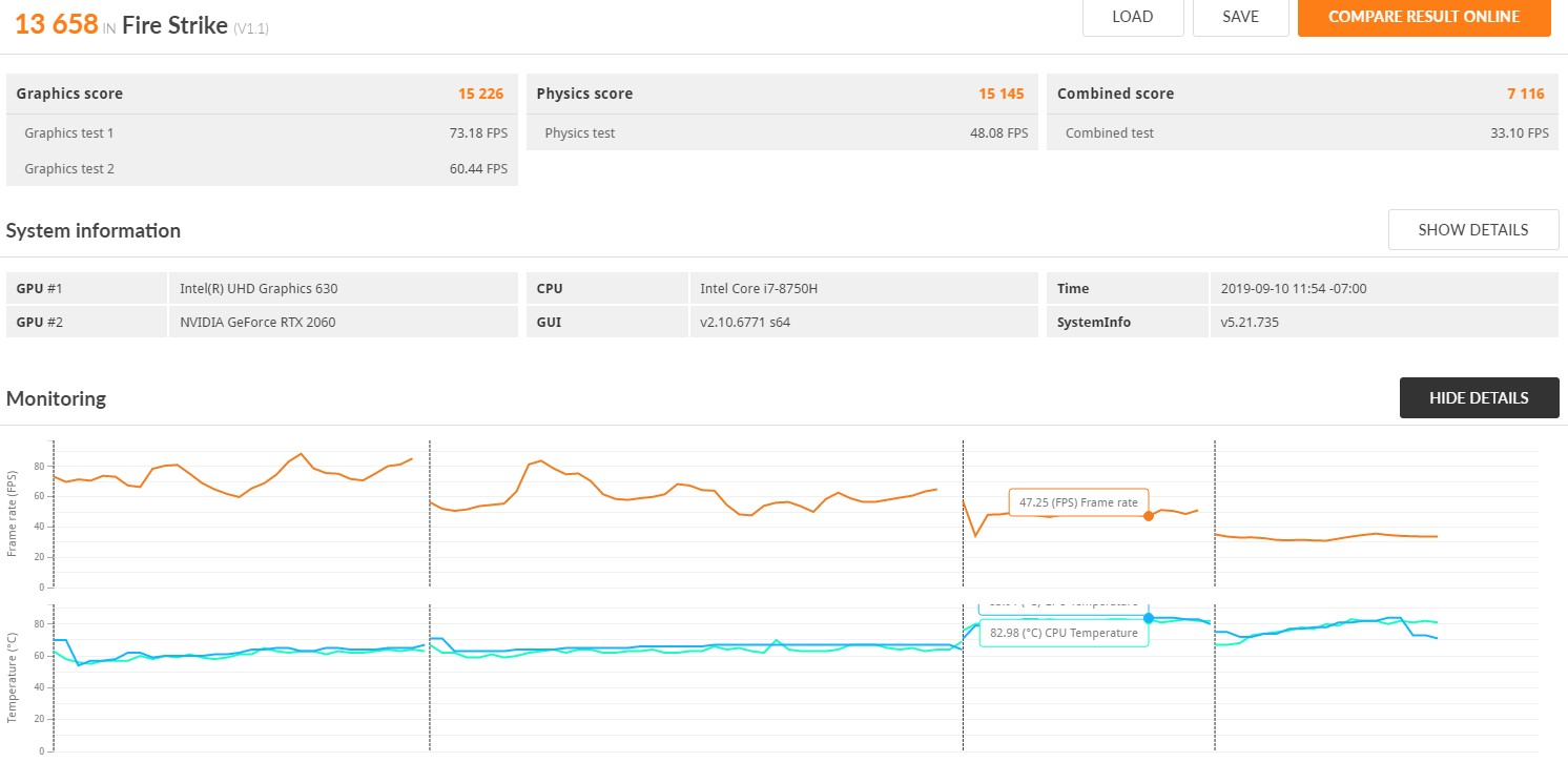

**UPDATE:** I have used Throttlestop to under-volt the CPU and my idle times are VASTLY improved as well as the overall temperatures. My Idle temperatures using Dell's "Quiet" profile is now between 50c and 55c. If I change the power profile to "Optimized" the idle temps hover around 45c - 50c. They also stay in the low 40s and mid to high 30s at times when the computer is just sitting there.
I also retested with Firestrike and the result is below:
This time the HIGHEST the temps ever got during testing was 83 degrees on the GPU and the CPU never went above that either. These are phenomenal results. And the Firestrike score went up a little bit too... from 13,461 to 13,658. I ran AIDA 64 Extreme for a couple minutes to test and the results are similarly astounding there... Before undervolting the Max temp reached 95 at times, but now after undervolting the temperature never reached 80c. Highest it got to was 79c.
